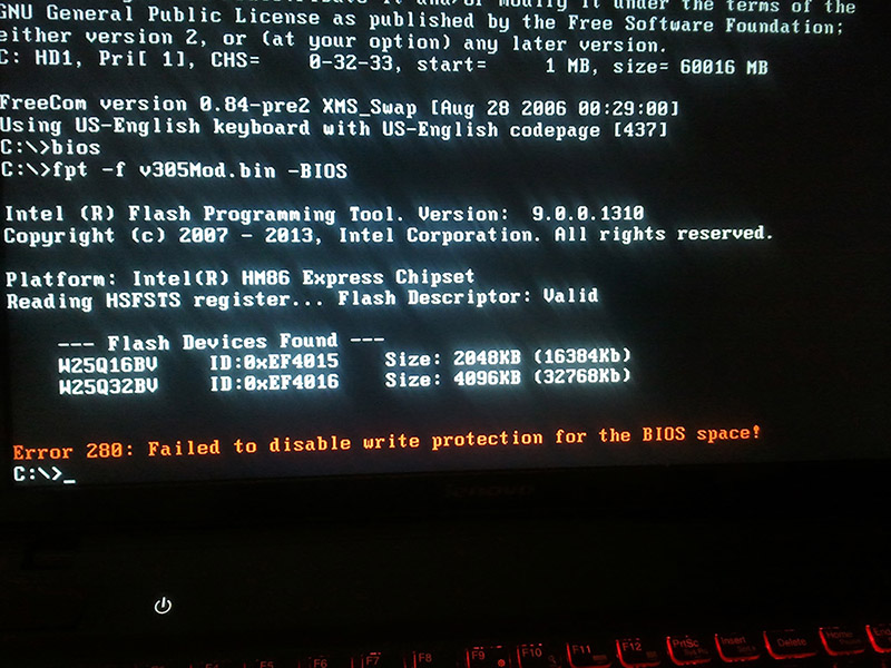

I finally successful make backup and format usb stick for DOS with rufus after more documentation in this theard.
Now I have a big problem, when boot for usb stick and type BIOS for flash bios I recived Error 280: Failed to disable write protection for the BIOS Space!
Why have his error?
Why have his error?
You can't flash from 3.05, you need to downgrade to 2.07 first, then you can go ahead and flash from 3.05. Read and follow the instructions carefully. Failure to do so may result in severe issues.

You can't flash from 3.05, you need t flaho downgrade to 2.07 first, then you can go ahead and flash from 3.05. Read and follow the instructions carefully. Failure to do so may result in severe issues.
Thanks svl7,
I successfully flash the bios, evrything is ok, the intel AC7260 is work installed but i have just 50-70/mbs in band 5 ghz with my router

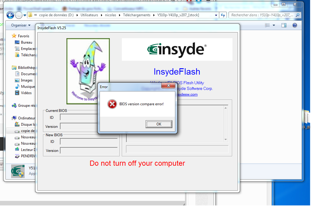

I decided to attempt this fix because my wireless card wasn't picking up my wireless router. So I slapped a new wireless card in there and it gave me the "Unsupported wireless card error" on boot. Now I'm on step 3 of the entire process but the InsydeFlash tool is telling me "BIOS version compare error!". Please help me figure this out as since I've upgrade to 3.05 my slave video card isn't working anymore.
Finally someone else!!!! This is the same error I ran into!
To solve it: Boot off your USB stick, and flash the 3.05 EC portion of the later steps. Then boot back in to windows and flash 2.07 BIOS. Then continue on with the 3.05 BIOS/EC flash steps.
I actually fixed this problem by going into the BIOS under Configuration and enabling BIOS Back Flash.
