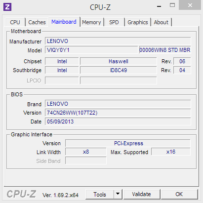

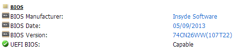

Ok, I check for my bios version....My y510p have the 3.7 version. Is it possible to unlock? Is strange that a notebook with those specs doesn't have a good bios. I can't custom anything!
Are you sure it's 3.7? You might have been looking at the rev. of the setup utility.
