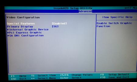

Does anyone know what the Advanced>Video Configuration>Special Features does?
I am wondering if it would be able to shut off the Nvidia card? I dont want to mess with it without asking someone first.
Another option potentially is to change the Primary Display from SG to IGPU? I wonder if that would do anything good or bad?
Any advice would be great, thanks!
If anyone is interested in knowing turning off the graphics switching and setting the primary device to igpu did nothing for the battery life, and other than making the Nvidia card unusable did nothing else either. Also darcinator the way I understand it by reading the forum here, since the Nvidia card is routed through the Intel card it doesn't work if you shut the Intel card and also serves to make the laptop screen not work.
