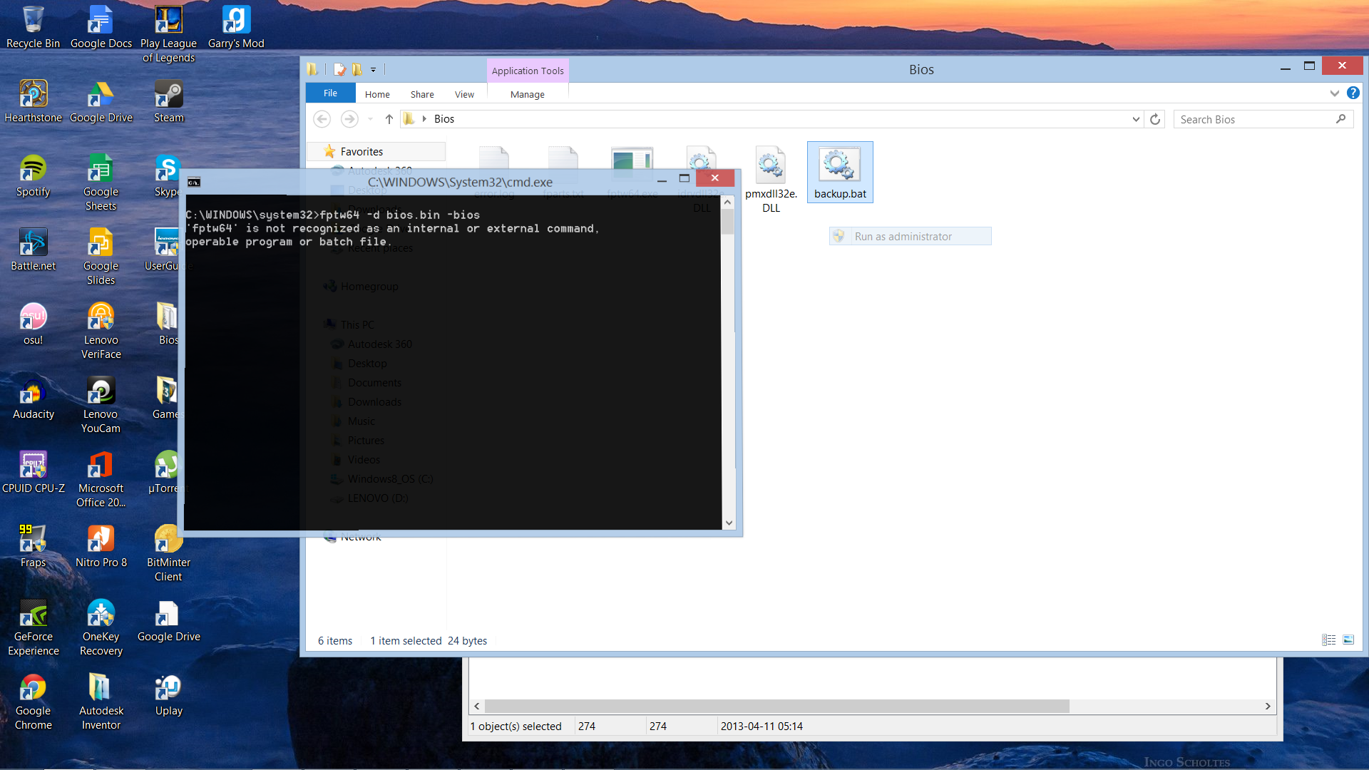

I like your explantion but it wont work for me. This is what is happening as i run backup.bat file from the archive. Please help me, I am trying to upgrade the wifi card. Thanks very much.
[ATTACH]9935[/ATTACH]
you are running fpt from system32 and i can see it's in a folder called bios if you put that bios folder in on the c: drive the command for getting to that folder would start with
CD C:\bios\ (enter)
and then run the script.
