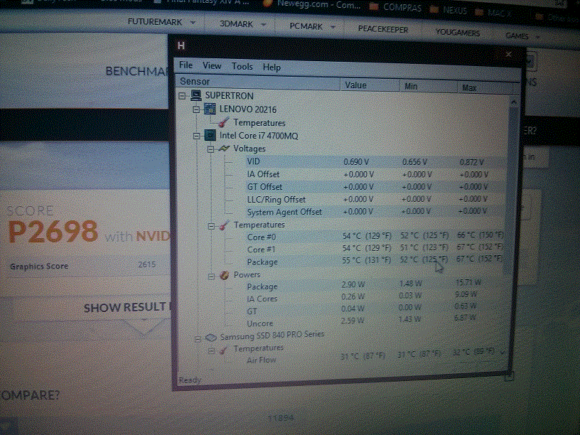

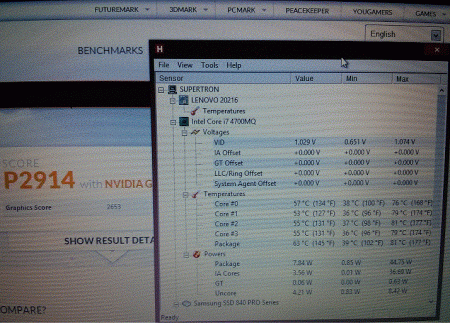

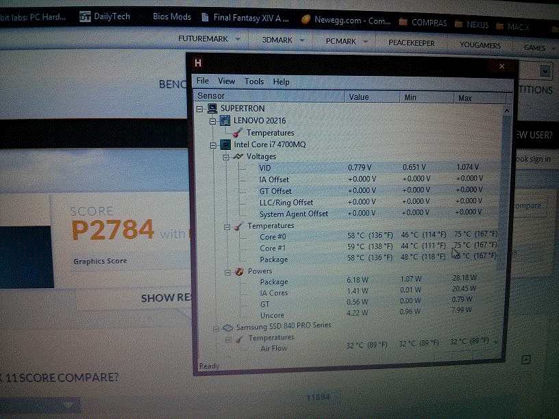

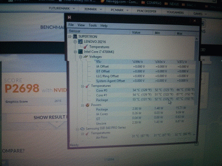

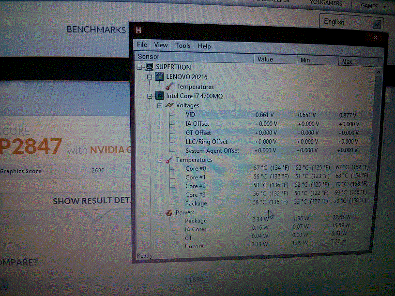

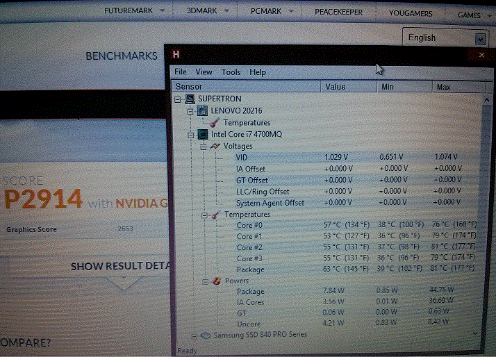

just want to share my story and experience so far maybe it can be usefull to someone
Ok so i recently found this lenovo Y410p brand new at a great price directly from lenovo so i started reading all reviews and forums i could find to see if it was a good buy and as i was saying all forums i found including this one and to be honest this is my favorite Thanks Svl17 and on the notebook i found this list was the mayor concern of issues and how i deal with it
1. touchpad sucks, its not that bad once you get used to it and when gaming i use a wireless mouse
2. Glossy screen which i countered by buying a 19 dollar screen protector on ebay thats non glossy
3. wireless issues, i had some but not much to hate my wireless card, maybe later ill plan to upgrade
4. Overheats quite alot,forums say 90celsius is its average temps and this is for me the most important issue since it can kill the computer over time and this next list is what i did right out of the box not even turning it on
1 changed thermalpastes for liquid pro and chipset for metalpad from coollaboratory
2 changed my hard drive to a Samsung 840pro to reduce any extra heat and make it faster
3. Upgraded to Gskill 1866mhz DDR3L and works out of the box
i found myself with 80 81 degrees celsius on games like borderlands 2 and final fantasy 14 after at leas 2 hours of gaming
I found this forum unlocked my bios and to not make this story longer this are my results with 3dmark11 and did not mess with the GPU only what mods the unlocked bios brings (note: actual gaming makes temps at least 2 to 3 degrees higher) i personally stayed with the last option as it doesnt slow games down and temps are really good
i know i made a core i3 out of a core i7 but i prefer a long lasting gaming rig than 5frames per second and 6 months later it dies... i just remember those awful HP that came out a few years ago that everyone hated
1> everything on 4cores 8 threads 4700mq turbo enabled
2> 4 cores 4 Threads and turbo off
3> 2 cores 4 threads turbo ON
4> 2 cores 4 threads Turbo OFF and this is my actual state:star:
