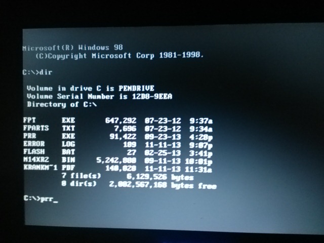

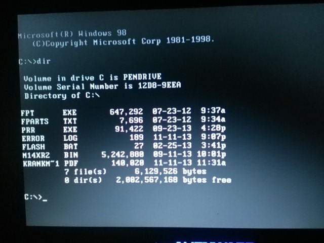

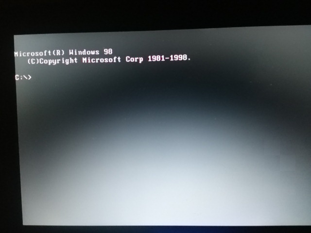

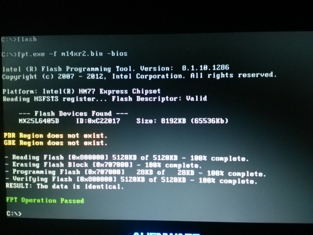

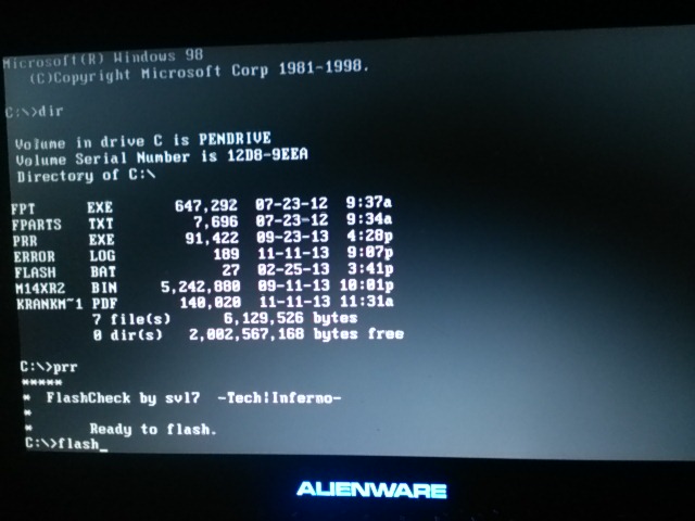

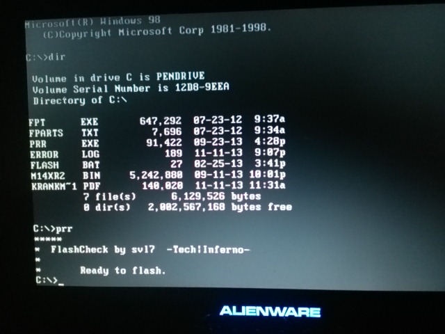

FollowThrough Posted November 9, 2013 Share Posted November 9, 2013 Hi ! Iam new to the Forum and want to thank you for your great work ! But i have problems to Flash it ! I have flashed the Bios following the instructions in this Thread and everything looks good but when i go in to the bios menu its still locked ! When Flashing the Menu says GBE Region not set and PDR Region not set if i remember correctly! Maybe this is the Reason ?! Please Help me ! Thanks Quote Link to comment Share on other sites More sharing options...
Eats7 Posted November 10, 2013 Author Share Posted November 10, 2013 Hmm I am not too sure. Ask @svl7 as this is all of his work.. he might know. Quote Link to comment Share on other sites More sharing options...
FollowThrough Posted November 10, 2013 Share Posted November 10, 2013 Hmm I am not too sure. Ask @svl7 as this is all of his work.. he might know.I will. Thanks for your answer . Quote Link to comment Share on other sites More sharing options...
svl7 Posted November 10, 2013 Share Posted November 10, 2013 Hi ! Iam new to the Forum and want to thank you for your great work ! But i have problems to Flash it ! I have flashed the Bios following the instructions in this Thread and everything looks good but when i go in to the bios menu its still locked ! When Flashing the Menu says GBE Region not set and PDR Region not set if i remember correctly! Maybe this is the Reason ?! If it is still locked then you probably didn't complete the flash.GBE and PDR Region do not exist, that message doesn't matter. Quote Link to comment Share on other sites More sharing options...
FollowThrough Posted November 11, 2013 Share Posted November 11, 2013 Ok ! I post what i did ! Here a few Pictures ! Plz Help what did i forget ? - - - Updated - - - Quote Link to comment Share on other sites More sharing options...
svl7 Posted November 11, 2013 Share Posted November 11, 2013 Are you sure you used the file provided in the first post? It works for the other users 1 Quote Link to comment Share on other sites More sharing options...
Eats7 Posted November 13, 2013 Author Share Posted November 13, 2013 make sure you are on a13 stock before you do this. also, if i remember correctly thats what mind said as well about the xxxxxx does not exist. its not an error its supposed to say that. it should be unlocked after that. Quote Link to comment Share on other sites More sharing options...
