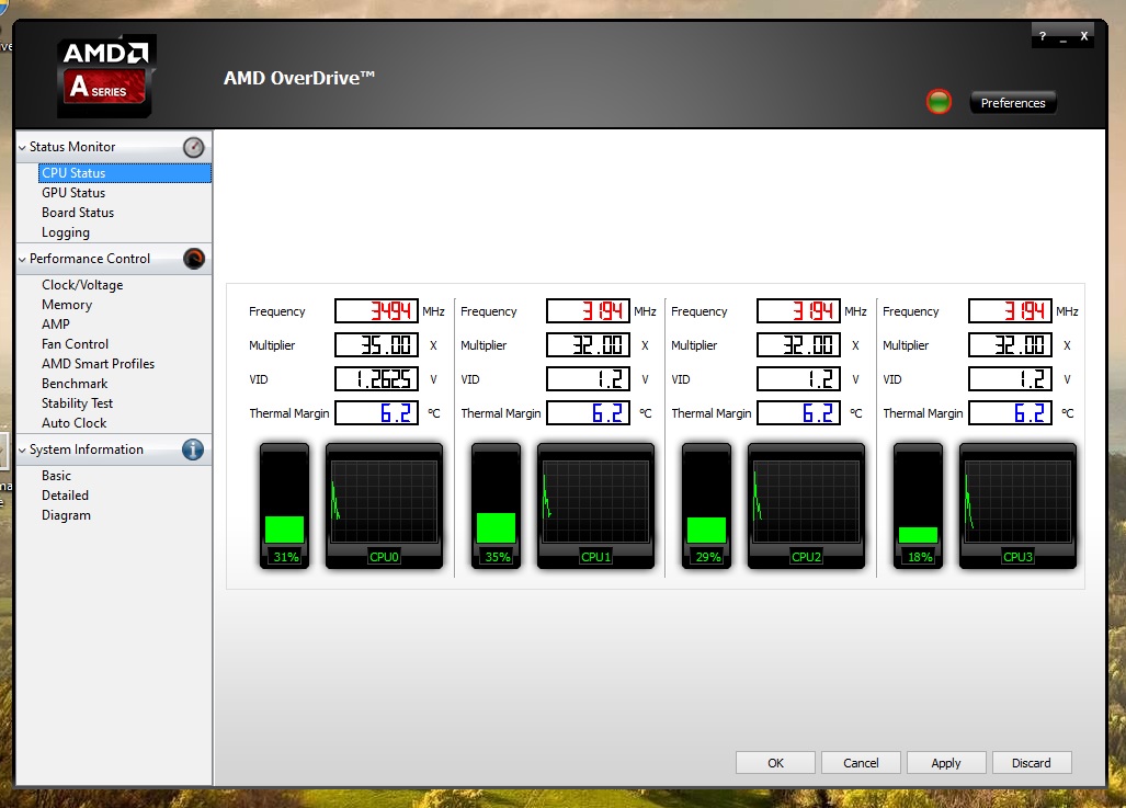

methandmind Posted March 11, 2015 Share Posted March 11, 2015 Hey, it's a while what I have my gx70 with A10-5750M, at first I thought that I have wrong drivers for GPU, then bios, now I relized that the problem what I was experiencing is coming from CPU. 1 Quote Link to comment Share on other sites More sharing options...
methandmind Posted March 14, 2015 Share Posted March 14, 2015 Does this overlock looks like this? Quote Link to comment Share on other sites More sharing options...
