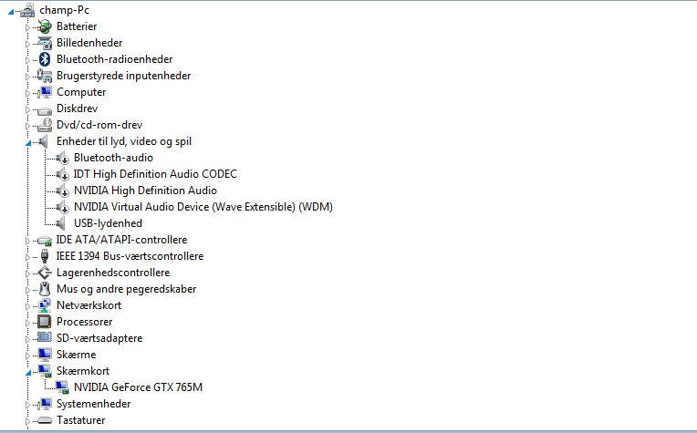

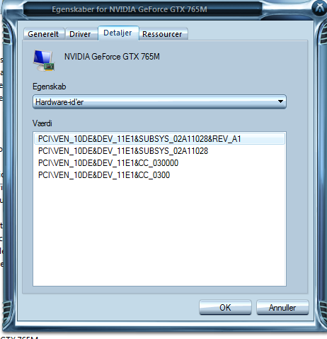

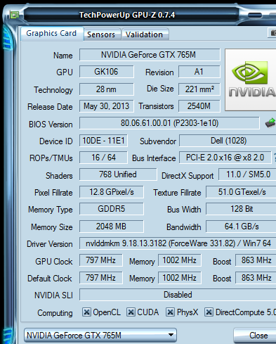

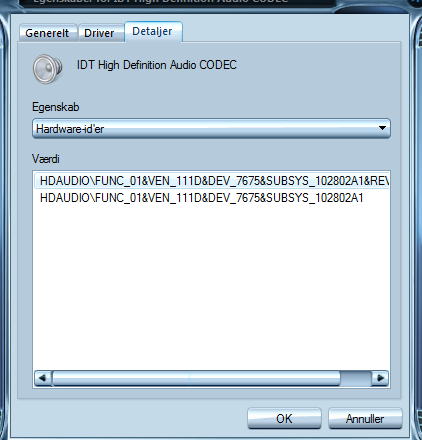

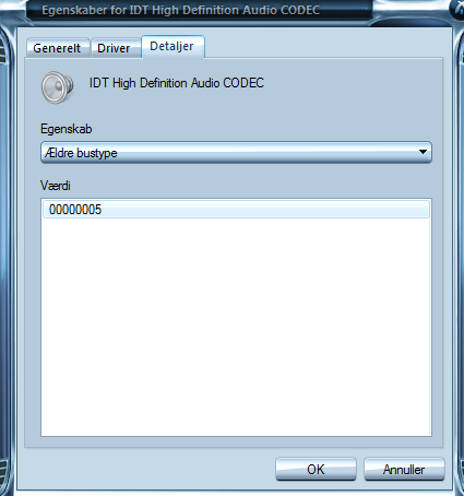

champeto Posted December 5, 2013 Share Posted December 5, 2013 I had same prob. i got a normal start when i disable IDT Audio (Integrated Device Technology) try it disable it in safe mode and reboot i belive it where becourse the new graphic card use the same I/O bus adr. as the onbord sound.Im now running my sound on a speaker set where there is build in sound card. Quote Link to comment Share on other sites More sharing options...
J95 Posted December 5, 2013 Share Posted December 5, 2013 I had same prob. i got a normal start when i disable IDT Audio (Integrated Device Technology) try it disable it in safe mode and reboot i belive it where becourse the new graphic card use the same I/O bus adr. as the onbord sound.Im now running my sound on a speaker set where there is build in sound card.Please post a screenshot -> GPU-Z / Device manager >Display Adapters>Details>Hardware Ids. Quote Link to comment Share on other sites More sharing options...
champeto Posted December 6, 2013 Share Posted December 6, 2013 1 Quote Link to comment Share on other sites More sharing options...
J95 Posted December 6, 2013 Share Posted December 6, 2013 Yeah the 765m GK106, still not a GK104/780m. Quote Link to comment Share on other sites More sharing options...
champeto Posted December 6, 2013 Share Posted December 6, 2013 I know but maybe it whoud be the same prob. Quote Link to comment Share on other sites More sharing options...
J95 Posted December 7, 2013 Share Posted December 7, 2013 Disabling IDT/AZALIA, tested already... Quote Link to comment Share on other sites More sharing options...

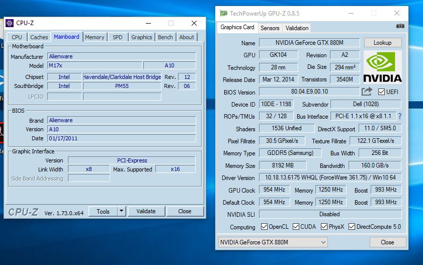

darky83 Posted January 27, 2016 Share Posted January 27, 2016 (edited) 780m in Alienware m17x R2 works perfectly! I have upgraded 3x m17x r2's with the 780m in the last years and never had a problem. I installed a 880m yesterday and it works like dream! If you have any Question how to do it, feel free to ask. Best Regards Edited January 27, 2016 by darky83 Quote Link to comment Share on other sites More sharing options...
@t0mX Posted July 12, 2021 Share Posted July 12, 2021 (edited) On 1/27/2016 at 10:21 PM, darky83 said: 780m in Alienware m17x R2 works perfectly! I have upgraded 3x m17x r2's with the 780m in the last years and never had a problem. I installed a 880m yesterday and it works like dream! If you have any Question how to do it, feel free to ask. Best Regards So we assumed this was a fake @flingin @tucksha ? (Hehe 5 years later lol) Edited July 12, 2021 by @t0mX Quote Link to comment Share on other sites More sharing options...
