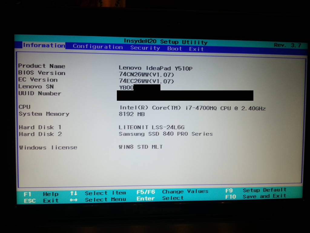

Thanks, I don't really need any more of those ;) The mod is on, what I'm looking for is some images of the setup menu.

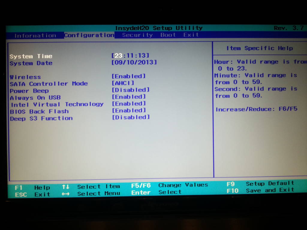

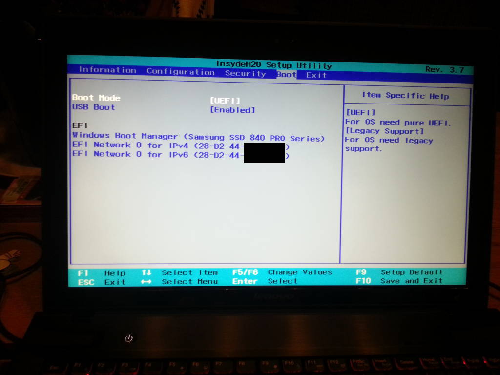

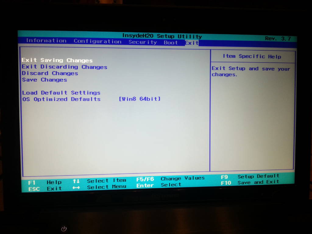

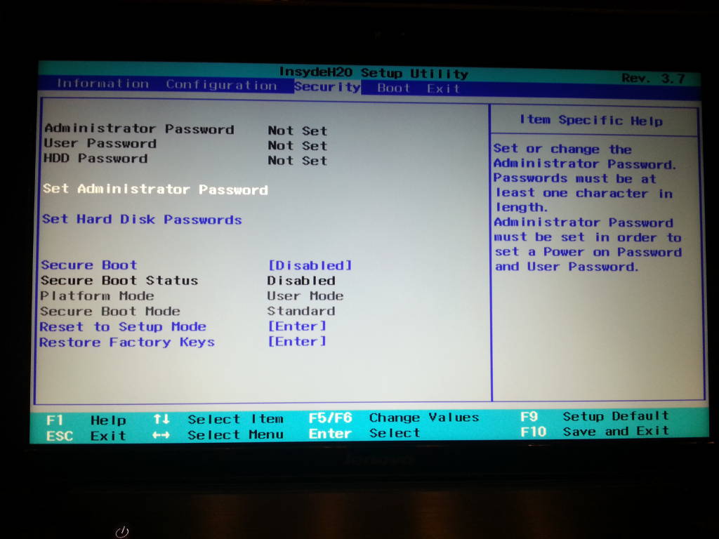

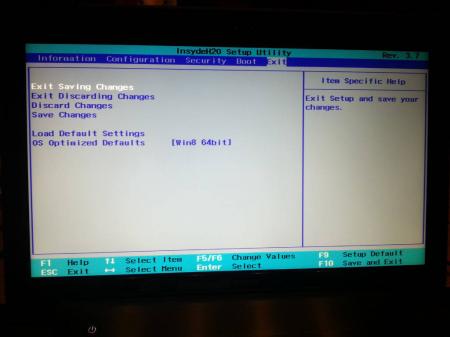

Do you mean screenshots (well, photos I guess) from the BIOS setup menu? Anything in particular?
Yes, photos. I want to know whether everything that should be there is available.
I have a Y510P with the SLI 750M cards. I am willing to help provide you with anything you need to make the modified VBIOS for it. Thank you so much for doing this for all of us!
Here you go. Hope you don't mind the masking of SN, UUID and MAC address.

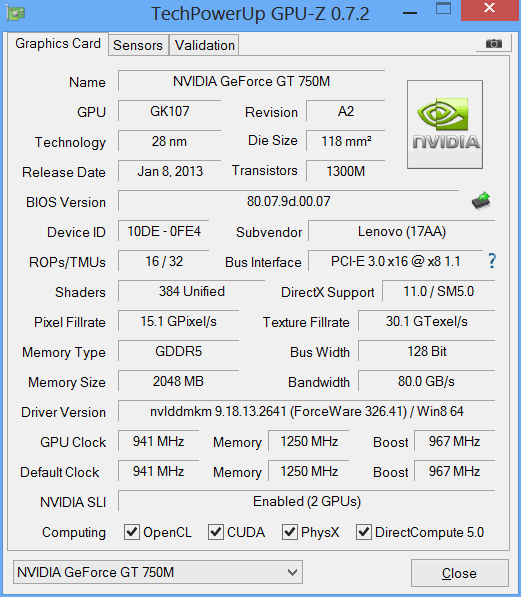

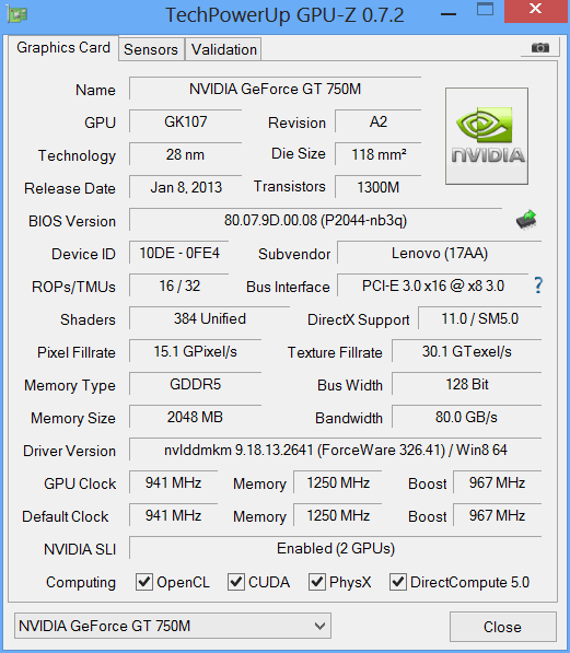

Since I have the dual GPUs, am I able to install the modded BIOS and VBIOS? Will that mean just the ultrabay GPU does not work correctly or will it still work fine, just not be customizable?
Sure it will work, I also prepared a vbios for the ultrabay GPU, but I'd still like to get a copy of the ultrabay vbios since it seems to be a slightly different version (though I think I know what the change in there is...).
Could you give me a short, quick tutorial on how to dump the VBIOS from the ultrabay GPU? Thanks!

I'm confused... I have the SLI 750M cards. Can I just follow your instructions like you gave the others and have no problems? How can I make sure the ultrabay card will be flashed too?
You need to flash the ultrabay separately. I already prepared that file, but I'm kinda still waiting on someone providing me the real ultrabay vbios as it seems to be a bit newer.
