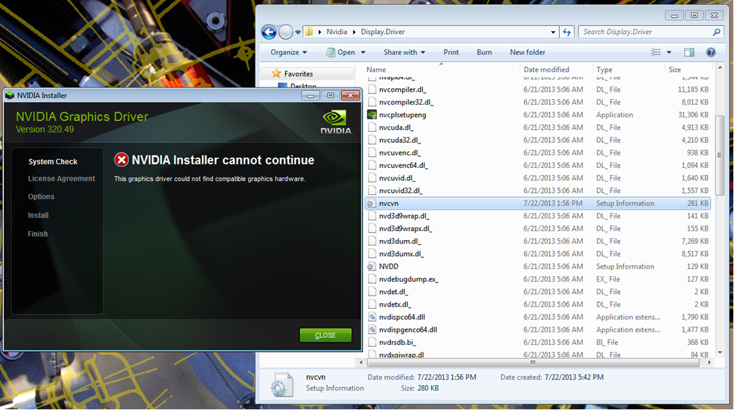

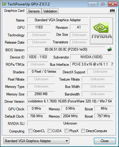

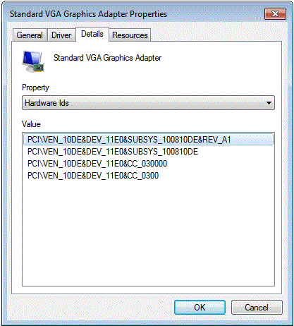

Hey Xonar,
I bit the bullet and bought a GTX770m for the MS-16F2, although I'm having installation problems. The computer won't detect the card (Nvidia drivers, GPU-z), although I can see that Nvidia autodetect is identifying the new card. Any idea on how to troubleshoot this?
Thanks
Well, the guy I bought it from was largely selling these cards for Alienware rigs so I suppose the vBios installed is configured for an Alienware setup. Do you know of any souce/place I can get appropriate GTX770 vBios? I've been talking with svl7 and he's been focusing on writing a config file to force install the drivers, although that hasn't worked yet.
When moving from a 570m to a 770m will a heatsink modification be needed? I can't really make it out from compairing the two cards =/
I think 770m uses same PCB layout as 680/780m. So no. Unless you want to dremel away the heatsink.

hello I have a msi gt780dx and I am wondering if this gpu will work in my rig New NVIDIA GeForce GTX 770M 3GB DDR5 MXM 3 0 Type B for Clevo Alienware MSI | eBay and what I will have to do to get it to work. Or if there is a better nvidia gpu option.
Yes it will work, I bought the same one from the same seller but sent from the uk to avoid customs and tax, you'll need a modified .inf to install the display drivers.
