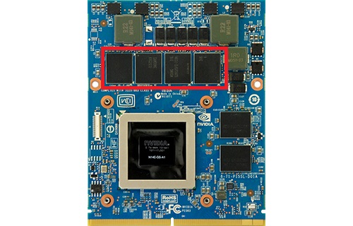

Moderator BAKED Posted January 18, 2014 Moderator Share Posted January 18, 2014 Ok, so my new 770m should be arriving tomorrow. As above, I've previously had a 570m. Other than doing a clean Nvidia driver install, what else do I need to do following putting the card in? You need to rearrange the thermal pads to fit the 770m's slightly different layout, and if they are 0.5mm which is optimal you'll need to put either a 1mm or 2x0.5mm pads on top of each other on the 4 VRAM's here Do you have a modded .inf? 2 Quote Link to comment Share on other sites More sharing options...
Herrick Posted January 18, 2014 Share Posted January 18, 2014 I've taken out my micrometer and measured the thickness of that area on both cards and they're exactly the same... Are you sure that's the offending area? I do not... where do I get that and what do I do with that? xD EDIT] Ok! So graphics card installed, it posts, I get through the boot screen, the Windows Starting screen appears, then I get a blue-screen which disappears too soon for me to read, then it cycles to boot again, and then asks how I want to start Windows. I'm assuming that THIS is a bios thing, so I'm going to flash the bios mentioned earlier and see if that works. EDIT2] Ok, so tried to flash bios but apparently it is not compatible with the existing bios and will not flash. The files used were: http://forum.techinferno.com/msi/1839-msi-g-series-unlocked-bios.html (MSI MS-1761 Unlocked.zip) I should point out again that I have a whitebook - http://www.msiwhitebook.com/product_spec.asp?model=MS-1761-ID1 EDIT3] Ok, so I tried flashing the bios again with the update.bat however added /x (doesn't check BIOS ID) and it flashed fine, in that it didn't brick my system, however the problem of the Starting Windows > Blue screen error > cycle reboot still persists. Windows suggests Startup Repair, however going through with this doesn't change anything. :/ EDIT4] SOLUTION FOUND - when booting, DEL menu, then Advanced Settings, then changed SATA mode from RAID to AHCI. Done! Quote Link to comment Share on other sites More sharing options...
Herrick Posted January 18, 2014 Share Posted January 18, 2014 You need to rearrange the thermal pads to fit the 770m's slightly different layout, and if they are 0.5mm which is optimal you'll need to put either a 1mm or 2x0.5mm pads on top of each other on the 4 VRAM's here [ATTACH]10292[/ATTACH] Do you have a modded .inf? No I don't, will try installing drivers with existing inf, if that fails will change it. (The link is on the prev. page, right?) EDIT] Driver install failed, as expected. Looked for INF files specific to my laptop - couldn't find them, so flashed VBIOS to the one used by BigKid so as to avoid the whole INF swapping in the future: it worked! Driver update successful and now I have the ability to OC, though since I've only just gotten my lappy working again I'll probably give that a miss for a few weeks at least! Thanks for all your help guys! Quote Link to comment Share on other sites More sharing options...
