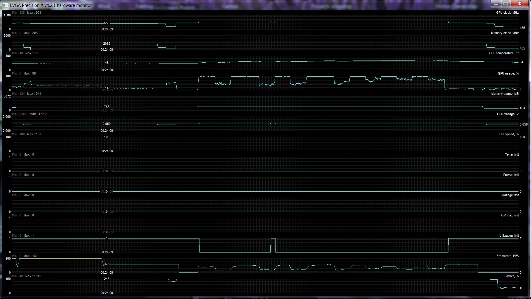

bondjame12 Posted January 1, 2014 Author Share Posted January 1, 2014 ligrew, I have a MS-1761 model MSI (gt780dx), i have put a clevo GTX770M in it also. I also have trouble keeping the GPU usage high. Framerates will drop then come back up. I haven't tracked down the problem yet. Some possible causes I'm looking into: CPU too slow, VBIOS issue I am leaning towards my CPU, mostly since benchmarks like EVGA OC Scanner don't show this behavior and hold the GPU at 98% until the power limit is hit. This is what it looks like while playing BF4: Quote Link to comment Share on other sites More sharing options...
ligrew Posted January 1, 2014 Share Posted January 1, 2014 @bondjame12 My CPU is i7 2670QM. Don't know if this could be a cause... What's the most funny? Playing Tomb Raider 2013 the card has no FPS drops at all with ultra settings EDIT: What is your: mobo BIOS / drivers? Quote Link to comment Share on other sites More sharing options...
