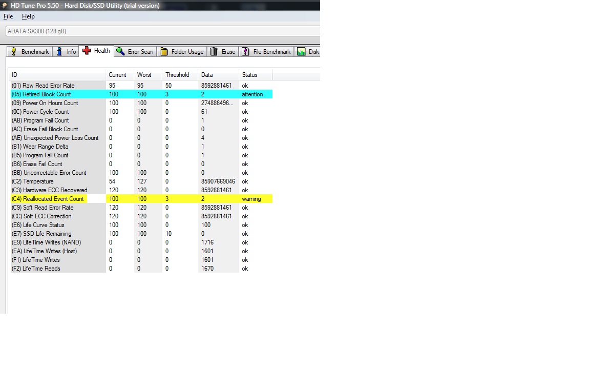

Here's what's up. My second ssd is dying too. post-12750-14494995546838_thumb.jpg
The thing is that now S.M.A.R.T is reporting a temperature of 61 C and gives me warnings. Is it possible that the placement of the mSata slot is actually killing my ssd's. In the m14xr2 its right under the battery. Any of the users with mSata SSD's - what are your temps?

One thing bugs me though - I got two consequitive ssd failures which happened pretty much the same way. For now I returned my second ssd and got my money back qithout much hustle. I also observed quite high temps (>60C) on the second ssd via hdd tune, if the sensors were reading right of course. This makes me think that there is a small possibility that my MB is faulty and the ssd's get overvolted. Any way to check voltage on the msata port?
Consumer-grade SSDs are typically rated for up to 70C. Consumer-grade SSDs often don't have reliable thermal sensors. And as noted, Adata isn't the most reliable brand on the market. Or the second. Or third. Or fourth for that matter. Still, if you're concerned and the M14x is under warranty then there's no harm in contacting Dell about it.
