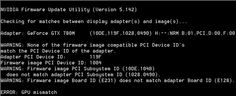

i'm afraid to flash the VBIOS. do you really think that it will help me ?
IRQ is 7 for the GTX 780M. is it possible to change it ?
well
i can't flash the vbios.
GPU mismatch
i think that the solution is to change the IRQ of the nvidia card.

1004 is the GTX 780. You have a 780m, you used the wrong vbios.
