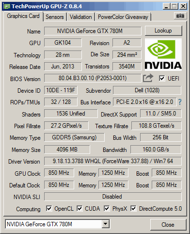

mayyas Posted July 2, 2015 Share Posted July 2, 2015 hi guys i did all the process of installing 780m gtx into my alienware m17xR3 i installed 340.52 + modded inf The problem is the games are very slow, any idea? here is my becnhmark is it correct? http://www.3dmark.com/3dm/7607615 Quote Link to comment Share on other sites More sharing options...
