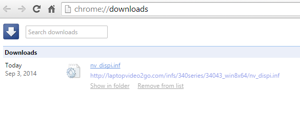

J95 Posted September 2, 2014 Share Posted September 2, 2014 @arakosab edit only the "NTamd64 Section" that corresponds to your OS version and (5) "NVIDIA Windows (64 bit) Driver Library Installation Disk 1" or use notepad CTRL+H method -> AW17 Id 05AE replace with your own -> 0490 (copying NVCUVENC DLLs won't work) http://forum.techinferno.com/nvidia/5249-%5Bguide%5D-modding-nvidia-oem-inf-files.htmlPCI\VEN_10DE&DEV_119F&SUBSYS_0490102810DE&DEV = Nvidia, 119F = GTX 780M, 0490 = M17xR3, 1028 = Dell [Manufacturer]%NVIDIA_A% = NVIDIA_SetA_Devices,NTamd64.6.0,NTamd64.6.1,NTamd64.6.2,NTamd64.6.3 (Windows versions 64-bit)NTamd64.6.0 VistaNTamd64.6.1 Win7NTamd64.6.2 Win8NTamd64.6.3 Win8.11[NVIDIA_SetA_Devices.NTamd64.6.0] Vista%NVIDIA_DEV.0407.01F1.1028% = Section004, PCI\VEN_10DE&DEV_0407&SUBSYS_01F11028 %NVIDIA_DEV.0407.01F2.1028% = Section004, PCI\VEN_10DE&DEV_0407&SUBSYS_01F21028 %NVIDIA_DEV.0407.0228.1028% = Section004, PCI\VEN_10DE&DEV_0407&SUBSYS_02281028 -------------------------------------------------------------------------------------------------------------------------------------2[NVIDIA_SetA_Devices.NTamd64.6.1] Win7%NVIDIA_DEV.0407.019C.1028% = Section001, PCI\VEN_10DE&DEV_0407&SUBSYS_019C1028 %NVIDIA_DEV.0407.01F1.1028% = Section001, PCI\VEN_10DE&DEV_0407&SUBSYS_01F11028 %NVIDIA_DEV.0407.01F2.1028% = Section001, PCI\VEN_10DE&DEV_0407&SUBSYS_01F21028-------------------------------------------------------------------------------------------------------------------------------------3[NVIDIA_SetA_Devices.NTamd64.6.2] Win8%NVIDIA_DEV.0407.019C.1028% = Section002, PCI\VEN_10DE&DEV_0407&SUBSYS_019C1028 %NVIDIA_DEV.0407.01F1.1028% = Section002, PCI\VEN_10DE&DEV_0407&SUBSYS_01F11028 %NVIDIA_DEV.0407.01F2.1028% = Section002, PCI\VEN_10DE&DEV_0407&SUBSYS_01F21028-------------------------------------------------------------------------------------------------------------------------------------4[NVIDIA_SetA_Devices.NTamd64.6.3] Win8.1%NVIDIA_DEV.0407.019C.1028% = Section003, PCI\VEN_10DE&DEV_0407&SUBSYS_019C1028 %NVIDIA_DEV.0407.01F1.1028% = Section003, PCI\VEN_10DE&DEV_0407&SUBSYS_01F11028 %NVIDIA_DEV.0407.01F2.1028% = Section003, PCI\VEN_10DE&DEV_0407&SUBSYS_01F21028 -------------------------------------------------------------------------------------------------------------------------------------5[strings]DiskID1 = "NVIDIA Windows (64 bit) Driver Library Installation Disk 1"NVIDIA = "NVIDIA"NVIDIA_A = "NVIDIA"NVIDIA_DEV.0407.019C.1028 = "NVIDIA GeForce 8600M GT "NVIDIA_DEV.0407.01F1.1028 = "NVIDIA GeForce 8600M GT"NVIDIA_DEV.0407.01F2.1028 = "NVIDIA GeForce 8600M GT "Does the graphics card show up in Device Manager before you try & install the graphics driver? Are there any warnings in Device Manager associated with it? (If you don't know how to find Device Manager, just type that into the search bar of the start button in Windows 7). I think it should say Standard VGA or something - this means that Windows has installed it's generic drivers to the card. I would wager that you're having a problem with the inf file that's preventing your install. Rather than modding your own, use Firefox (the other browsers won't work for this) to download/save the modified inf file from this popular site that I've used for getting modified inf's in the past, this is a direct link to the inf file you should try to use (it will look like a page of text, you want to 'Save As' in your browser in order to download it and have the inf file created: http://laptopvideo2go.com/infs/340series/34052_win8x64/nv_dispwi.infPlace that inf in the relevant folder and run the setup program & it should install. (Check out my Device Manager questions first though).Wrong INF. nv_dispwi.inf/Quadro, nv_dispi.inf/GeForce is the proper one.Firefox is not required for this. Open xxxxx.txt with notepad -> File -> "Save As" -> xxxxx.inf 1 Quote Link to comment Share on other sites More sharing options...
Robbo Posted September 3, 2014 Share Posted September 3, 2014 @arakosab edit only the "NTamd64 Section" that corresponds to your OS version and (5) "NVIDIA Windows (64 bit) Driver Library Installation Disk 1" or use notepad CTRL+H method -> AW17 Id 05AE replace with your own -> 0490 (copying NVCUVENC DLLs won't work) http://forum.techinferno.com/nvidia/5249-%5Bguide%5D-modding-nvidia-oem-inf-files.htmlPCI\VEN_10DE&DEV_119F&SUBSYS_0490102810DE&DEV = Nvidia, 119F = GTX 780M, 0490 = M17xR3, 1028 = Dell Wrong INF. nv_dispwi.inf/Quadro, nv_dispi.inf/GeForce is the proper one.Firefox is not required for this. Open xxxxx.txt with notepad -> File -> "Save As" -> xxxxx.infThanks, looks like laptopvideo2go linked the wrong inf to that driver then, here's a link to an inf from the 340.43 driver, which should work with the latest NVidia driver:http://laptopvideo2go.com/infs/340series/34043_win8x64/nv_dispi.infYes, you don't HAVE to use Firefox, but Firefox will save it using the correct extensions without you having to edit anything in the file name - so is more fool proof, and a quicker simpler process than yours listed (assuming the person has Firefox of course!). Quote Link to comment Share on other sites More sharing options...
J95 Posted September 3, 2014 Share Posted September 3, 2014 I meant installing firefox, chrome works fine... Quote Link to comment Share on other sites More sharing options...
Robbo Posted September 3, 2014 Share Posted September 3, 2014 [ATTACH=CONFIG]12393[/ATTACH]I meant installing firefox, chrome works fine...Nope, didn't work that way for me when I tried it months ago, and didn't work that way for me just now, so can assume it wouldn't work for some other people too - hence the Firefox recommendation. But who cares, it's an irrelevantly small point really! Quote Link to comment Share on other sites More sharing options...
