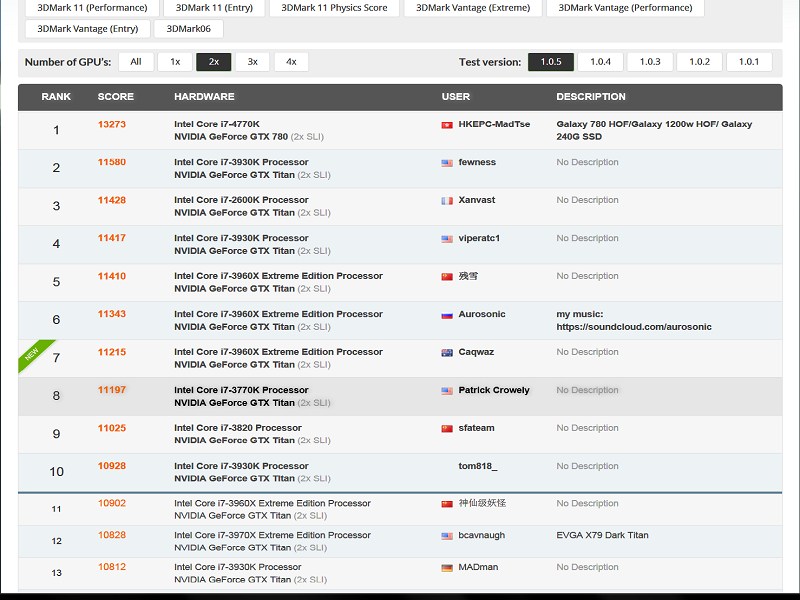

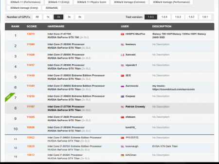

caqwaz Posted September 30, 2013 Share Posted September 30, 2013 hi would just like to thank @svl7 again and would like to show him a screenshot of my lastest 3dmark scores. thanks again Svl Quote Link to comment Share on other sites More sharing options...
