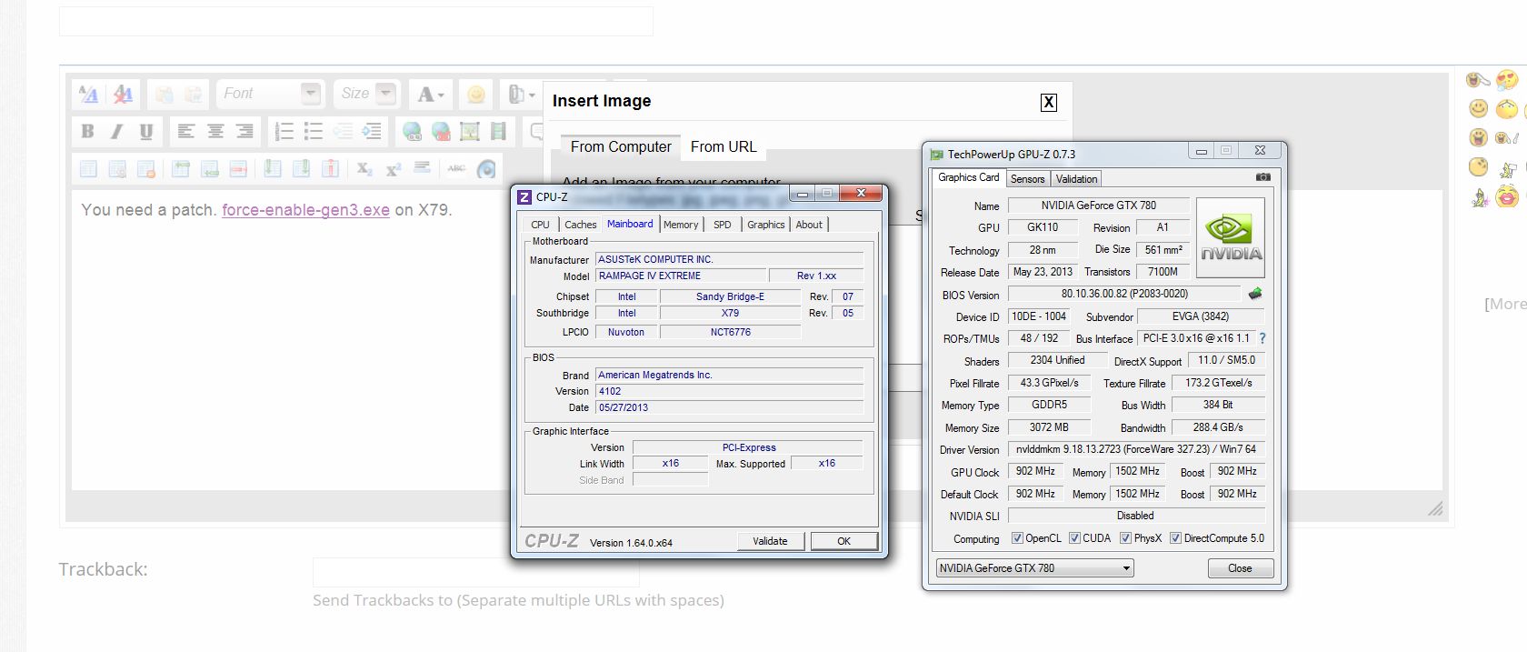

using a 3960X 4.5G (occasionally to 5.3G for benching and some game) on ASUS ROG R4E, since the SNB-E don't support PCI-E 3.0, it cause many compatibility problems with the new generation PCI-E 3.0 VGA cards. a trick to solve the problem is to set all the PCI-E lane from PCI-E 3.0 to PCI-E 2.0 in BIOS configuration. that will solve the occasionally happening "black screen in boot process" . hope that will help you guys
