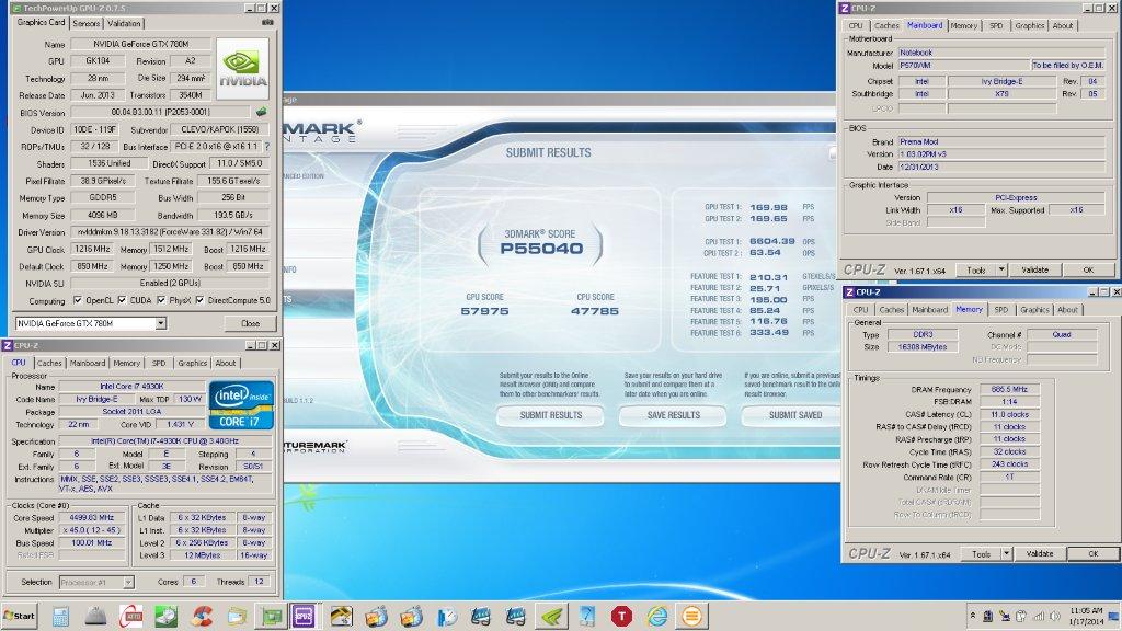

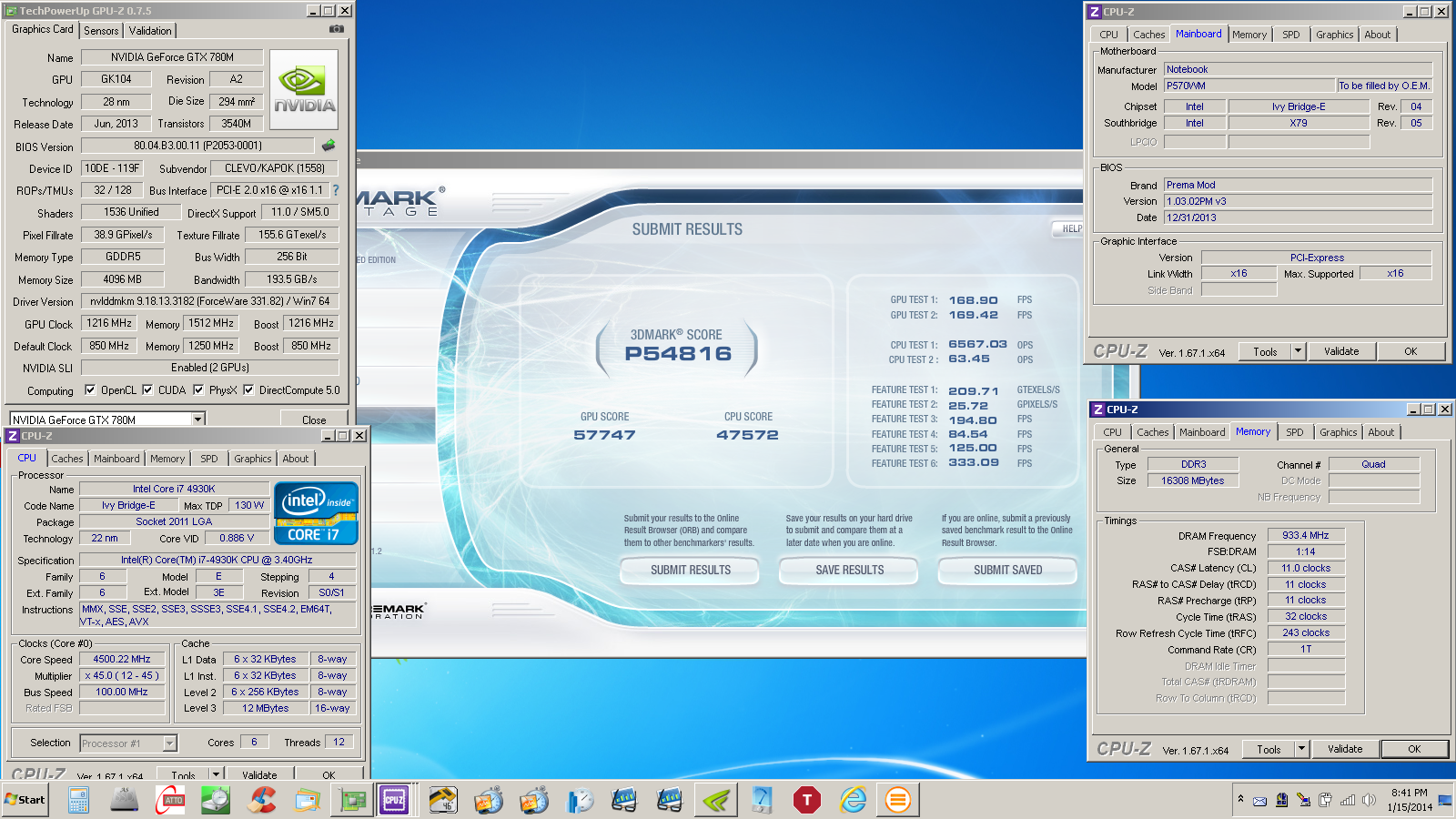

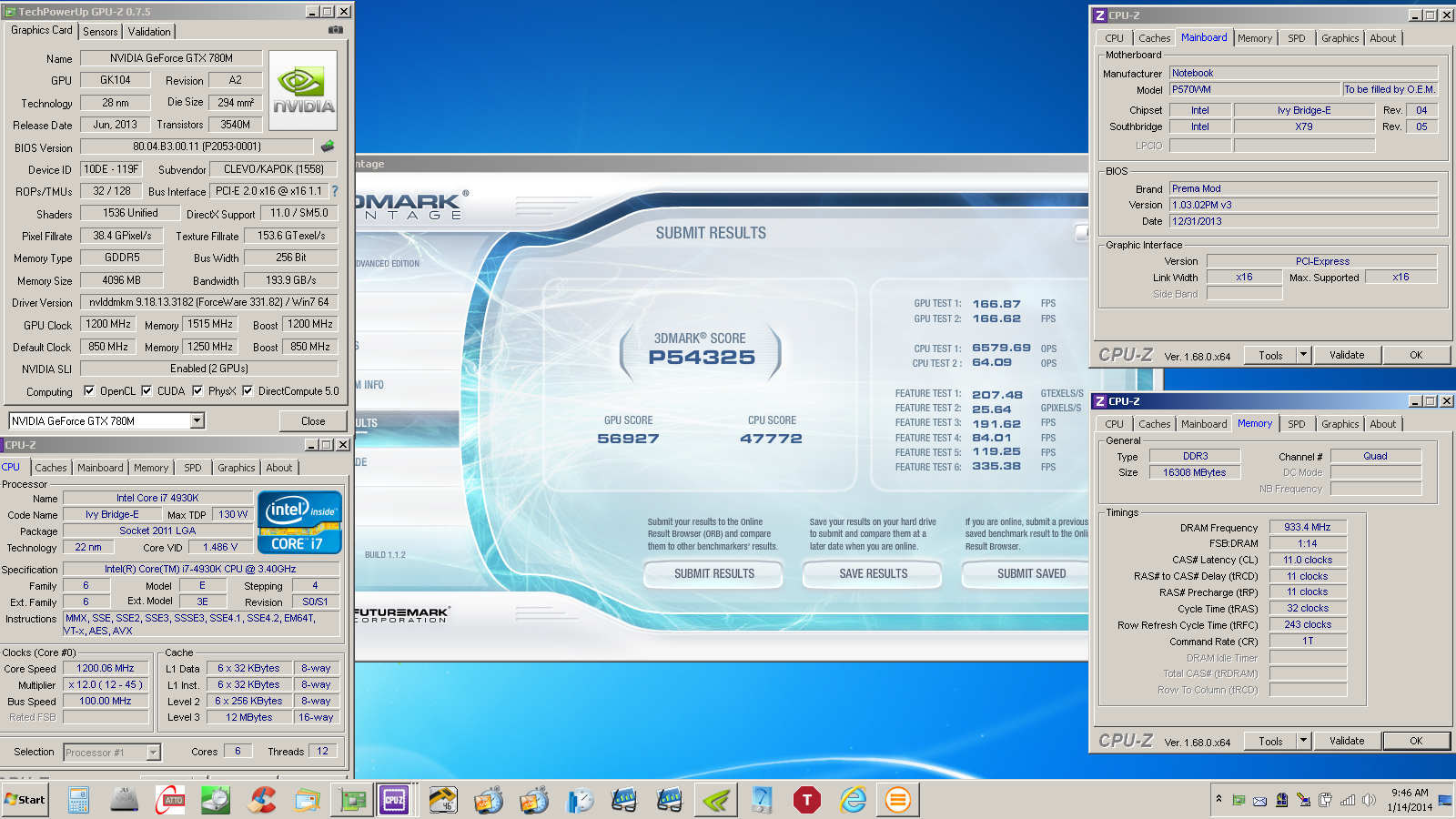

Looks like you ran that pretty much stock, so yes good run. Exactly where you'd expect, so no worries. Now start pushing it a little bit at a time.

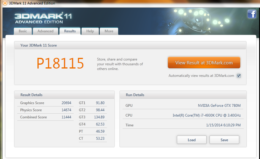

Did you put a value in the BIOS field like I said? If so, what was your voltage. And what was your multi (43x??) I can not tell by the 3dmark11 run. Sysinfo will read the turbo core clock as zero if the GPU's are overclocked when the test starts. Your cpu clock shows zero for turbo core clock. So again, just asking what your multi and voltage were.
