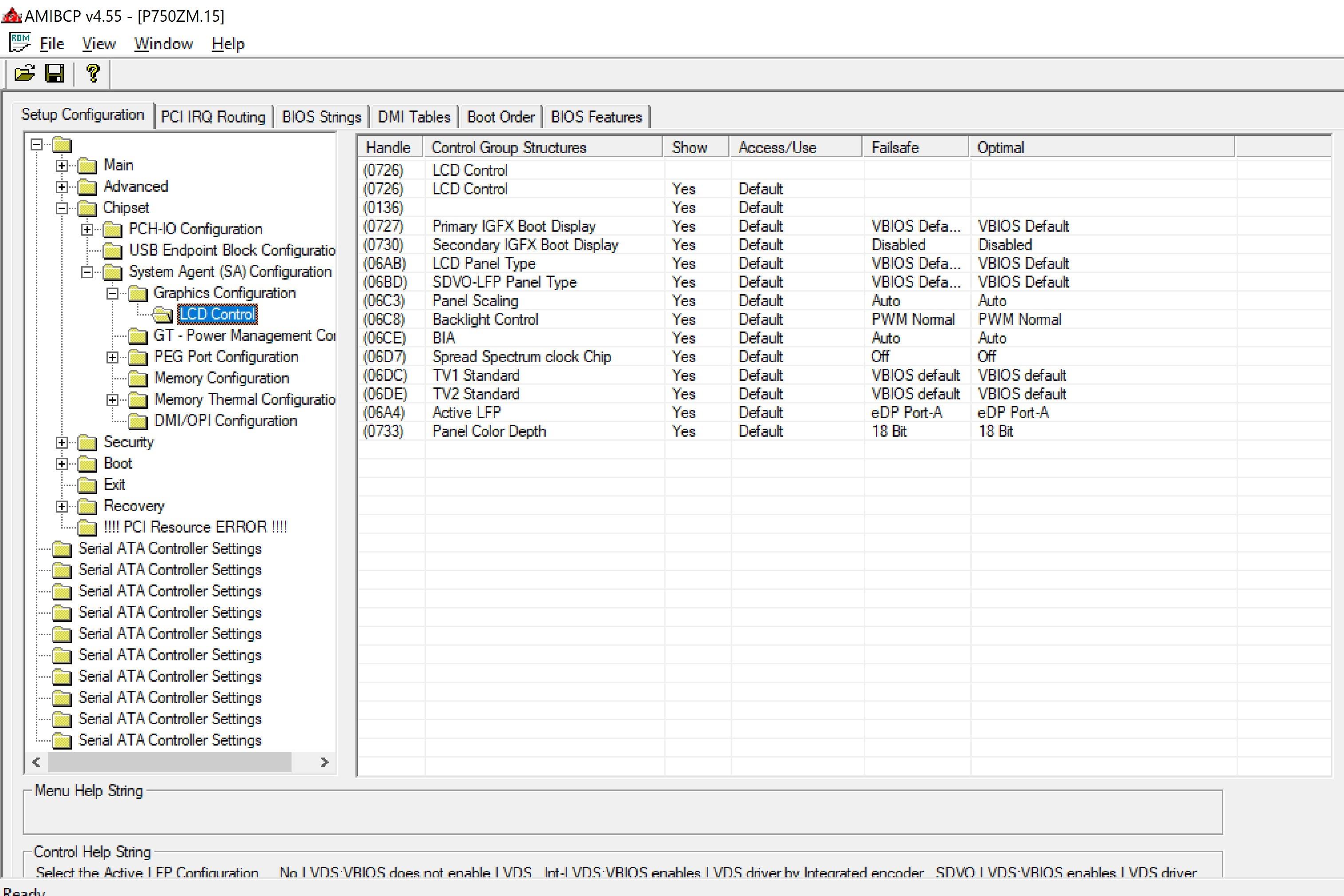

In the BIOS, via amibcp, I saw that in the LCD Control section, the Active LFP parameter was already initially set by default to eDP Port-A, although in the settings there is an option to select LVDS and eDP Port-D.
Dear experts, help me find a solution, I am grateful in advance.
