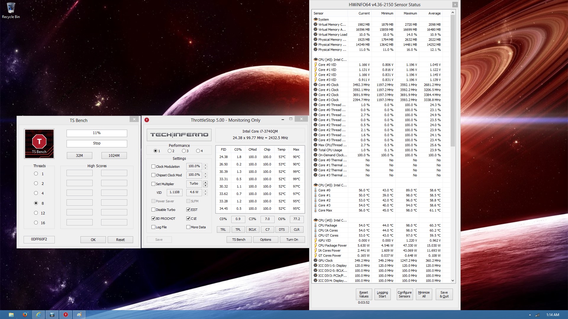

Hey guys, just want some advice...I have read on the main Prema page that XTU and the prema BIOS Mods don't work well together...is someone able to confirm the below and if it is related.
Before I updated my P150EM with the Prema BIOS/EC Mod, running XTU Stress/Benchmark tests I would have my CPU throttle back once it reached 94-96 degrees Celsius.
After the BIOS/EC Mod, I am now getting no throttling at all and CPU temps rose up to 100 degrees, thus I quickly stopped the test. Idle temps sit at around 45-50 degrees Celsius.
Does the BIOS/EC mod remove throttling, or is this an issue with XTU and the Modded BIOS?

The stock clevo cooling has many bonehead design and manufacturing problems (warped die contact plate and gigantic air gap allowing around 1/3 of air to be sucked back into fan intake). You can drop temps by over 20C by correcting them.
Another thing you can do is flash the P170EM EC, which will run the cpu fan at 4k rpm starting at 90C, while the P150EM EC never runs over 2.8k rpm even at 100C. You can force 4k rpm with the fn+9 shortcut key to test it without any flashing.
Did exactly what Prema said, uninstalled XTU, loaded BIOS defaults, and ran TS Bench 1024M, monitoring with hwinfo and TS...ran it to 11% and stopped it as temps creeped back up to 100c again.
I did an artic silver re-paste about a month ago on the GPU and CPU, GPU temps have been stable to 75c whilst playing most games at stock GPU clocks, and CPU temps have been between 60-70c whilst playing games.
Only when stress testing it does it creep up to 100c, which I thought throttling was there to protect it from doing so and damaging the CPU.
Sorry, the below was run also with the fan running at max with Fn+1.
You have a problem with your cpu die contact. This is not BIOS related. If you want help with fixing it, you should either look at other p150em cooling threads, or make your own asking for help since this thread is for BIOS mods.
