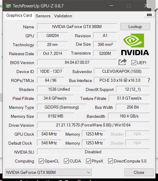

Hello folks i have a Clevo P771DM with a 980 GTX M 8 GB  (Intel GPU disabled by vendor) , bios does not allow fan control or overclocking
Im looking for a way to gain at least fan control for the gpu because the Control Software Center of Clevo frankly blows nuts.
(This is a 2500$ Machine and they provide literally no support , no bios updates and ship a software that is ultimatley garbage)
Basically i want to be able to control my gpu with third party tools such as MSI Afterburner (well at least the fan speeds)
Can this be done or is there one i can get for this already?
Regards, Sabre
This is the V-BIOS
GM204.zip
Edited by sabrehawk

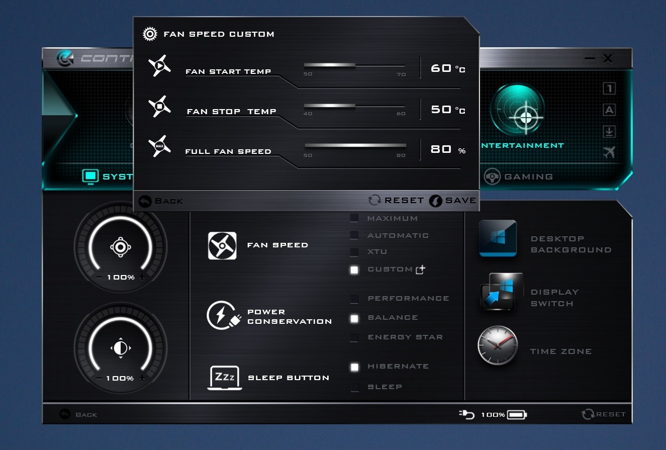

If you need the Fan Control from this new EC 1.05.01 (i wrote some Posts before) then you can use Hotkey 3.08.20!
It works fine with PremaMod v2 and that Hotkey Version - you can use it like in the attached Picture :)
