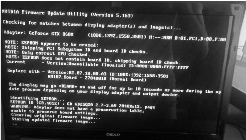

Greetings, everyone. A question to @Prema or other bios tech savvy forumites.
I've got a Clevo W370SS laptop with a GTX 860M videocard and an i7 4700MQ CPU. It is also known as Sager NP7378, DEXP Ares 101, and DNS Extreme 0802876. The former two brand names are used in the Russian market.
Basically, my problem was the laptop's slight overheating when I played a not so demanding game (PoE) at low-medium video settings.
I wanted to underclock the powerful 860M 60 Watt GPU and perhaps the CPU as well to make it heat less. And yes, I'm all very new to all these vBios mod matters.
So, I decided to explore Prema mod's features and just followed the instructions from his website on wordpress, installing W370SS Prema Mod v1.
Half way through BIOS updating I got these messages and the process froze. The same problem was reported by Nicholas at the Premamod website so I borrowed his shot illustrating the problem.
After waiting for some 20 minutes I shut down the laptop and then pulled out the CMOS battery to reset BIOS. I'm not really sure whether the laptop had been temporarily bricked before I reset BIOS.
Then the laptop started no problem and I accessed Prema BIOS mod's settings and modified some of them all right, so the BIOS seems functional.
Now I really wonder
1. What might have caused the freezing during BIOS update? I followed Prema's instructions thoroughly, and Nicholas had had the same problem, too. I'm not sure if it's relevant, but he's also using the Russian version of this laptop.
2. Was the Prema BIOS update actually successful despite the freezing? If it wasn't, how do I complete the update or run a fresh update? Also, is there a newer (v2 or v3) version available that would suit my Clevo?
3. Can I underclock my GPU and/or CPU using Prema's BIOS? I failed to find these features in the mod.
It might have been a silly experiment, but Prema's enthusiastic effort on BIOS modding are very much appreciated, the BIOS offered by DEXP is extremely limited.
Thanks in advance for any help!
So, Prema's response was as follows:
Quote
1 & 2:
It didn't freeze for Nicholas!
His previous/existing vBIOS already was a factory brick (which he apparently didn't even notice) and flashing the Mod actually recovered it. ;)
The W370SS series also had some factory BIOS problems on older revisions, which lead to the hanging in your case.
Since you are updated now you are on a golden version and it can no longer happen. ;)
3:
You can now e.g disable cores, Turbo, hyper-threading, underclock the CPU in the the 'CPU Configuration' section of the BIOS.
To underclock the GPU you can use the software NVIDIA Inspector.
ENJOY! :)
