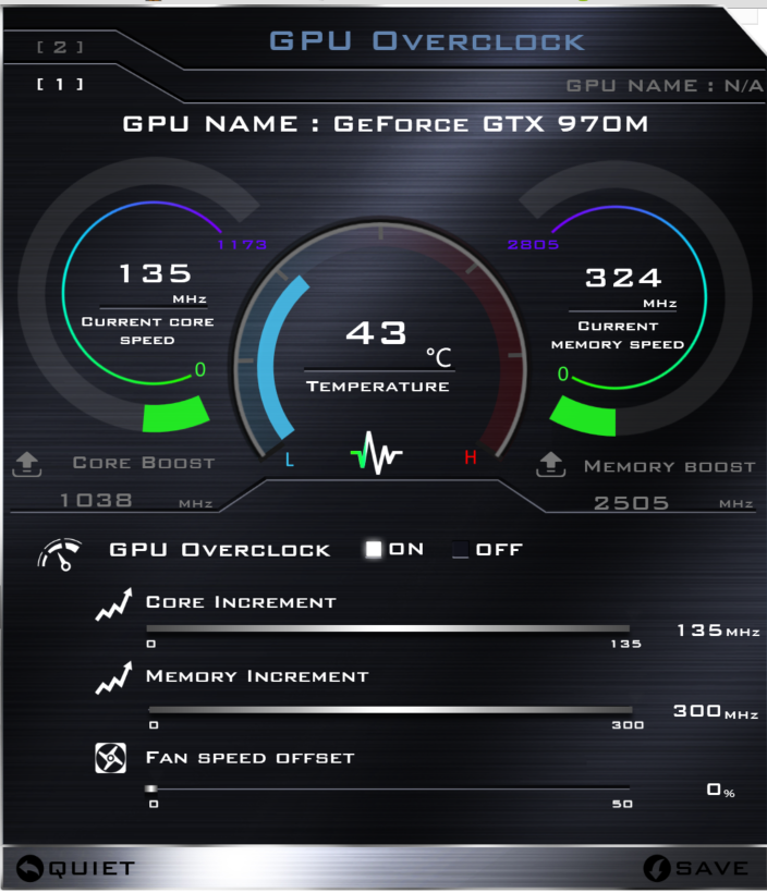

Ok, I need some help before doing this (I would lose my shit if this woudl get my system 'bricked')
I have a Clevo P650RE6 GTX 970M 6GB and my BIOS version is 1.05.07 (system model: P65_P67RGRERA)
IS it completely SAFE for me to flash my 970M?
Like, does my model meet the requirements to do so?
Do I have to be in discrete mode or hybrid (does it even matter)?
Must I uninstall all my gfx drivers?
And what are the benefits of flashing the vBios versus using the tuning tools that come with the Clevo software suite:
Spoiler
This is uncharted territory since I've never flashed a vBios and I'm not exactly sure what the benefits are and if a fallback is possible etc...let's say I would start to get artifacts etc, what then?
It's scary.

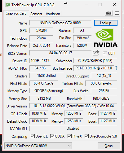

19 hours ago, wersuss said:
Hi Prema. Using vbios for GTX980M, but i think PSU 180W is not enough for overclocking. Can't push it too far, driver stops, or you can see fps drops. :) Clevo P150SM-A.
which cpu do u have and how do u test stability?
i tink u could get the 220w p170em psu

On 17.6.2016 at 7:30 AM, wersuss said:
I7 4710mq. I use Valley or Heaven benchmark.
normally the 180w soulh be sufficient, have u treid benching with external screen so the laptop screen is out, and uses no energy?
i got a 3920xm and 980m but 220w psu and it s all fine, your cpu pulls way less energy thou
u could also trie benching 3dmark11 becuase its not cpu AND gpu heavy, its one and then an other
Thank you Chap :) I will try to use external monitor.

Hello, why i get GPU POWER LIMIT REACHED and itl throtles down clocks? With overclock just +70mhz core.On Valley benchmark.  Gtx980m, PSU 240W
Edited by wersuss
Solved thanks to Prema.
