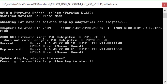

I have p771zm with gtx 970m mxm card
I flashed the moded bios,
now i need to flash the vbios for the gtx 970m?

Nice, ENJOY! :)
Check this for the GTX9xxM vBIOS changes:
http://forum.techinferno.com/clevo/3119-%5Bbios-vbios-mods%5D-prema-mod-stock.html#post54056

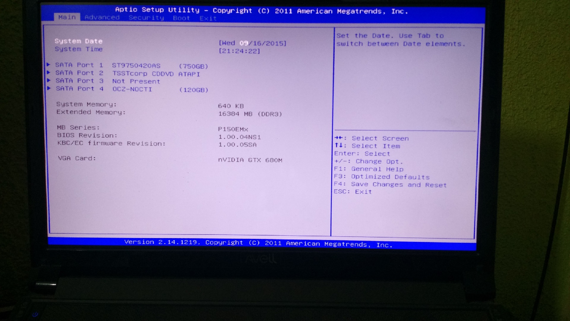

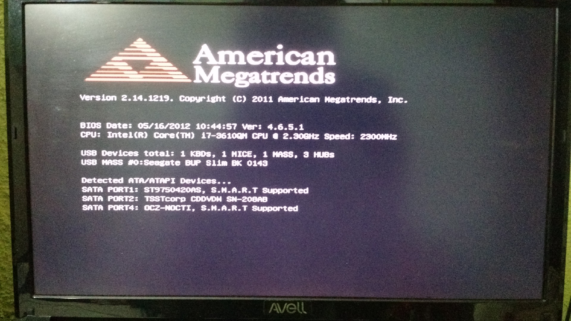

Hi, I have an Avell G1530 (Clevo P150EMx) with a GTX680M, and want to use Prema MOD BIOS, to do this safe and right I want to ask a bit before.
I had taken photos from my boot screen and BIOS as I've put here in the thread, I think that the most important info is:
MB series: P150EMx
Bios Rev: 1.00.04NS1
KBC/EC FW Rev: 1.00.05SA
My questions is:
1) My PC shows P150EMx in place of P150EM, these two uses the same BIOS?
2) To use Prema MOD I need to update my BIOS and KBC to the newest possible stock BIOS (eg. BIOS 17 and EC 11) ?
3) Where do I see my ME version? I have entered all the screens of my BIOS and didn't saw ME info.
4) With a i7-3610QM, can I use overclock goodies of Prema MOD? (I want Prema MOD for other things too, like UEFI on Windows 7).
5) Do I have to be a fully charged battery, need to remove battery or something about battery that I need to know? Because I read that to make the flash one need to be in AC mode. The point that makes me think about the battery is the point where the tutorial said to shutdown laptop, disconnect AC and wait 30s. It is needed to remove battery too?
6) In Prema's site, the page of P150EM says that I need to use one of the two options (K1/K2) but it says that K1 has Winkey right and full FAN in FN+9 and K2 has Winkey left and full FAN in FN+1, my keyboard have Winkey in right (who puts me in K1 option), but my full FAN is activated pressing FN+1 (who is K2 option). So which one I need to use?
Photos:
Thanks everyone!
MB series: P150EMx
My questions is:
Photos:
[ATTACH]15934[/ATTACH]
[ATTACH]15935[/ATTACH]
[ATTACH]15936[/ATTACH]
Thanks everyone!
1. Same thing
2. On PxxxEM systems BIOS/EC 1.00.04 is the minimum version to directly flash the Mod, so you are good to go
3. After flashing the Mod you can update the modded ME firmware to the latest version (8.1.65.1586)
4. The Mod will enable you to use Intel XTU Utillity to overclock CPU, RAM & iGPU. It'll also allow you to install W7 in UEFI mode.
5. AC Adapter and battery need to be connected for the flash. Only AFTER it is complete and has shutdown you remove AC Adapter for 30s.
6. K1 (FAN will just change to FN+9)
7. ENJOY! :)
1. Same thing
7. ENJOY! :)
