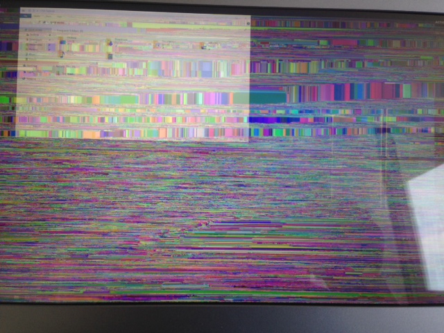

Hi Prema,
I've got a weird problem on my W230SS. I recently replaced my broken laptop screen (the LTN133YL01-L01 4k) with a new one, the LTN133YL01-F01. This was the only replacement I could get and they are completely similar in specs except for an anti-glare coating. When using Windows I get flashing artifacts on the screen. I have updated your firmware to the latest version (1.1) and there's less flickering now, but it's still there. Then I noticed that when I use the power adapter the artifacts do not appear. It seems only to occur when running on battery power. Do you have any idea how I can fix this? I thought that it might have to do with timings or voltage?
Thanks,
R.
