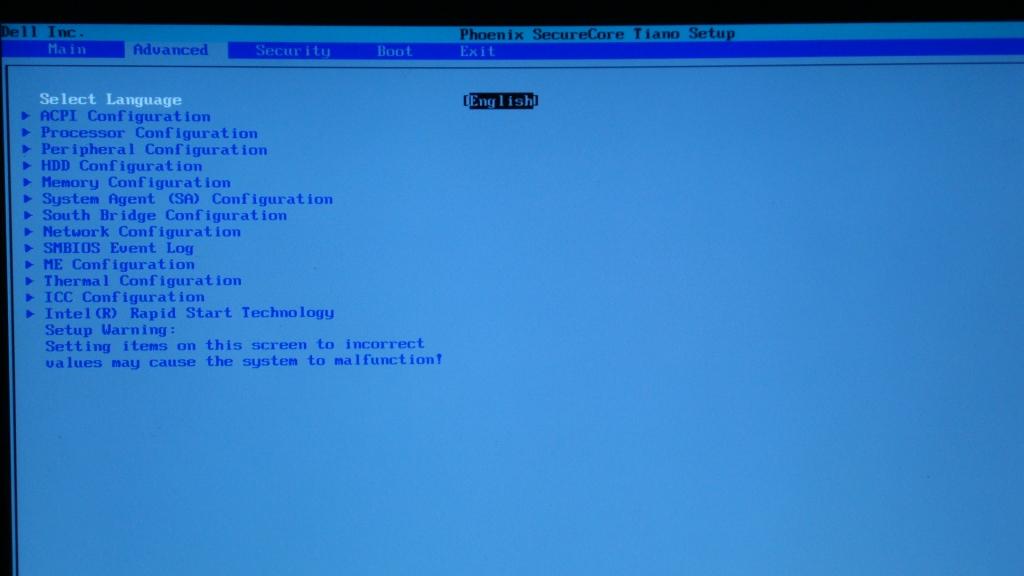

krendel 11 Posted February 25, 2013 Unlocked. Quote Share this post Link to post Share on other sites
svl7 5708 Posted February 25, 2013 Sounds interesting, but do you have any more information and the bios itself? That's just a random screenshot of a bios setup... not even the model is displayed.Who modified it? Source? Quote Share this post Link to post Share on other sites
krendel 11 Posted February 25, 2013 Sorry,I do not speak English. I am writing a translator. This bios A12 for Dell Inspiron 7720SE. Fully working. Authors from Ukraine, not me. Quote Share this post Link to post Share on other sites
svl7 5708 Posted February 25, 2013 Okay, no problem, but do you have a a download link? Or a link to the original site where this was posted? Quote Share this post Link to post Share on other sites
