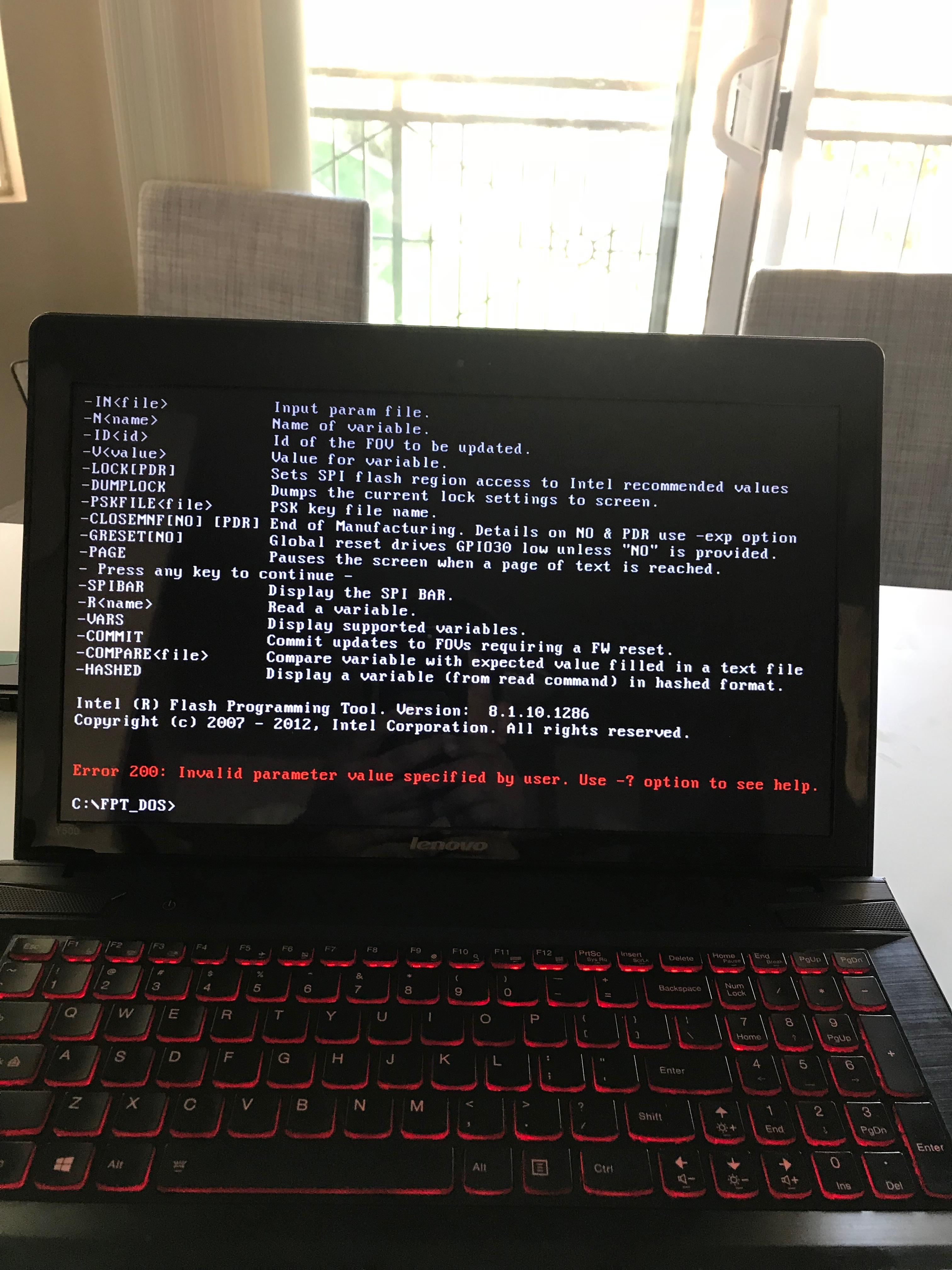

andreszzo Posted February 3, 2018 Share Posted February 3, 2018 (edited) i encountered "error 200" when running backup bios tool. I tried running fpt_dos and i tried fpt_w64. I got the same error both times. How do i get around this error? I am running V2.04 BIOS . I also could not create the DOS boot USB by the method described here. I had to use rufus instead and from there i tried to furn fpt_dos to create by "bios backup" witch failed. Edited February 4, 2018 by andreszzo add information Quote Link to comment Share on other sites More sharing options...

andreszzo Posted February 4, 2018 Share Posted February 4, 2018 On 9/18/2017 at 6:29 AM, Klem said: Yes. Hello, i encountered "error 200" when running backup bios tool. I tried running fpt_dos and i tried fpt_w64. I got the same error both times. How do i get around this error? I am running V2.04 BIOS . I also could not create the DOS boot USB by the method described here. I had to use rufus instead and from there i tried to furn fpt_dos to create by "bios backup" witch failed. Please help. Quote Link to comment Share on other sites More sharing options...
Bios Modder Klem Posted February 5, 2018 Bios Modder Share Posted February 5, 2018 9 hours ago, andreszzo said: Hello, i encountered "error 200" when running backup bios tool. I tried running fpt_dos and i tried fpt_w64. I got the same error both times. How do i get around this error? I am running V2.04 BIOS . I also could not create the DOS boot USB by the method described here. I had to use rufus instead and from there i tried to furn fpt_dos to create by "bios backup" witch failed. Please help. Hi! Send me your file backup of bios via PM. For creating backup of bios use attached program. Extract attached archive directly on the Desktop and run the program as Administrator (right click mouse). Program will create archive "results" directly on the Desktop. Send me this archive "results" via PM, or upload it to any fileserver and send me the link. https://www.sendspace.com/file/mxoavw Quote Link to comment Share on other sites More sharing options...

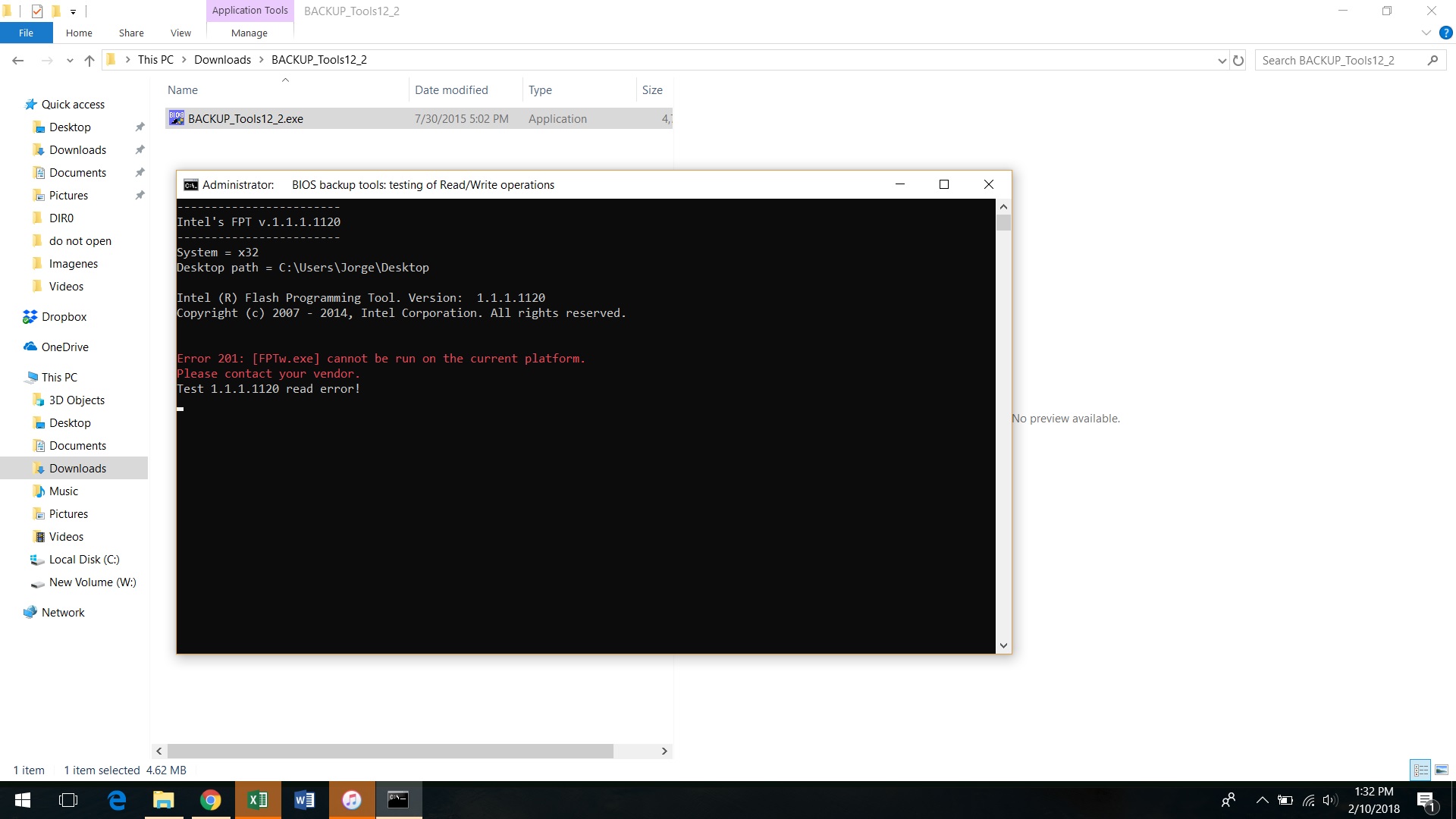

andreszzo Posted February 10, 2018 Share Posted February 10, 2018 On 2/4/2018 at 10:15 PM, Klem said: Hi! Send me your file backup of bios via PM. For creating backup of bios use attached program. Extract attached archive directly on the Desktop and run the program as Administrator (right click mouse). Program will create archive "results" directly on the Desktop. Send me this archive "results" via PM, or upload it to any fileserver and send me the link. https://www.sendspace.com/file/mxoavw Hi, I downloaded the program and this error now. I did run it as administrator and nothing. Is there any other way? Quote Link to comment Share on other sites More sharing options...
Bios Modder Klem Posted February 11, 2018 Bios Modder Share Posted February 11, 2018 8 hours ago, andreszzo said: I downloaded the program and this error now. Do not pay attention to errors, just let the utility completely finish its work. Quote Link to comment Share on other sites More sharing options...
andreszzo Posted February 11, 2018 Share Posted February 11, 2018 15 hours ago, Klem said: Do not pay attention to errors, just let the utility completely finish its work. Alright! Here is the results.rar file. What is the next step? https://www.dropbox.com/s/58txzb5v46aoriz/results.rar?dl=0 Quote Link to comment Share on other sites More sharing options...
andreszzo Posted February 18, 2018 Share Posted February 18, 2018 On 2/10/2018 at 11:07 PM, Klem said: Do not pay attention to errors, just let the utility completely finish its work. Hi Klem, Here is the results file. Could you take a look a it? Is there another way go gain access to the BIOS files? https://www.dropbox.com/s/58txzb5v46aoriz/results.rar?dl=0 Quote Link to comment Share on other sites More sharing options...
Bios Modder Klem Posted February 19, 2018 Bios Modder Share Posted February 19, 2018 (edited) 14 hours ago, andreszzo said: Hi Klem, Here is the results file. Could you take a look a it? Is there another way go gain access to the BIOS files? https://www.dropbox.com/s/58txzb5v46aoriz/results.rar?dl=0 Ok, in attachment your file backup of your actual bios. backup.rar Edited February 19, 2018 by Klem Quote Link to comment Share on other sites More sharing options...
