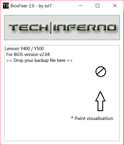

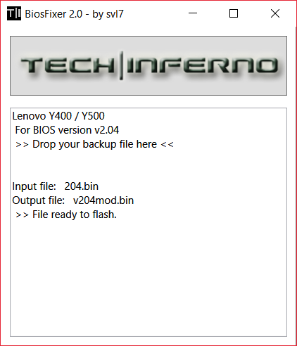

Lol, i am KEEP getting Errors!
New one is - i can't Drag-and-Drop modified BIOS in svl7 tool. =) It's showing me circle with "/" line.
I was smart and check box Run as Administrator in Compatibility Tab of BiosFixer_2.0.exe before running the tool.
So, now need go back and uncheck the box. :)
Oh that Windows 10! :) It's not trust Intel Corporation, but have no problems with svl7 tool. =)
Edited by rusTORK
