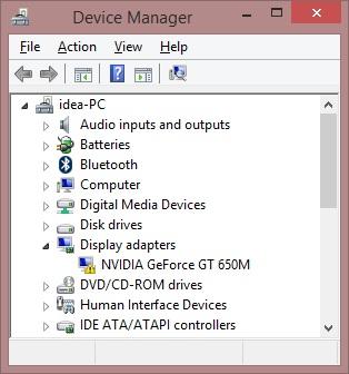

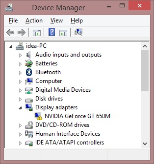

Newbie here, so bear with me... Apologies in advance for the long post, just want to be thorough...
After having some issues with my y400 recently, I performed a full system recovery. I ran and installed all relevant Windows updates, which included the upgrade to Windows 8.1. I also checked Lenovo support for all driver updates that applied. Here is where I run into a problem. It seems that I have the most recent BIOS update (v2.04), but not the most recent VBIOS (NVIDIA GeForce GT650M Second VGA BIOS Update for Windows 8.1 (64-bit) - IdeaPad Y400, Y500). That said, when I try to install the new VBIOS, it doesn't take. A command window opens briefly and immediately closes, not allowing me to enter any commands, as the Lenovo instructions would have me do.... Then nothing happens. I've tried doing this numerous times with no success. I should also note that I keep getting pop up notifications in my task bar telling me Windows has disabled my GT650m, and/or "display driver has stopped responding and has recovered"... I'm at a loss. Any help or advice on this would be greatly appreciated. Here some additional info that may be relevant:
Device Manager showing only one display adapter- Intel HD Graphics 4000 missing:

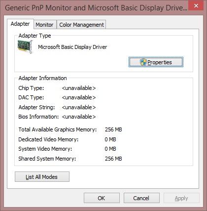

Display adapter properties:
Thank you for reading through all of this... and feel free to ask for any addtonal info....
[ATTACH=CONFIG]14608[/ATTACH]
This has been my problem with my Y500. You can see my thread that I started on this , but I dont mind if we can find the solution here. For me my Ultrabay 650M works with the unlocked vbios but eventually stop responding as it is with JuneBug. I am wondering if it is a bug in the bios?
Y400/Y500 technically doesn't support internal graphics of the CPU.You can to turn on it in BIOS and you'll be noticed in AIDA64 about intel hd 4000 showing but in fact it doesn't work at all
anybody know if we can force the hd4000 intel igp and enable the hackintosh installation
This has been asked a million times already. ​iGPU is impossible to access.
No no idea about Hackintosh.
I own a y500 with g750m
have you tried starting fresh with fresh install then updating BIOS/drivers with lenovo website listed. Then applng svl7s mod? If you vBIOS keeps getting curropt. I had to send my laptop into lenovo for a new one because the mobo has a issue in its reg to wake the laptop when you close the laptop. Espically if your running 2mobo unlocked, it sounds like you have some curroption in .net runtime loaders. Even if your not OC the ultrabay or onboard. try using the tools on this site to help find solution for fix. Wagnard Tools
I know most of the errors come from the powerspecs required to the mainboard. make sure your powercord/battery are g2g when applying fixes. Flashing vBIOS over and over is only going to cause sys reg errors and problems. I recommend starting with fresh load, updating authenictic signed drivers, applying the new BIOS patch, then flashing the mod's for stability.
Kind of hard to help you out without more detail on the exact error your getting when it happening, and when it started to happen. Also did you purchase a 650gt ultra bay and have a 750gt onboard or do you have the older y500 version with the gt650 onboard. please list more specs, and errors : )
