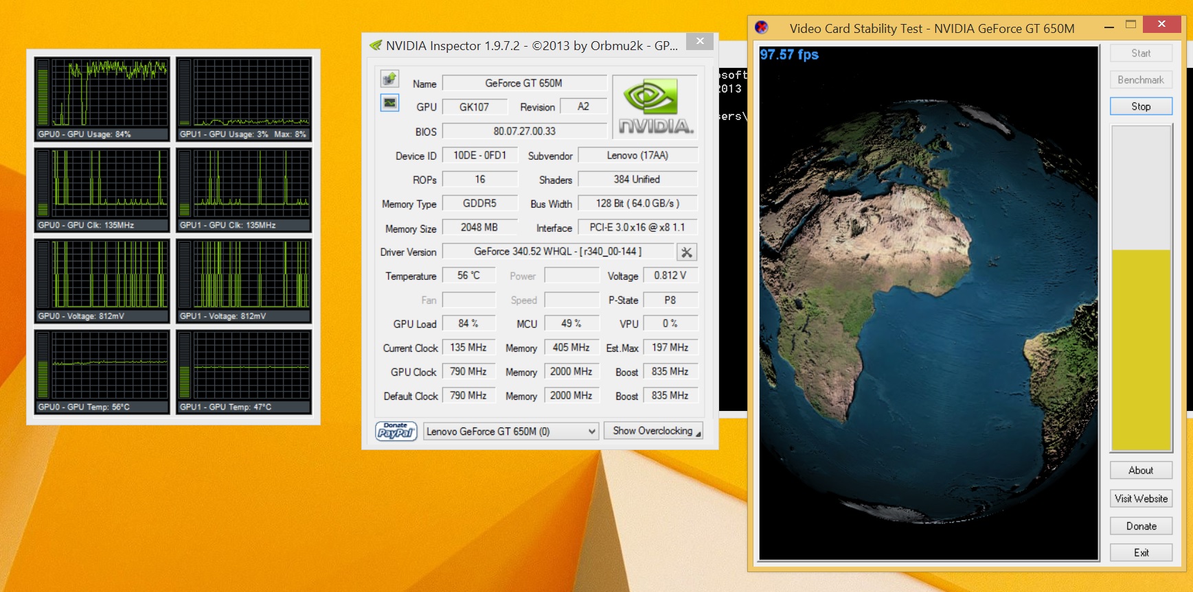

Jason22492 Posted August 1, 2014 Share Posted August 1, 2014 Hey guys, it's good to see that the thread is still active. I'm run into a bit of a problem with my Y500 650m GT SLI, and I've surfed through the internet and forums as much as possible to remedy this issue, but I'm not 100% and would please like guidance. I figured that this would be the best possible place to ask. Basically, My Y500 is stuck at the P8 (idle) state even when running 3D applications including gaming. As shown in the attached photo, it literally spikes to P0 for 1 second only to drop back down to P8. Therefore, I am ultimately stuck at 135/405... Now I have heard that it is possible to manually control the P-state through configuring with Nvidia Inspector, but I haven't done that yet and would possibly like to fix the issue without having to do that. Would any of you happen to please know how I could best remedy this issue so I may be able to play 3D games at full optimal P0 state performance? I would greatly appreciate it. What I've tried/done: 1) Try Lenovo's new vBios for windows 8.1 2) Try another fully functional SLI Ultrabay Card 3) Reinstall OS What I haven't done yet: 1) Manually configure P-state through Nvidia inspector coding (unaware on how to do this, will read up on it and try later) 2) Flash the bios to 2.04 to unlock (it is on default 2.02) Note: This is mainly concerning SLI performance, as many would already have assumed. When I take out the Ultrabay SLI card, the single 650m GT runs fine on P0 state when 3D games are on. Quote Link to comment Share on other sites More sharing options...
Jason22492 Posted August 1, 2014 Share Posted August 1, 2014 Update: I have tried forcing p-state using the Nvidia Inspector. Unfortunately, it was to no avail with the computer with the 650m SLI. I have confirmed that it works if I take out the Ultrabay SLI Card, however. There definitely is something PREVENTING the GPUs in SLI mode from going to P0 state, and I have no clue why. I have tried Power management settings, and everything google has told me. I am hopelessly wondering if Modding the BIOS to 2.04 to unlocking the BIOS will perhaps solve this issue. If there's any guidance anyone could possibly provide me, I would greatly appreciate it. Thanks. Quote Link to comment Share on other sites More sharing options...
DARKWORLD Posted August 1, 2014 Share Posted August 1, 2014 Jason22492I had the same issue, although it was on Windows 7 and with single 650 during games, it just switched to P8 at random times and stayed there. Cured it with 2.04 modded bios.Though I still have no clue what could potentially cause this, may it be lenovo stock bios, ultrabay card bios or some power settings. The only thing I know for sure is that without overclocking - this machine sucks.Also I have another potentially bad news for you - http://forum.techinferno.com/lenovo-ibm/7331-vsync-buggy-not-working-properly-y500-under-windows-8-1-a.htmlIt appears to be a Windows 8.1 conflict with this machine.So what I suggest in your case:1) Check your PSU, it must be 120W, otherwise its a no go with SLI.2) Flash to 2.04 bios (its not hard at all just follow instructions on the first page).3) Test all this on Windows 8.1. Quote Link to comment Share on other sites More sharing options...
