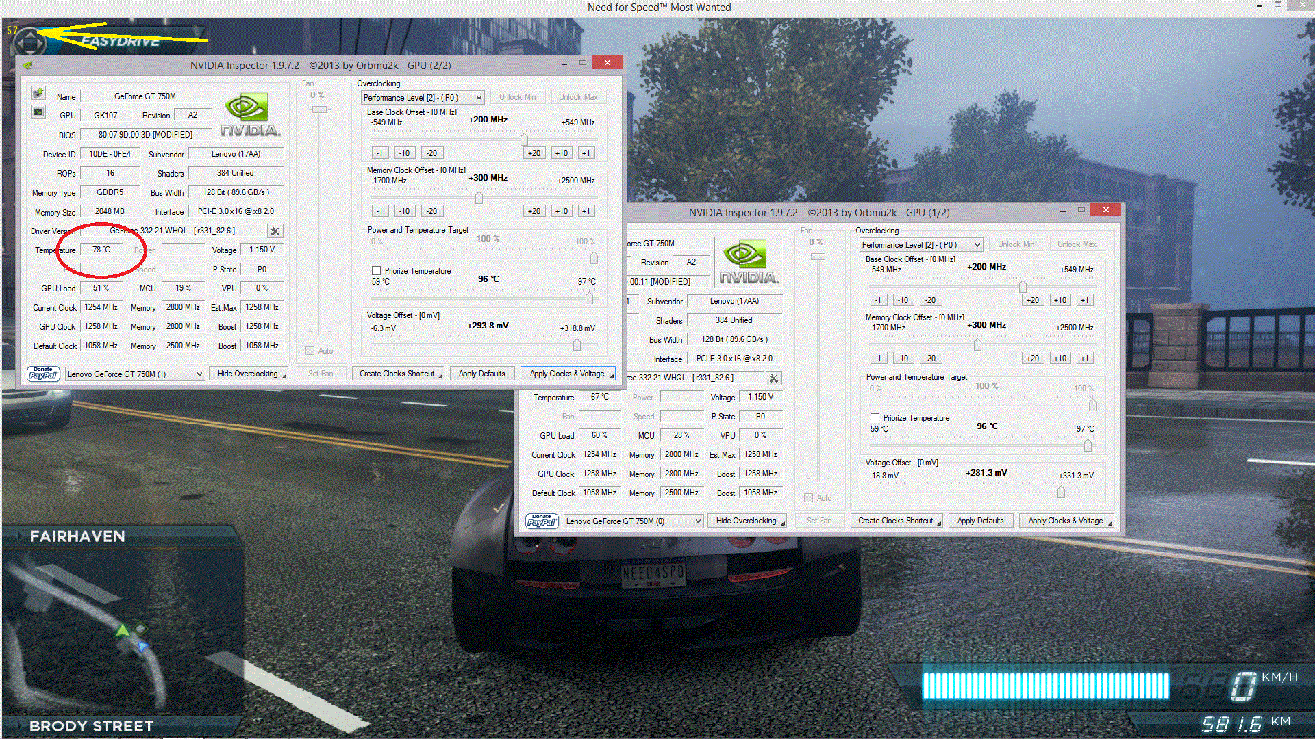

@Klem , i'd flashed your vbios for 750m ultrabay on w8.1... but i just cannot overclock past 135mhz, i mean i can apply 300mhz core clock but suddenly during playing games, the games force close and the core clock returns to its original value 1058mhz.... can you fix it?
You overclocked too much and it crashed. Try lower clocks or increase voltage if that is possible.

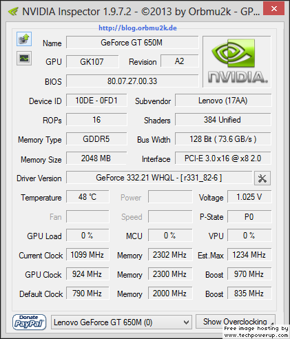

How much of a performance difference should I notice if I OC my 650m's, and is it safe. (I do have a cooling pad, but I don't want to wake up the next morning with a fried laptop.)
GPUClock: 1000-1100
MemoryClock: 2200-2300
how about the voltage? stock settings?
Yeah most 650M cards should be able to hit those core clocks on stock voltage. Overclocking is always a crapshoot though so you could always wind up with a poor overclocker or a terrific one or in-between.

i oc both cards , the voltage also and got around 48-59 fps in NFS MW with full hd high settings,, but the crappiness is the ultrabay graphic, got its temp spiked up really fast... however the internal graphic card stays stable around 69-78 degree C...
