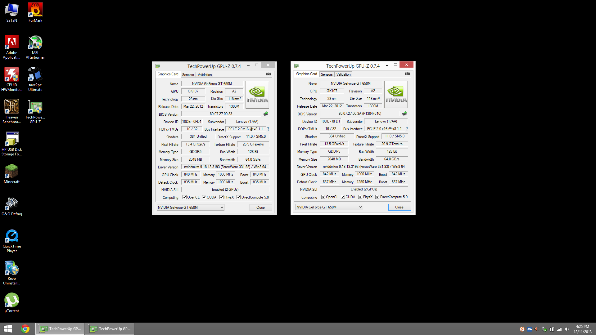

Only modified VBIOS for the ultrabay card is needed. Internal card VBIOS is integrated with the main BIOS and cannot be flashed seperately. This does not cause any issues with SLI, as Nvidia states VBIOS version don't prevent SLI from functioning.
Good to know - I'm just trying to get similar clocks on both cards so I don't have to apply clocks manually all the time. I'll dig through the BIOSes and try to find some that match...

So, I recently updated to Windows 8.1 and it messed up SLI and led me to have to do some searching online and find out that I had to flash the VBios with the fixed 8.1 bios from Lenovo, and after I did so, overclocking stopped working, one card overclocks, but the other doesn't. Could anyone help me please? If you need anymore info at from me, don't hesitate to ask
