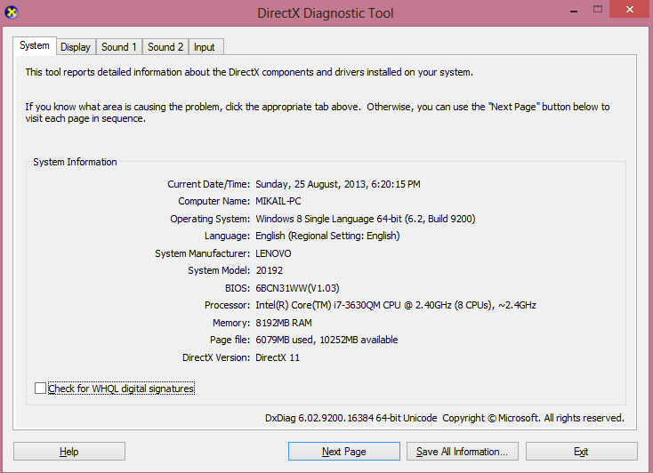

hi, i am the owner of the Y400 model ideapad and sooo i just realised that this laptop cant overclock its GPU so i came upon this forum and i am unsure on how to flash my BIOS and at the same time afraid that i might brick my laptop. so my BIOS version is currently 1.03, so what is the first step i should do? upgrade it to V2.02 right? post-16686-14494995963897_thumb.png
I have a Mac error while starting my Y500, just a black screen (the "Lenovo" logo does not even appear) saying something with Mac error, no bootable device (before updating my BIOS), I'll try the Update now, hopefully it fixes this Problems

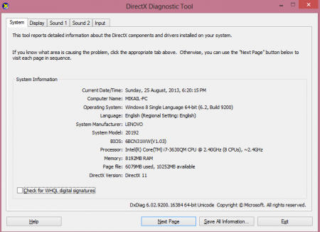

hi, i am the owner of the Y400 model ideapad and sooo i just realised that this laptop cant overclock its GPU so i came upon this forum and i am unsure on how to flash my BIOS and at the same time afraid that i might brick my laptop. so my BIOS version is currently 1.03, so what is the first step i should do? upgrade it to V2.02 right? [ATTACH=CONFIG]8763[/ATTACH]
Yes update to 2.02 stock first then flash the 2.04 mod.
Flashing the mod v 2.04 on bios 2.04 is still possible without any problem?
Yes it's fine.
