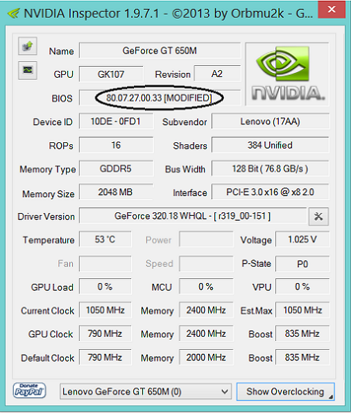

Hello svl7,my bios is v 2.00. Is it possible to mod it? and why does my y500 freeze in metro 2033 and needs to be hard reset if i overclock it beyond 1050/2400 in nvidia inspector but i can overclock it to 1100/2500 in bioshock infinite without any problems
My nvidia driver is up to date, v320.18
Update to v2.02 and then use the mod.
Seems like your overclock is not stable for metro. Bioshock is a totally different program, it's not surprise that the overclocking results are different.
