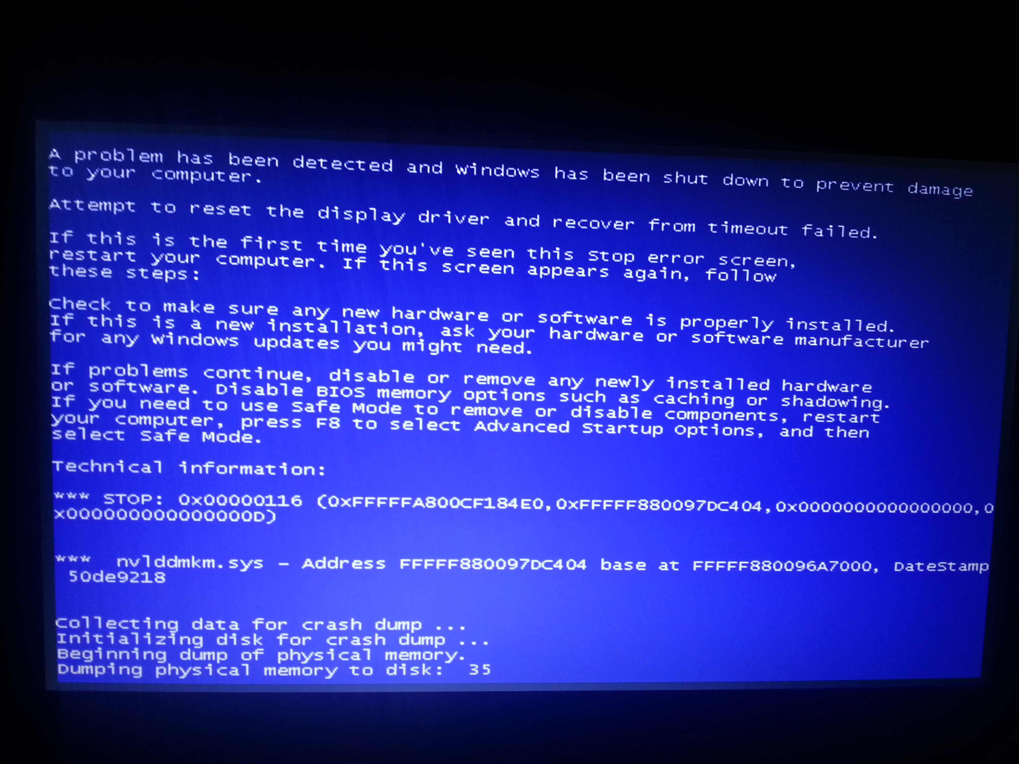

ethik Posted January 13, 2013 Share Posted January 13, 2013 hello playing diablo, I got this message: nvidia kernel error Now I have colored dots all over the screen and the colors are mixed. I updated the drivers but nothing changes This is a msi GT683R. put on a thermaltake. I have this message after 10 minutes thank you Quote Link to comment Share on other sites More sharing options...
Founder Michael Posted January 13, 2013 Founder Share Posted January 13, 2013 Tried completely uninstalling nvidia drivers and reinstalling them? Quote Link to comment Share on other sites More sharing options...
Founder Brian Posted January 14, 2013 Founder Share Posted January 14, 2013 The colored dots and other artifacts aren't a good sign. The card might be toast.Sent from my GT-N7000 Quote Link to comment Share on other sites More sharing options...
Xonar Posted January 14, 2013 Share Posted January 14, 2013 Well the dots/lines aren't on the BSOD screen or probably on BIOS which is good (GPU isn't on its last leg). Boot into safe mode. Are the dots/lines still there? If not, try reformatting and/or reinstalling drivers.Sent from my HTC Sensation using Tapatalk 2 Quote Link to comment Share on other sites More sharing options...
ratbag200 Posted January 16, 2013 Share Posted January 16, 2013 Had this happen in the past on a desktop and turned out to be overheating. Could be your card is heading up way too fast even in idle but then it should throttle? Quote Link to comment Share on other sites More sharing options...
