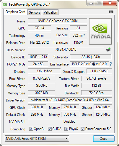

I've done this, and it works. The Bios is overwritten and i can use all Options but my GeForce GTX 670m runs at Core: 620MHz/ Memory: 750MHz/ Shader: 1240MHz
Where could be the Problem?
Thanks for Help.
Weird, can you post a GPU-Z screenshot?

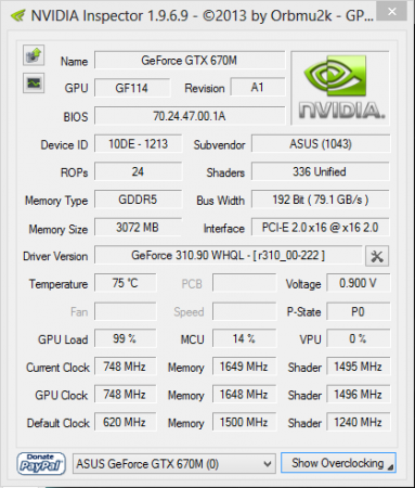

My current 3d Voltage seems to stabilize to 0.9Volts.
Regards, Kaldrosil

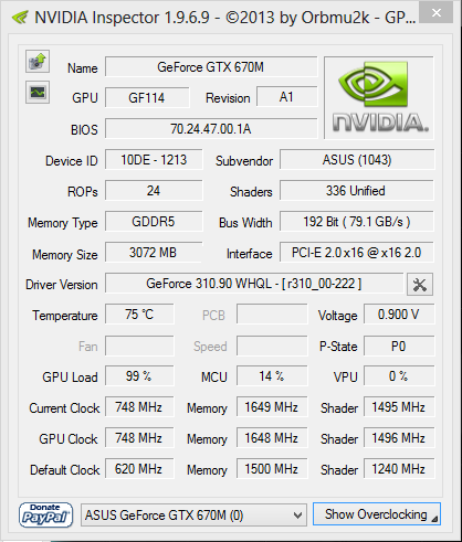

Can you post a screenshot of Nvidia Inspector which shows this in the log?
Here ya go. This is stock 223 Firmware.
Dont know what a safe top voltage could be but I got decent temps at full load ranging from 75-80 overclocked without laptop cooler and 10 degrees C lower with it.
