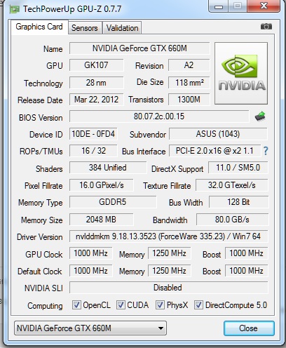

hi svl7
followed instruction as stated. everything went well, but there is one thing i noticed, core clock 1000MHz and boost 1000MHz
here the screenshot:
[ATTACH]11321[/ATTACH]
is there any extra steps to obtain 1200MHz boost?
Just use Msi Afterburner or Nvidia Inspector for increase core clock to 1100 ->1150 -> 1200.
