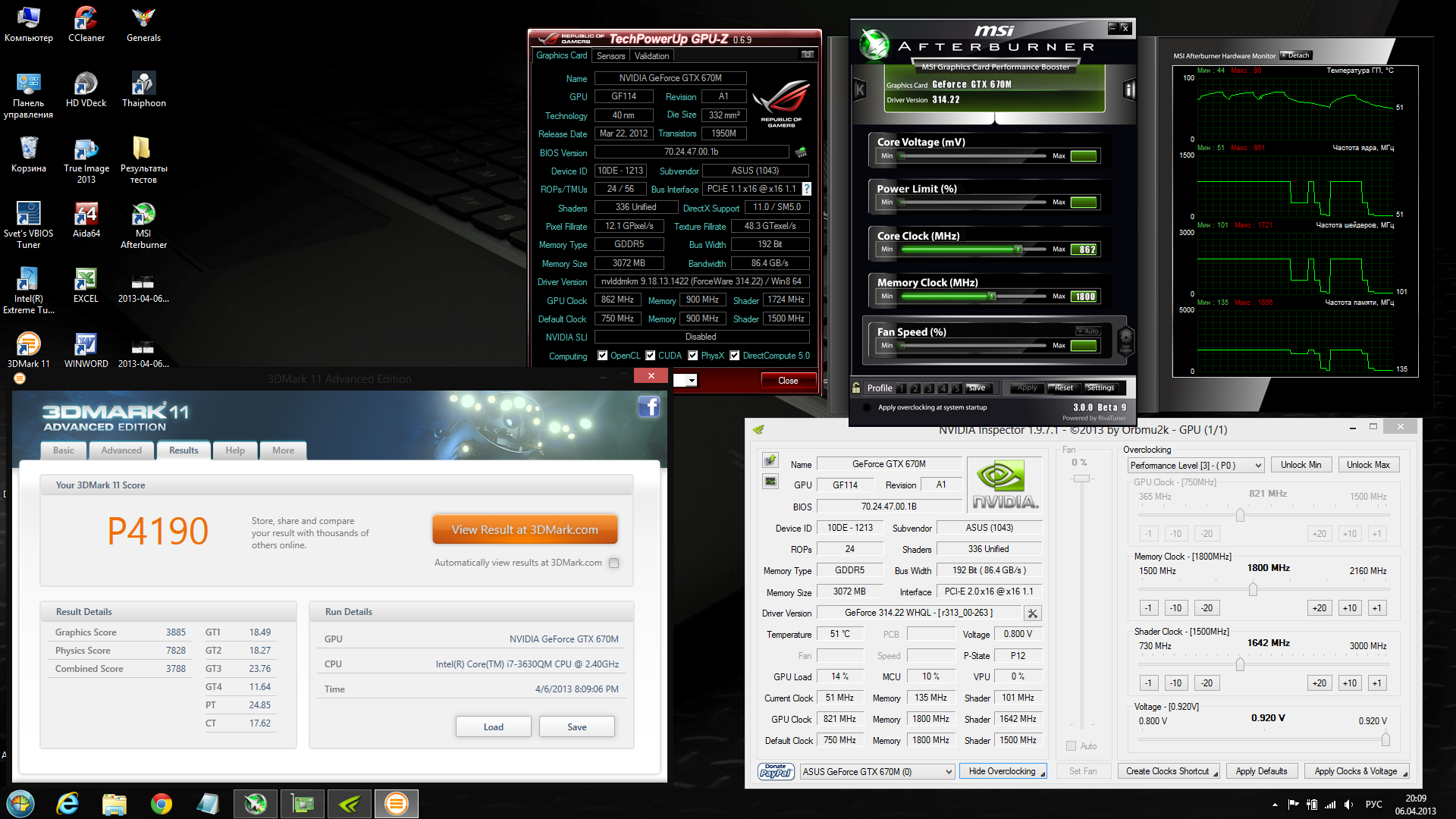

Today I finished modifying the BIOS for G75VW overvolting GTX670M in our notebook. I increased voltage on the GPU in the P0 profile (Turbo Boost) at 0.02 V. GPU once easily overclocking over 870! On the 881 appeared some small artifacts in the form of multiplecolored dots. Fell back to 860, and ran 3DMark 2011 at 1 hour the cycle. Everything is fine! There are no artifacts, and temperature on the GPU is not rise above 80 degrees. Results 3DMark 2011:
GPU at 870 - 4239 with no artifacts!
GPU at 860 - 4190 with no artifacts! Stable run 1 hour 3DMark2011. The maximum temperature on GPU - 80 degrees.
Now i think flash in the BIOS 850/1800(900), and so stop in this.
I made this overvolting ​​specially only for P0 status (Turbo Boost). In other states (2D,Video,...) video card running at its standard voltages and frequencies, changing them in their own table.post-11295-14494994902216_thumb.png
I made this overvolting ​​specially only for P0 status (Turbo Boost). In other states (2D,Video,...) video card running at its standard voltages and frequencies, changing them in their own table.[ATTACH=CONFIG]6843[/ATTACH][ATTACH=CONFIG]6844[/ATTACH][ATTACH=CONFIG]6854[/ATTACH]

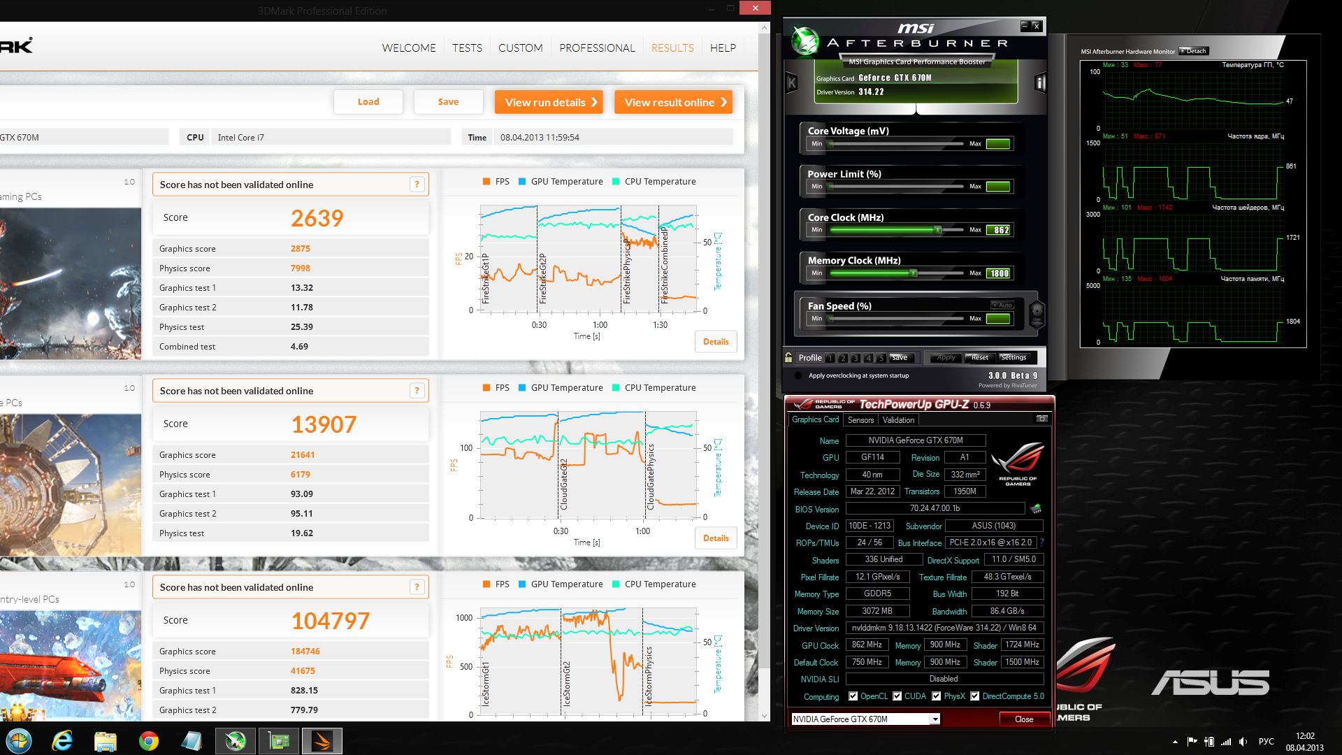

To save post space I'll just edit this post. But finally got it overclocked. Had to powercycle it because the BIOS was still showing the old info after 3 flashes.
Just ran Heaven on high settings and got a 150+- point increase from stock with only about 65C temps. Pretty darn good. This is all on a GTX660m btw.
UPDATE: Another couple of hours of tweaking and I got it down to about 1170 MHz for the GPU and 2550 MHz for the memory. I'm using Heaven Benchmark with High settings, no AA, 1920x1080p
Stock Clocks = 836 Points @ 950 GPU and 2500 Memory @ 64 C
Overclocked = 1002 Points @ 1170 GPU and 2550 Memory @ 70 C
For a laptop overclock that is impressive...gotta say, can't thank you enough for giving me the possibility of this OC :)

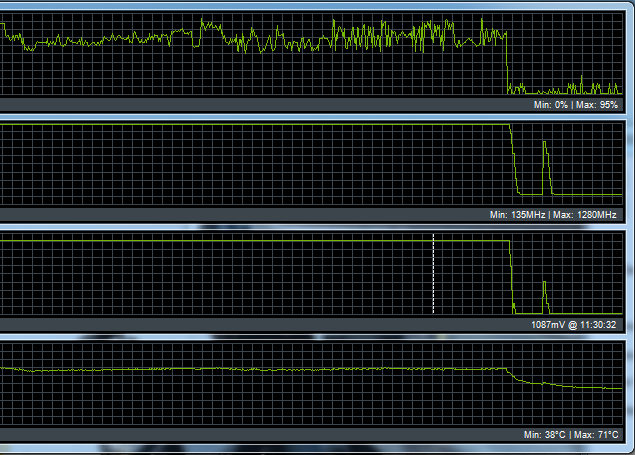

Hello, first i want to thank you svl7 fore your time and your awesome work :) So i flashed my G75 gtx660m v-bios. Before i used nvidia inspector for overclocking and i got gpu 1270-1280 max and mem +500 which get 19400-19500p on 3d mark 06. But only problem was in drivers i was only able to use 306.97 rivers. Thanks to you i can now use latest 320.00 beta drivers, in your bios have no volt mod, so gpu clock stays same 1270-1280 and 500+ mem, and finally i got over 20k on 3dmark 06 with new drivers :D. NVIDIA GeForce GTX 660M video card benchmark result - Intel Core i7-3610QM Processor,ASUSTeK COMPUTER INC. G75VW score: 20124 3DMarks
But i have question fore you, some games like crysis3 give me 30-60 fps with vertical sync on, but my gtx660m is not maxed out it yous only 80% gpu and voltage is only 1087mV, it have to be 1.1mV. I noticed that other games use 1.1mV . And the question is can i some how force my gpu on stage P0 again with your biosmod ?post-7964-14494995076854_thumb.png
