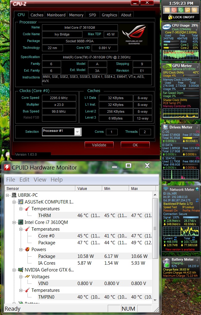

I just have a problem: I have now only 2 cores and even worse, CPUID Hardware monitor and CPU - Z detected only one!
I back with 223 rom backup and the problem was same.
A solution?

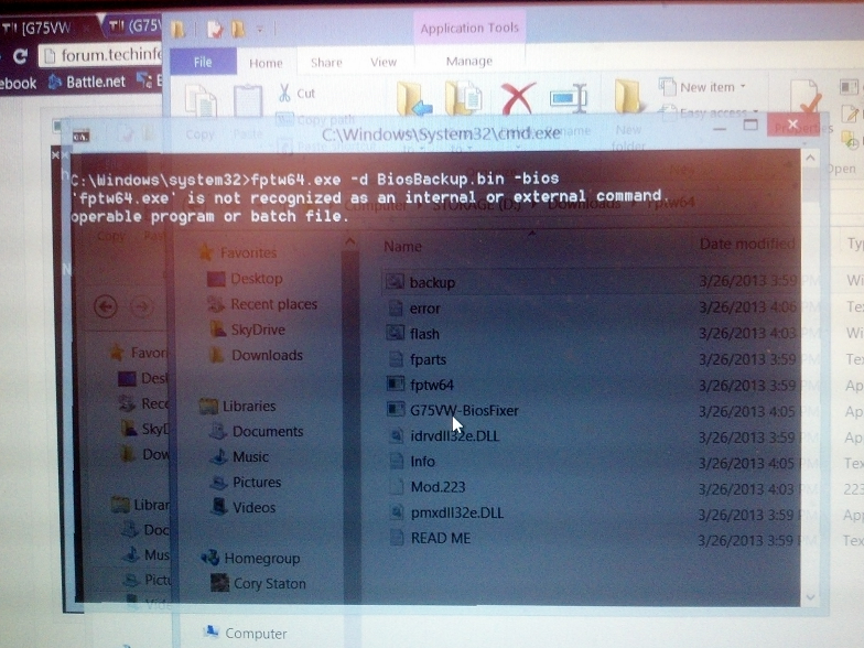

Well I didn't get too far.
The first step is to create a backup of the bios using the backup.bat batch file. I got an error that the file had to be executed as an administrator. Run as the administrator solved the error message but it did not create the required backup.

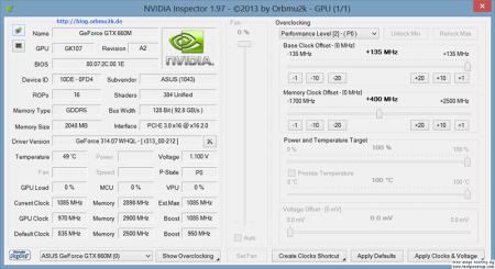

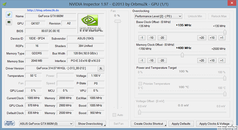

Perhaps I am a little confused. What the intro page seemed to imply was that the base clock is raised to 1000 mhz. This is not the case with my system. Perhaps a picture is worth a thousand words, and nobody wants to read 1000 words! So:
Before: Using 218 bios and 314.07 Nvidia software, Nvidia inspector Pstate 0 with everything maxed out
After: Using 223 Overclock mod bios/vbios and 314.07 Nvidia software and same Nvidia inspector stuff.
As you can clearly see, there is absolutely no change at all. Not a thing. Even the default clock stays at 835 just as before. Luckily it is trivial to still overclock to 1085 with no boost/throttling, but that was the case with the old bios.
I didn't see anything on the first page of this thread about running a command prompt(in the instructions)?
