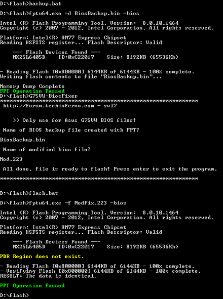

Now I have been able to do all those steps but seems to me that nothing happened... I go to the bios and do not see any unlocked features so whatever. I can tell you that when the bios is installing at the beginning it says 'PDR region dos not exist' and continues to install and just before ir finishes I can see another yellow text appears but the window closes as soon as the installation finished and I can not see what it says.
Anyone have a clue of what is happening ?
PD: I have previously installed the default 223 bios as recommended.

Go to start and in the search bar type cmd. Then run the command prompt as administrator and navigate to folder and repeat the steps. It should look just like Voegelchen's last post...
I finally made it, works like a charm, thnx for the help. I had to flash it twice but finally worked.
