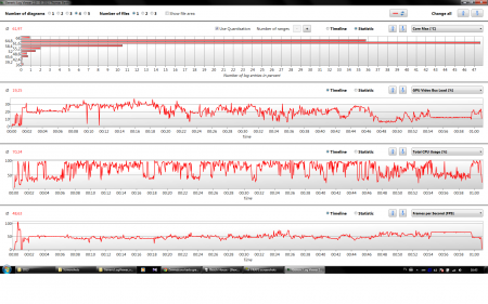

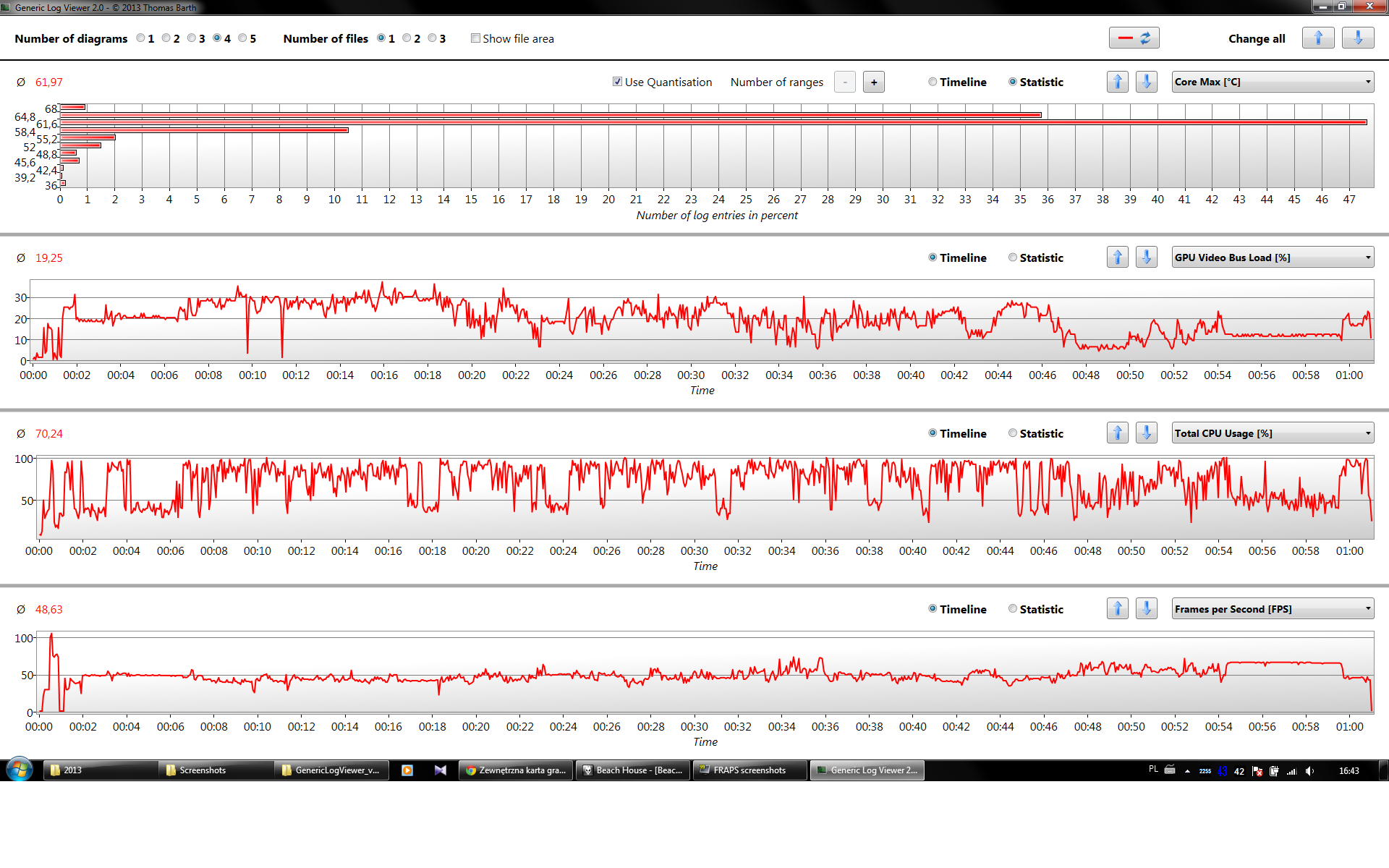

I tested modded and lifted 2570p in FarCry3. Everything on High settings, FullHD. During 50 minutes of play, CPU didn't even reach 70C, most of time there was under 65C on cores, with average 70% of CPU usage. Very goood results.
I assume, with i7-3632QM max temps will be around or even under 80C.
You might see similar results with your 3236QM since you probably will apply some HQ thermal paste. Is this without any extra copper to the heatsink?
I usually use Zalman STG2, but for i7-3632QM I will have to use MX-4 which is still good paste. I run my 2570p with modded heatsink since I created it (after this I didn't add anything):
http://forum.techinferno.com/hp-business-class-notebooks/2537-12-5-hp-elitebook-2570p-owners-lounge-10.html#post64705
Damn dude, I missed your mod, really nice!
How thick copper did you use for this?
I really think you gonna do good with the 3632QM.
Damn dude, I missed your mod, really nice! How thick copper did you use for this? I really think you gonna do good with the 3632QM.
Heh, thanks :) This plates has something about 1,5-2mm in vertical height. Next weekend I plan to add some extra flattened heatpipes, to the bottom side of original heatpipe. On my first attempt I put only this two plates and short additional, flattened heatpipe to the top of original heatpipe. After this I realized there is a space between 2570p heatpipe and mainboard. There is also a small amount of space near end of heatpipe, behind the radiator, Im just wondering if there is a point to add copper in this place, cause I reckon the most important places are the nearest to the CPU.
I believe 3632 will have idle temps under 50C (acceptable for me, but i prefer nearer a 45C ;) ) and max temps under stress (prime95) not higher than 85C (very good) and something around 80C during eGPU playing games (very good) but whether I am able to play FarCry3 on FHD and High settings on i5, is there any point to wasting 3632 potencial If i play games few times per week and Im not ultimate graphics settings entusiast?
I need to consider ;)
Well, if you really want a cool running machine at 3632QM level of performance, - go for a 45W quad and reduce the clocks. When I don't need the full power I simply set the max CPU to 99% in advanced power settings. That way it performs equal to a 3632QM running at full load but the temps never reach 70c. In fact my idle temps are around 35-40c and I almost never hear the fan, like... never, unless running benchmarks or games.
You're right. But if I clockdown 3632 it should be more cool than 45W CPU, shouldn't it?
