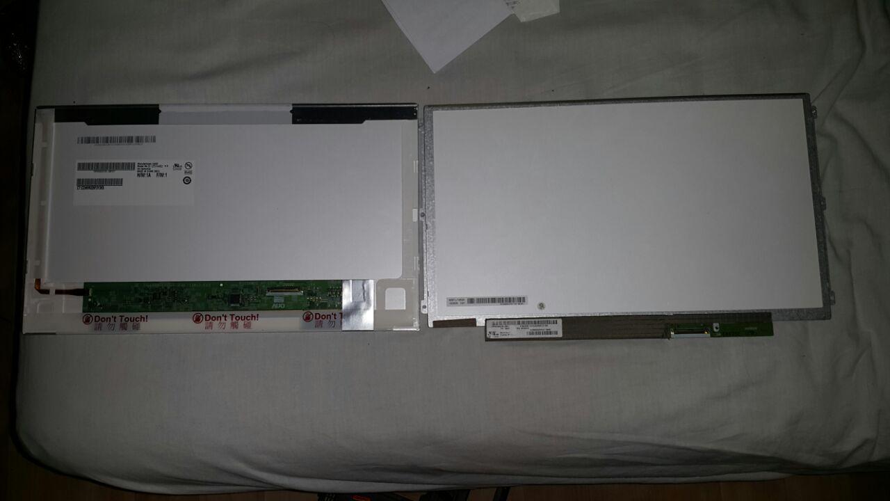

I am planning a build with the 2570p housing.
The first goal is to find a decent Display to replace the LTN.
What would be the absolute best panel which could fit with some modifications?
Thank you!

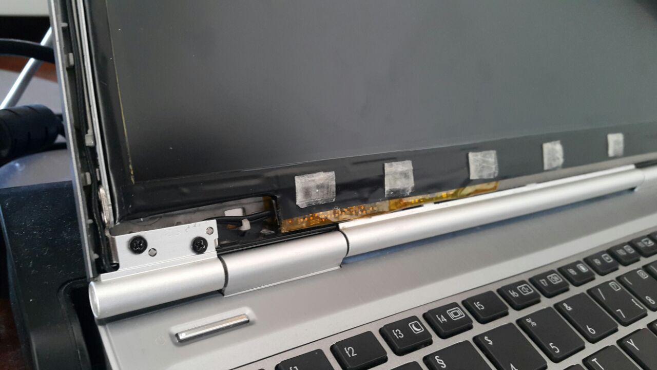

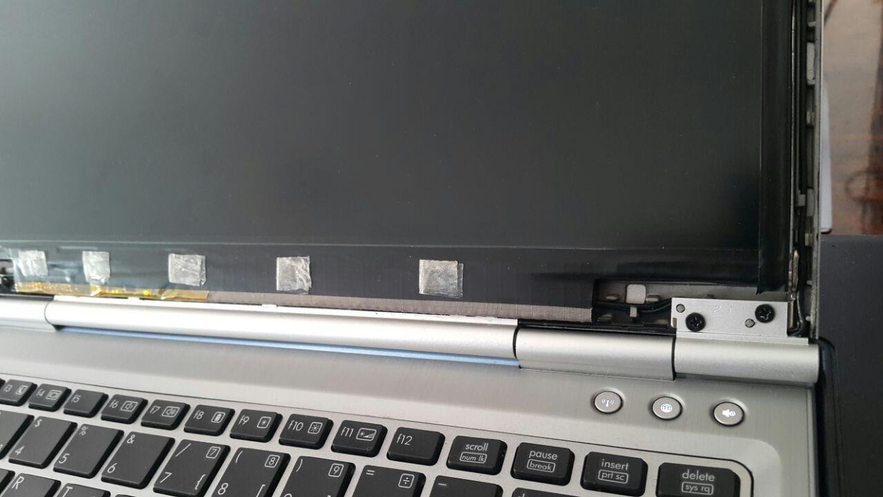

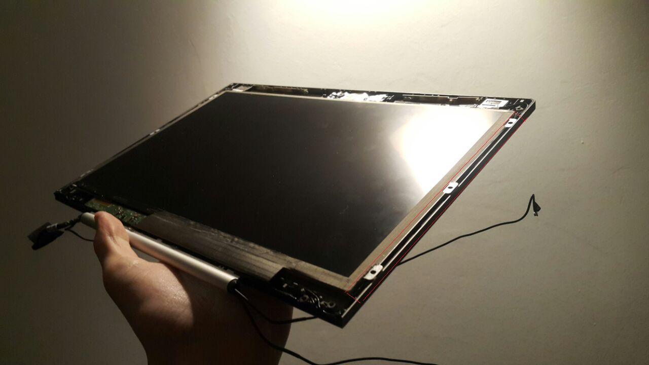

On 2/8/2020 at 2:52 PM, Sonney said:
My 2570p successfully modified with X230's LG IPS Panel
The first thing I did was removing all the magnesium guinding lines for antenna wires and LCD cable compartment screw mounting holes that were on the LCD's way. And because the LCD cable compartment can't be screwed anymore it's held on place with epoxy.
Removing the the panel's screw mounting points was the most risky part, but the metal was soft enough to be cut with long scissors. That required replacing the LCD tape, otherwise screen layers would come off. I used kapton tape covered with electric tape all along the edges.
LCD cable appeared to be flexible enough to reach LCD's connector. The X230's panel is much thinner so there was enough room to do it.
The last thing to do was adapting the LCD bezel to the new screen. Because X230's panel is higher (the location of the circuit board) I had to cut 4 milimeters from the top of the LCD bezel. The different screen height exposed bottom LCD tape, so I replaced it with black tape. I also had to remove LCD bezel's bottom latches, now it's held on place with double-sided tape.
If you've got any questions feel free to ask.
Is this the first IPS 2570p ever?
Incredible job done! A question about the bottom part of the new screen (the black one, in which there is the connector and the logic board): could it have been folded on the back of the screen, while keeping the connector attached, so that the screen wouldn't be higher? or could it have been fixed in a less definitive way than gluing it on the chassis?

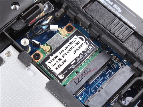

2570p also provides mSATA interface, users can increase their own SSD to improve the overall performance.

2. that second pcie mini card slot which was ment for WWAN card: I don't need WWAN card. Is there any other use for that pcie mini card slot and which?
Bonus question #2: there is some kind of slot for 56k dial up model - is that slot useless except for dial up modem?

2. Patch BIOS, solder signal caps and use it's mSATA capabilities. To use any other usb device you'll also need to remove the whitelist.
Yes, it's only for modem.

About #2: so if I solder signal caps and turn pcie mini card slot into mSATA slot, I can use mSATA SSD in it? If yes, do you know what's the performance of the slot iself (is it SATA, SATAII or SATAIII speed?)
You'll NEED to make a bios patch before msata will be usable because corresponding sata port is disabled by default. It will run at the SATAII speed, and it will not be bootable (and not possible to select as bootable on power on).
