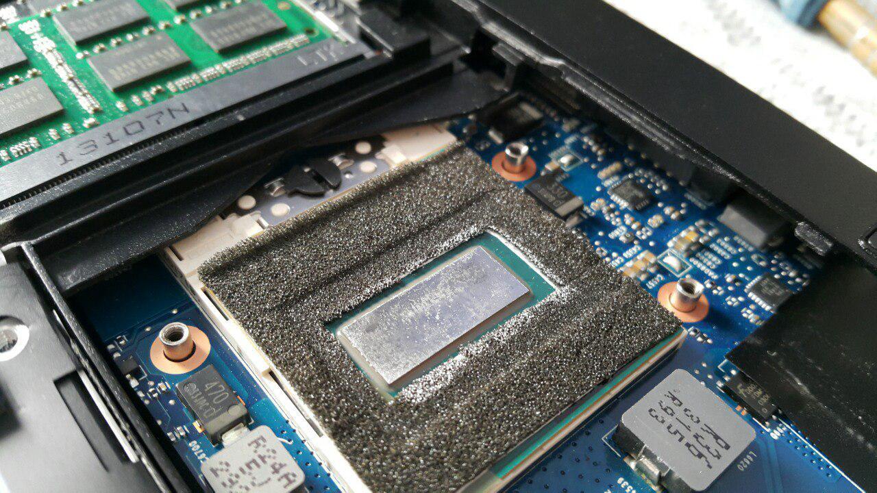

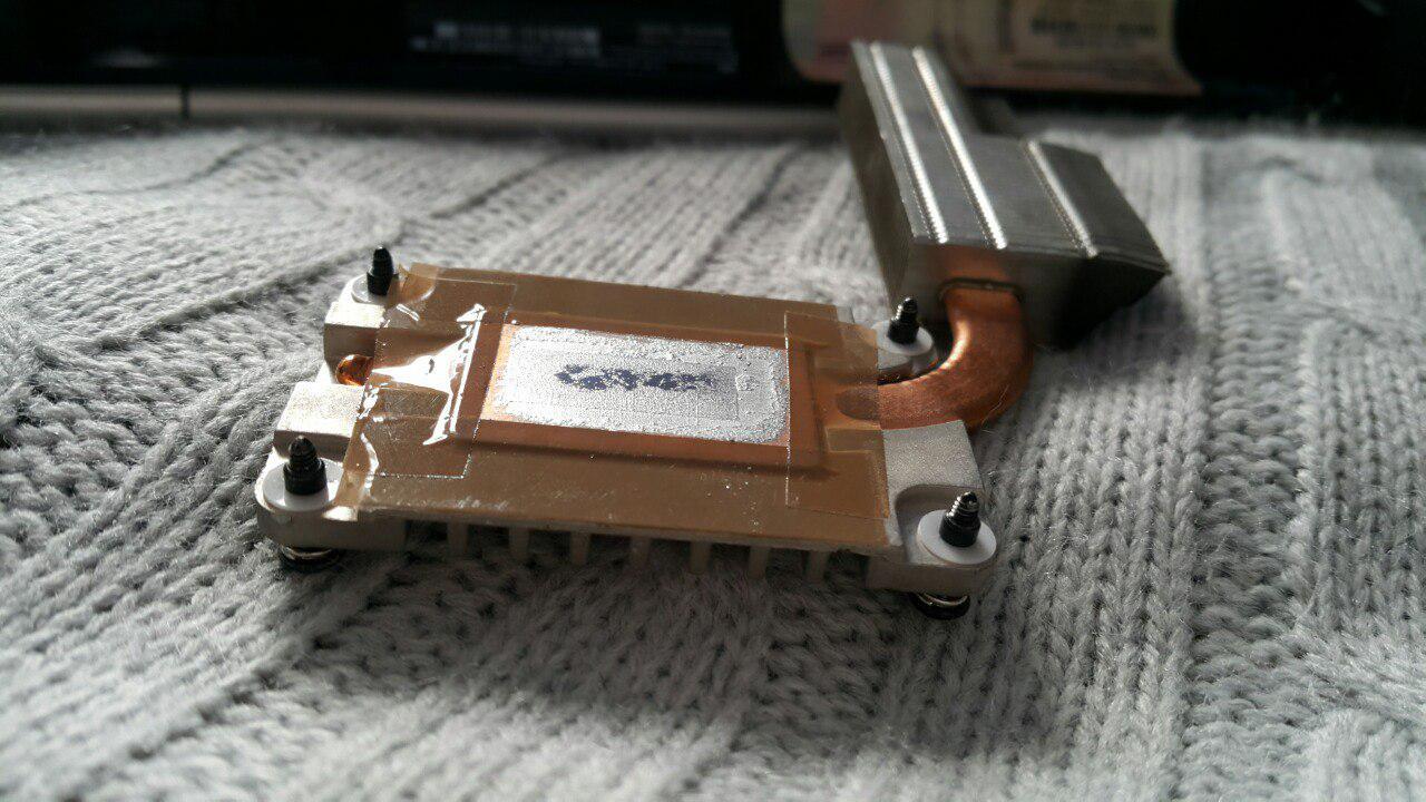

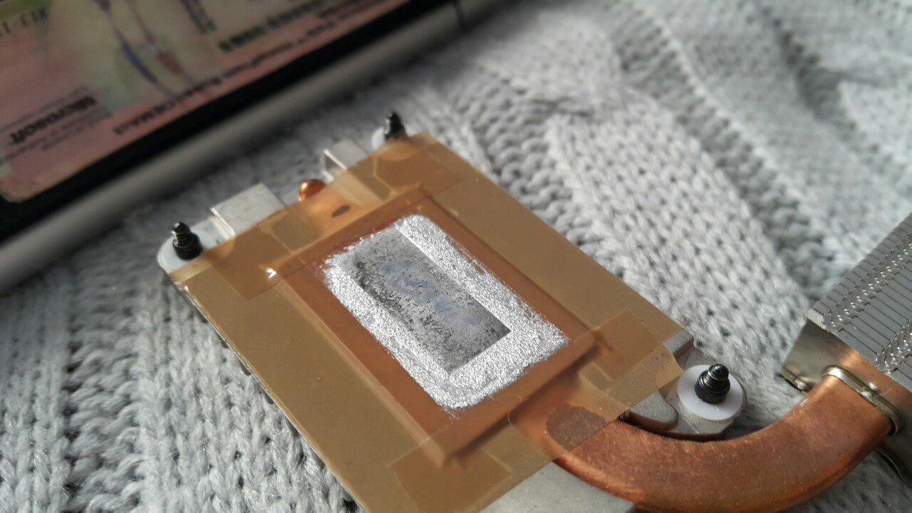

Just decided to swap a stock i3 back since i don't need i7 horsepower at this time, and that's what i'll got from liquid metal installed six months ago. Other than lack of contact, seems like dried alloy formed an increase in the size of the processor die, that means something (die or/and the heatsink) isn't flat. Honestly, i can't recommend to use LM, there was not much boost in the temp stability compared with GD900 even when LM was really liquid ¯\_(ツ)_/¯.

Look for the generic build instruction at the coreboot wiki, it's easy to build (easier than extract the needed firmware parts from HP's bios). Probably i have a backup copy of the coreboot, will look tomorrow, but take a note that acpi implementation there is unfinished and you'll get some troubles in Windows (i'm just switched back to the patched f73).
