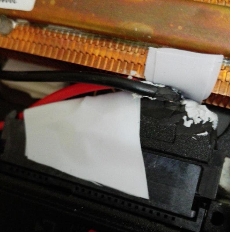

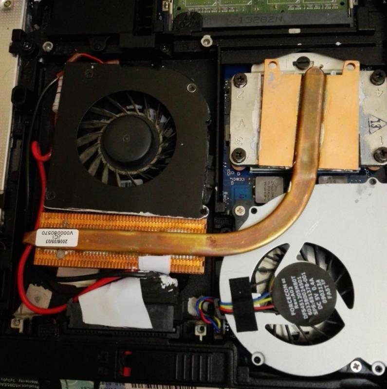

Hello.
Kheh. I buy used EB 2570p and I am crazy happy.
Display not so bad, like I feared.  Socketed CPU is awesome.
But previous owner plugged i5-3380M - is hot stuff!
And I, of course, decided to upgrade the cooling system. (for future cpu upgrade)
I find, in used goods shop, acceptable heatsink and cooler. Heatsink Toshiba satellite A100-192 (if believe to sticker name), cooler acer aspire 3610 F581-CW
The next steps:
1. expel hdd from his home, internal place. Now he will live in dvdrom bay)
2. remove some millimeters of steel (as more - as better) from native heatsink for better thermal contact. And cut off a layer from second heatsink. Second big reason - is very small space between lid and heatsink.
3. glued the second heatsink on thermal glue (for best fixation) and thermal grease in center of origin radiator.
4. Resistor 2W, 33 Ohm(in my case) connected to sata modified power connector and ---> cooler. It danger place, because strongly "upgraded" sata adapter may contact metal (non isolated)  to heatsink and kill them all, if you don’t trim it carefully.
Results: before: from  up to 90 degrees celsius under stresstest, After: temperature lower to 80 maximum value. Not sure about i7 :-)
Two large minuses:
1.  No warm air output from notebook, for this second coolant system. Only air circulation inside case.
2. No much space between lid and heatsink in some contact points. Tight touch. It plus for cooling(of course, lid will be like heatsink) but, if you drop notebook, it may damage cpu and socket/MB.
P.S. sorry for my english.

19 minutes ago, mikmaze said:
sounds pretty interesting dark, how about a few pictures to see how you did it?
I not make photos in process. I can show you more full picture, for good understanding, how to fixed it all. Photos from spoiler  incomplete.

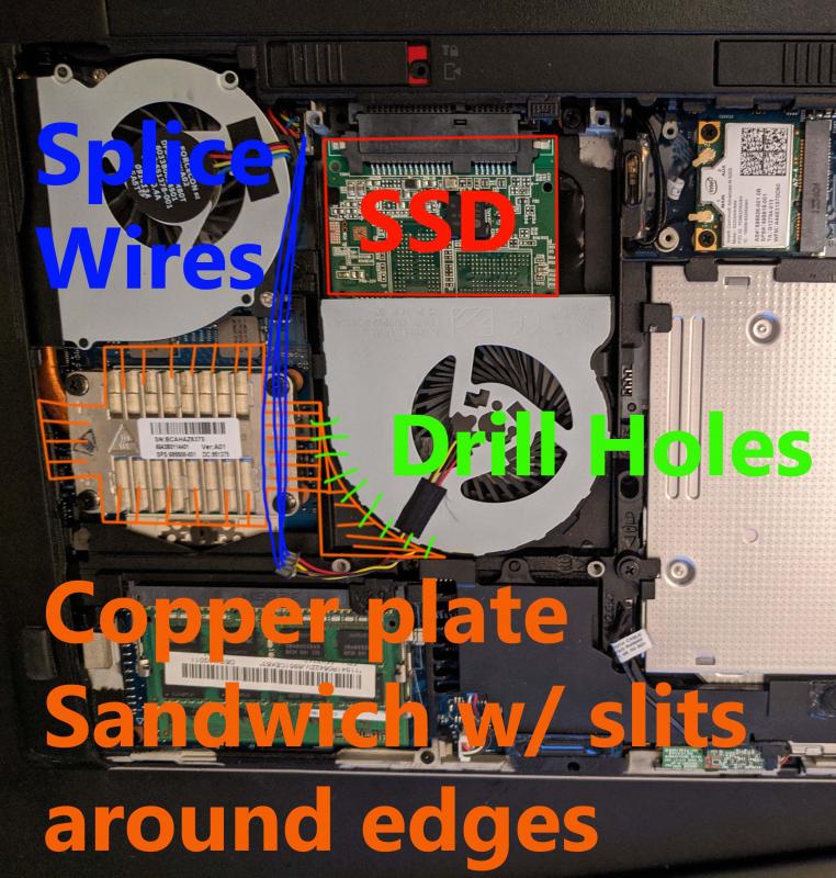

I was reading up on the cooling ideas everyone has come up with, and I was thinking about taking an SSD casing off to where its just the PCB. It gives enough room to fit a whole second fan! I was thinking about getting a copper plate (sandwiched between CPU and stock heatsink), cutting and bending to shape to where there would be some surface area of the copper plate facing the new fan. I took a picture of my idea (So far just an idea, tell me what you think) and it might also require drilling into the new fan case (fan output is pointing directly to SSD)  OR modifying the fan to where its more of a square shape and have the fan output pointing towards the CPU, idk.  maybe also will require cutting into the "hump" between cpu and HD tray.
Edited by bckflpgyg
Added picture might need to host one

18 hours ago, bckflpgyg said:
Hello 2570p owners!
I just got one after owning the 2560p.
Yep it's a nice idea, that room can be utilized.
That copper plate can interface with the original heat pipe, is that what you intended?
You can use thermal glue for OK results or solder it for maximum performance. Soldering however takes skill and consideration (a lot of things that can mess up).
Another thing, how about using heat pipes instead of that copper plate? Pipes are more effective than plain copper, and may even be easier to get. However I am not knowledgeable if the cheap pipes on Aliexpress are good enough.
I instead considering to make some holes with CNC or similar, in order to increase air intake just above the fan (with a slight dust filter eventually). I noticed that without the bottom cover, even with full 100% CPU usage on quads, temps never go over 82 degrees (vs 100ish Celsius with cover). Someone has already tried to improve in this way our notebook?
Main problem is insufficient for the full 35W load heatpipe, not the fan.
I'm not fully agree with you; as I said above, without bottom cover it doesn't exceed 85°C with a 3740qm (which in my case, draw 41W), but that's sure its small heatpipe doesn't help. The best choose would probably be to put a faster/better fan (maybe with a better blade profile?) that fits in its place, and make a hole on the bottom cover just above it.
Yes, drilling holes above the fan will drop a few degrees. I consider this sufficient for mostly throttle-less experience. Okay, if you want it to last decades you may want to keep it yet cooler, but otherwise I find these temps safe enough.
Btw. I got bottomless and never found a (reasonably priced) bottom cover, thanks to all you guys buying spare ones to drill on xD
The pipe is surely not quite up to par, but if you decrease the temps at one end of the heat transfer system (i.e. at fan radiator), that will still lead to similar decrease of temps on the other end (i.e. at the chip). The bigger the temperature difference, the more powerful the heat transfer.
Air at fan will be colder with drilled holes, because it comes directly from outside, rather than from other parts of the laptop as per standard design.
Giving it fresh air would help, but blowing more air into the fan doesn't seem much use. I think it takes quite tight engineering to achieve a turbine-like system of fans, so that the air flow speed at the fins increases noticeably.
In this case MioIV's considerations of the heatpipe being a bottleneck already makes sense. If you want to improve from here, you rather need to widen the heat transfer bandwidth, that is, connect more pipes or a bigger pipe to the cpu.
Edited by batyanko
