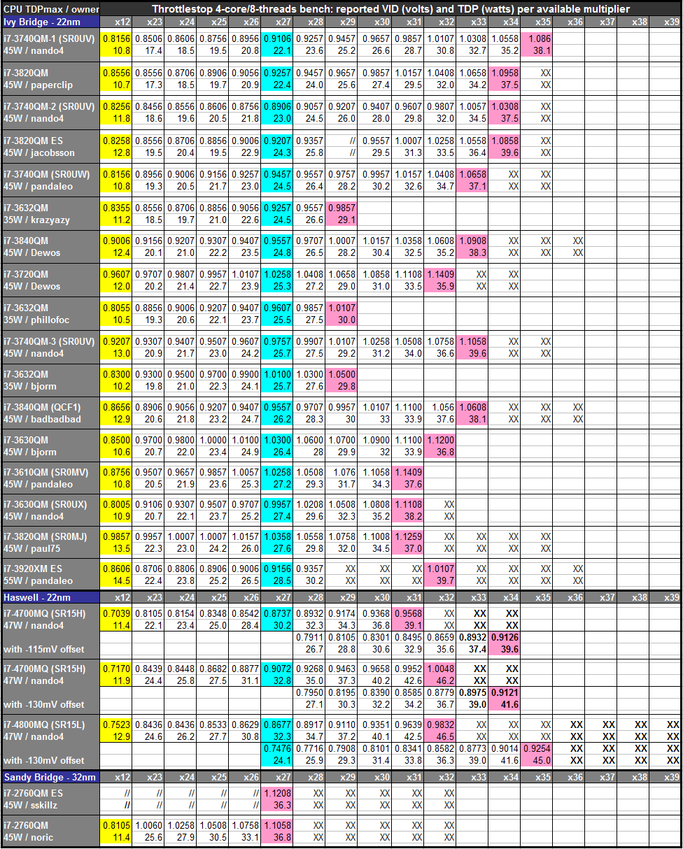

Just read that the i7-37xxQM CPUs are more power efficient than the i7-36xxQM CPUs. How is that? I have an i7-3612QM with a TDP of 35w. The others have a TDP of 45w, correct? If I can pop in an i7-3740QM with lower power usage (and hopefully lower temps), I'd be tempted to do so.
As I recall from reading this thread, the higher end models that reach higher multipliers, and so frequency, can do it because they are the ones that when made and tested resulted drawing less power and heating up less, and so were labelled as those specific models. On the 2570P, since the power the CPU can draw is limited to around 40W, a CPU that uses more, in this case 45W, but is thus limited to 40W will be, for what matter to us, more efficient that other CPUs at the same multiplier it can reach, but still it will use 40W, unless it is limited to a lower multiplier, so that it can consume less at the same frequency of other worse CPUs. Supposedly efficient CPUs are actually the worse, as the fact that they couldn't reach higher frequencies resulted in them be labelled as efficient models, but to do so they have a limited lower max multiplier, and from tests here
it seems that at equal frequencies the higher end models are more efficient.
From my experience with desktops where you can make adjustments to voltage, bus speed, and sometimes multiplier, that's only true if you can undervolt the cpu in question. A lower-binned cpu may or may not be as good as a higher-binned one. Basically, if the production run is of high quality, there's too many "good" processors. They'll test X number at the highest specs, once they get that, the rest are sold as lower end (of course there's more grades than just "high" and "low", but you get the idea).
Anyway, to bring it back to the topic at hand, a (maxed out) cpu running at 2.1GHz and a TDP of 35w would draw less power than a cpu running at 2.7GHz and a TDP of 45w. Now, if you restrict the 2.7GHz cpu to 2.1GHz and 35w, they should be neck and neck. The 2.7GHz cpu might, however, be able to run at 2.1GHz at an even lower voltage. If the motherboard supports it, you'd keep lowering the voltage in tiny increments until it becomes unstable, then up it a notch or two. 2.1GHz at 30w would surely use less power. Also, perhaps you got a gem of a cpu and it'll run at 2.7GHz at 35w.
As far as I know, there's no way to change the voltage and/or multiplier in the bios. Perhaps it's possible to adjust the voltage after the OS has booted (used to have a Windows program that could do that if the chipset supported it, haven't tried it in a while). It'd be interesting to see if you could indeed lower the voltage.

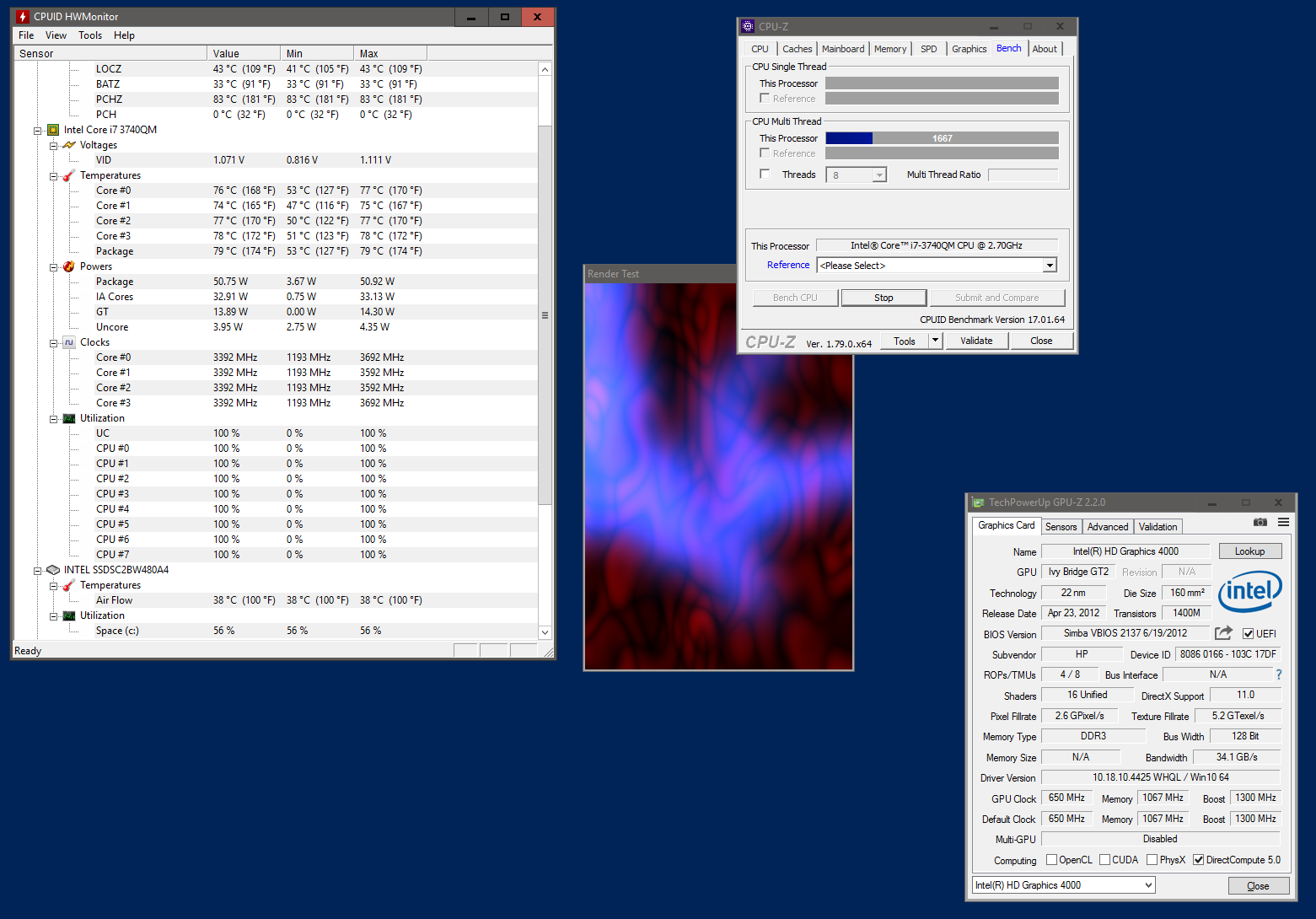

Curious how much hotter the i7-3740QM would run. The i7-3612QM is already running a bit warm. Cores are between 54-61C at low load. Might just need the thermal paste redone, had the motherboard replaced once and it just has whatever the tech put on it.

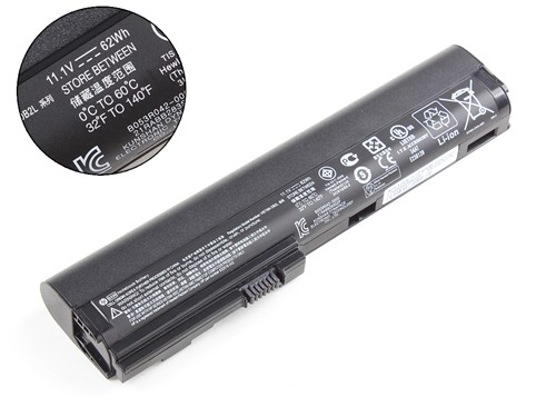

  • battery options include a 31Wh 3-cell, 62Wh 6-cell (9hrs) and 100Wh 9-cell battery (15hrs)

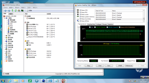

- 2560P is TDP limited to 36W making i7-quad CPUs run at significantly lower-than-specced 4-core turbo frequencies. 2570P is TDP limited to 45W so can run their CPUs near their specced 4-core turbo frequency. REF: http://forum.techinferno.com/hp-busi...html#post79495

x27-TDP: TDP when running at x27 reflecting overall CPU temps and efficiency as discussed

RECOMMENDED reading: How to choose the most efficient 45W i7-quad

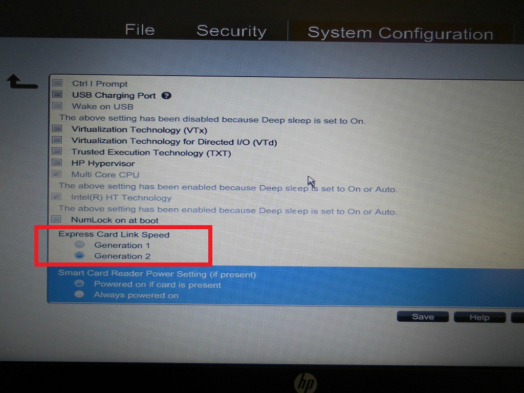

DIY eGPU to attach a desktop videocard via the 2570P's 5Gbps expresscard slot. Provides accelerated gaming graphics, CUDA/OpenCL processing and additional HDMI/DVI outputs to drive multiple monitors.
To do this most users only need to set System configuration->Device configuration expresscard slot from Generation 1 to Generation 2 as shown below:
A NVidia GTX460/560/660/670 is a straight plug-n-play implementation on a 2570P when using Windows 7, though Win8.x is problematic (src: here). Win8.x users may consider doing a UEFI installation instead which resolved error12 and gave hotplug capabilities as noted here.
An AMD card, GTX650, GTX750, GTX9xx or older NVidia cards require a DSDT override and (maybe) DIY eGPU Setup 1.x interposer software to eradicate error 12 that prevents their functionality. See the 2570P DSDT override details if using one of these cards.
Implemented on a 2570P at x1.2Opt speed (5Gbps + compression) using a NVidia GTX670 (jacobsson), GTX660Ti (Tech Inferno Fan), GTX560Ti (bjorm), GTX660 (dewos), GTX560Ti (hatoblue), GTX650Ti (phillofoc)

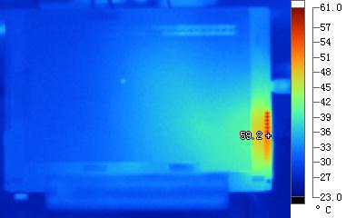

Recommended reading - INFO: Tech Inferno Fan findings on improving 2570P cooling system

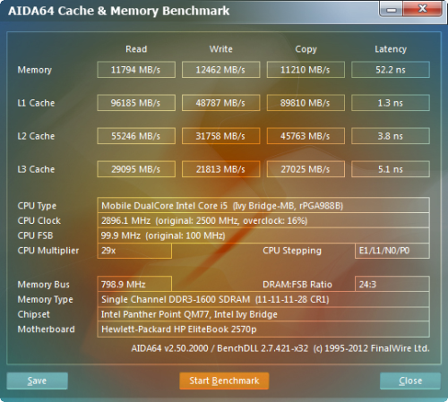

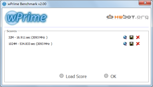

Khenglish's 2570P BCLK overclocking ME FW - allows increasing BCLK by 4.8% using XTU software, eg: i5-3360M 2.8Ghz -> 2.93Ghz

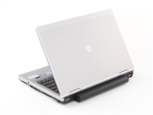

Appearance and interface: magnesium alloy body business interface

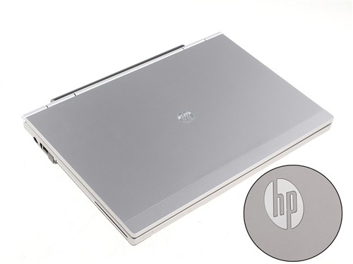

● The appearance and use of materials
High strength material to the positioning the flagship of Commerce this will build the fuselage, the HP EliteBook 2570p body adopts high-strength magnesium alloy, with silver surface grinding process, with strong metal texture and also can effectively prevent fingerprint residue . 2570p whole shape design very low-key, nor around the rounded handle the current popular to abandon fashion elements only for the professional business.
HP 2570p magnesium alloy body with a high degree of robustness
Lithium battery using the HP 2570p randomly equipped the kyphosis design, this is tantamount to increase the width of the fuselage, but large-capacity lithium battery can also bring more endurance.

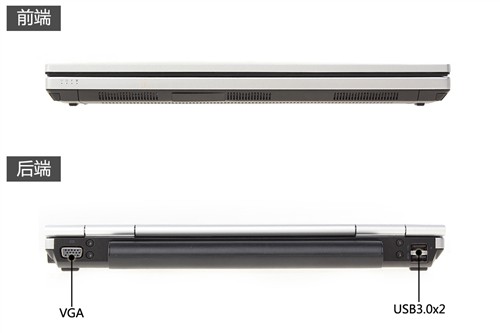

Almighty business this has a very well-equipped business interface design, the HP 2570p fuselage front end does not design any expansion interface, and most of the area of the rear fuselage, while lithium batteries occupy, but the left and right sides of the battery is still VGA, and dual USB3.0 interface.
HP 2570p expansion interface design more concentrated in the fuselage left and right ends of the left side of the fuselage interface follows the power, RJ-45, RJ-11, DVD drive and Smart Card, the right side of the fuselage interface from right left turn for notebook lock the docking connector eSATA/USB2.0, DisplayPort, headphone / microphone, SD card reader and ExpressCard. View 2570p expansion interface is very well equipped, even the old RJ-11 interface has also been retained, two USB3.0 plus a USB2.0 also be able to meet the demand for the use of the most of the time, although 2570p DisplayPort interface , but the lack of a more mainstream HDMI interface looks a little regret.

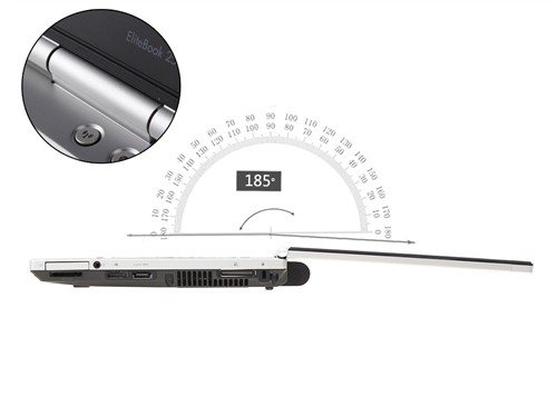

HP EliteBook 2570p with alloy hinge sunken shaft the screen high fastness, 2570p screen the maximum opening angle of more than 180 degrees, which is also an important high-end business logo.

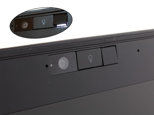

● camera
HP EliteBook 2570p HD Webcam settings on the screen just above the right there with a protective cover keyboard lights when not in use can be turned off the protective cover to prevent dust and moisture from entering.

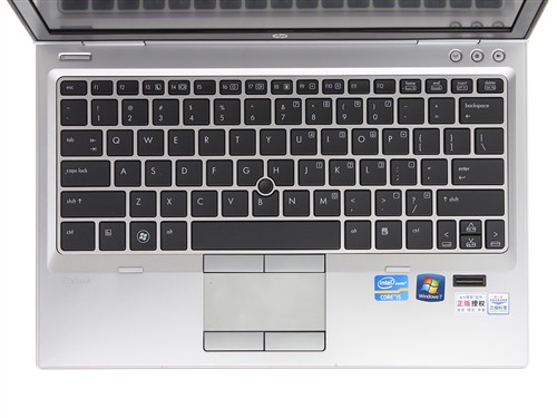

HP 2570p is equipped with a high-touch black chocolate spill-resistant keyboard, the key processes and key spacing design is very reasonable, prolonged beating also be able to maintain a good feeling. Although this keyboard does not have a backlight function, but by means of the camera to the right of the keyboard lights in low light conditions and accurate identification keys. This as the flagship business, let your hands do not leave the area of the keyboard to move the cursor pointing stick natural essential 2570p black the TrackPoint design in the middle of the keyboard position.
2570p touchpad uses the same metal grinding treatment, feel comfortable, precise positioning on the below the the four shortcuts resistance are very small, the key sound is also very light. Up and down two shortcuts used with the TrackPoint, the bottom two and trackpad for use with two combinations, allowing those different habits.
2570p biometric fingerprint reader design in the lower right corner of the C surface

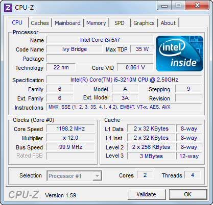

HP 2570p using an Intel architecture IVB i5 3210M processor, using the X86 field is currently the most advanced 22nm process technology, dual-core four threads, 6MB cache, the default clocked at 2.5GHz, Turbo Boost up to 3.1 GHz, TDP 35W.
● Memory
Terms of memory, 2570p using a single 2GB DDR3 1600 high-speed memory, timing 11-11-11-28, read speed 11794MB / s, write speed to 12462MB / s read and write speed or capacity can good deal with day-to-day use demand, can increase a 4GB memory 8GB dual-channel, the whole performance there will be a certain level of improvement.
● wPrime
wPrime is a notebook processor performance testing software, 2570p using the i5 3210M 32M and 1024M test results were 16.911 seconds and 584.833 seconds, leading the older generation i5 2430M approximately 10%.

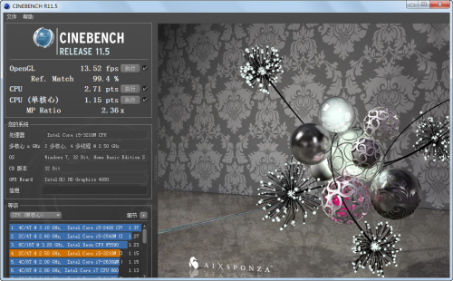

Another common CINEBENCH 11.5 test software, the HP 2570p CPU single core performance 1.15pts, multi-core results 2.71pts previous generation i5 2430M approximately 10% ahead of the same.

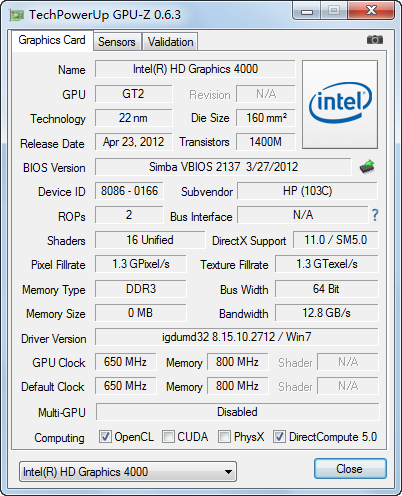

Business notebook graphics capabilities are not very high, HP 2570p CPU integrated Intel HD Graphics 4000 Core graphics card, core frequency of 650MHz, memory frequency is 800MHz, and meet the business office is not a big problem.

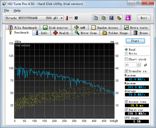

● Hard
HP 2570p with a 500GB 7200 rpm Hitachi mechanical hard drive, this hard drive in HD Tune Pro test a minimum transfer speed of about 45.4MB / S, the maximum transmission speed is about 103.0MB / S, the average transfer speed of approximately 79.0 MB / S, HD Tune graph when the read test is also very stable. The 2570p Similarly with HP 3D DriveGuard hard disk protection technology, the fuselage by the impact of the big efforts to advance locked hard disk to protect data security.

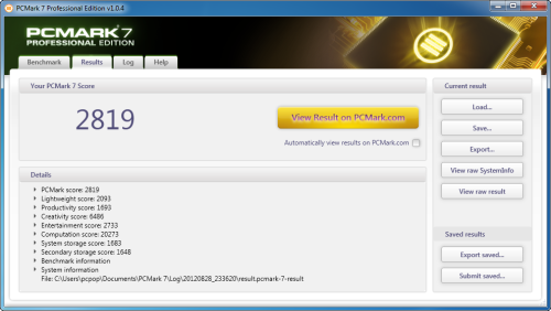

● PCMARK 7
In the the professional machine performance testing software PCMARK7, 2570p total score of 2819 points.
Chapter Summary: HP 2570p using the latest IVB i5 3210M processor, the default 2.5GHz, 3.1GHz high frequency has a very mainstream performance Turbo 4GB DDR3 1600 memory also able to meet the complex business-use environment. 500GB 7200 RPM high-capacity mechanical hard drive with HP 3D DriveGuard hard disk protection technology, the data is very safe.

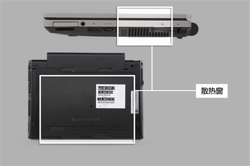

● Heat
HP 2570p using the bottom into the wind, the wind out of the right side of the fuselage cooling mode, use should pay attention to the right hand mouse and the distance of the fuselage, so as not to vent hot air right impact. 2570p Here's the specific thermal performance test.

The temperature of the surface of the conventional standby fuselage C (left) and D surface (right)
To use AIDA64 Let 2570p processor and graphics card to run at full capacity 30 minutes
Full load for 30 minutes after the fuselage C surface temperature
Surface temperature of the full load for 30 minutes after the body D

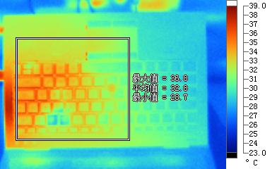

We can see through the professional thermal imager: conventional standby mode (room temperature about 26 degrees) 2570p body C face maximum temperature was 34.4 degrees, the position appears in the upper left corner of the touchpad, the maximum temperature of the D surface outlet was 38.5 degrees, the position appears on the right side of the fuselage, the whole, fairly good 2570p cooling capacity in standby mode; conventional 2570p fuselage C surface temperature of 36.8 degrees after 30 minutes of full load, D surface The maximum temperature of 59.2 degrees C, the highest temperature of the surface D are located near the main outlet the HP 2570p full load cooling capacity is the same impressive.

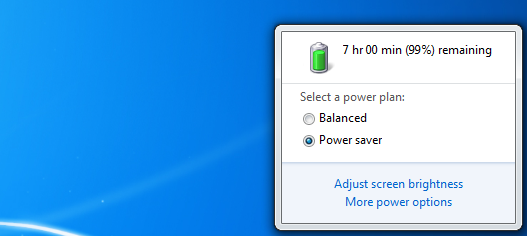

● Endurance Test
HP EliteBook 2570p standard lithium battery capacity 11.1V 62Wh
Screen brightness to 50% and turn on WiFi, then turn on the power-saving mode the last HP 2570p estimated 7 hours battery life under Windows 7.
Evaluation Summary: HP 2570p has a very high degree of sturdy magnesium alloy body, coupled with a biometric fingerprint reader, spill-resistant keyboard 3D DriveGuard hard disk protection technology, the internal body as well as the hard drive information can be effectively protected . The opening angle of over 180 degrees screen, mainstream and complete business interface design, IVB platform performance, excellent hardware configurations make this machine demonstrated a deep skill, backplane tool-free is a big bright spot, users can easily upgrade hardware or screwdriver to clean the dust. This model priced at about 10,500 yuan, the positioning and the ThinkPad T430 is similar, if you do not intend to into the black, then this HP EliteBook 2570p is also a very good choice.
I just want to point out there are two kinds of interface for the HP EliteBook 2570p Battery. please check below image.
Most people have not attention on it.

Possible CPU Upgrade: As far as I have read here, i7 3720m is a good candidate, even if throttling down a bit. Do you think that considering the current relatively high max temps of the 3520m cpu, will worth the upgrade even without any or with only minimal modifications, with no more than maybe a bit of a thermally glued copper plate above heat-sink or maybe using the heatsink of the 2560p model?

Running a 2570p with a i7 3820qm since 2-3 months.
The temperature is NORMAL at 48-55°C on Windows 10 with the core parking feature. Basically the 3820qm  with the core parking, is running as a dual core, until I open a heavy application.
On Windows XP, the temps are INSANE. At least on Windows XP : I am at 60°C with fan at 3200 rpm lowest settings, but the least of application I open like net browsing and it goes up at 75°C.
Previously, with an i7 2620M on XP, I had 74°C with fan off, but above all, 3.5W in idle or internet usage, on the 3820qm I am at 8-9W on idle and internet usage, always on XP. On Windows 10, I run at 3.5W in average.
Now, this is only for simple Internet browsing. When I do slightly more heavy work, for example multitasking, with ALL cores (so same as on Windows 10 or Windows XP), I go up to... 103°C minimum. The CPU throttles. And the fan is on MAX. And it still stays at 103°C.
On the i7 2620m I use to go down to 74°C with max fan and max cores. I estimated the i7 3820qm CPU, without throttling, would reach 130°C with the heatsink.
Conclusion : the heat-sink of 2570p is just to small for a 45W CPU. BUT, VERY IMPORTANT, even with the throttling, I get a clear boost (2x more scores in multi-thread benchmark, about 1.15x in mono-thread, even with throttling fully enabled) in computer speed. BUT, second BUT, the CPU is not on is max possibilities. I need a way to extract the 30-40°C additional heat to have the max possibilities of CPU.
Also, it is, at least for the Ivy Bridge, important to use the latest OS for the core parking, but for work purpose I have to use the old Windows XP.
The only way I found to remove the 30-40°C additionnal heat is to plug a flexible heat pipe under the CPU and stick it to a copper plate under the fan. Here is the link for the flexible heat pipe : https://www.ebay.fr/sch/i.html?LH_PrefLoc=2&_sop=15&_from=R40&_trksid=p2045573.m570.l1313.TR0.TRC0.H0.Xflexible+cpu+heat+pipe.TRS0&_nkw=flexible+cpu+heat+pipe&_sacat=0&_oac=1
I tested also the 2560p heatsink : no real improvements.
Getting 103 degrees sounds way too high even for this kind of processor, and even if you live some place hot...
If we are talking about CPU loads alone: at 100% CPU stressing I hardly get above 90 C with my 3720QM with 8 threads x 3400 MHz, 31 C ambient temerature. It goes to 87 C in about 25 seconds, then starts throttling a bit, maintaining the temperature around those levels. Real internet usage like a 1080@60 YouTube video only reaches about 65 C. Currently using stock 2560p heat sink.
So you might want to check how your Ihtel HD graphics is being clocked/utilized under Windows XP, granted there are tools to measure that. I found out only recently that the Intel HD 4000 graphics can produce remarkable amounts of heat, that is, if you stress it right, or maybe if Windows XP keeps it at 100% clock (1350 MHz or so) for no good reason :))
After running some modern 3D games (something I do very rarely xD) and comparing with other stress tests, I noticed that serious 3D tasks can push temps well over over 90 C in just seconds. It seems that the GPU can utilize the rest of package (CPU+GPU) power consumption up to 45 watts quite quickly; otherwise consumption only reaches around 40 watts if CPU alone is stressed, as others on the forum have already noticed.
BTW I like the idea of a heat pipe leading to an aluminium sheet for cooling. I was considering something like that recently, since I am using a bottom cover made of metal anyway.

I expressively locked GPU at 1247 Mhz because it seems the base frequency of the CPU is related to the base frequency of the GPU. I read this some time ago when the Ivy Brigde has just been released. In the Intel GPU control panel, I set "plugged in" and "on battery" to "maximum performance", and in consequence instead the base frequency of CPU is not anymore 1200 Mhz and 650 Mhz for the GPU, is goes up to 2200 Mhz minimum and 1247.
In low performance, I just tested, the idle temp goes from 74 to 62°C but the max temp is still 103°C. Good to know this tip for idle temp. But I wonder how do you manage 87°C on CPU stress test with 8 threads - 4 cores. This seems way to good. I read you use stock 2560p heatsink, is this all ? I repasted my CPU (with clean CPU surface and everything) many many times but this didn't change anything.
Also I never hit 103°C, it is only in real CPU stress test like Prime95, CPU-Z stress test, or 7z compression, that I reach this temps but it is still very far from the 87°C. Also, I almost never hit my max turbo at 3700 Mhz, my "mean max turbo" is more like 3400 Mhz (measured with HWMonitor) so I lost a lot of performance from the ideal 3820qm (but still 2x more than my previous dual core previous generation 2620m).
I just bench marked, I lose like 10% to 15% of performance from 3700 Mhz to 3400 Mhz full 4-cores 8-threads maxed out.  I recognize also that there are a lot of people that have hard times reaching the max turbo on all platforms but this seems very low, I should stabilise the temps from 103 to 60°C (70°C maximum) on load to have average max turbo at 3700 Mhz, which seems impossible with such small heat-sink, heat-pipe, and radiator.
Dunno, I might well be measuring it wrong... Temperature sensors on the CPUs are supposed to have a few degrees of variance, but silicon lottery / binning should be on your side because you got a more expensive model :))
Otherwise I have a custom bottom cover that leaves quite a big clearance under the cooling, but neither this nor the 2560p heat sink should make as much of a difference, too. If you use proper paste and a stock heat sink, you pretty much have the same thing.
Apart from that I am running Linux Mint, which in my opinion shouldn't matter much either.
Anyway if you find it interesting, you might wanna try and see if you get same results under Linux - you only need a spare 2+GB USB memory stick to boot a live Linux Mint. Just download the latest ISO, then install it on the flash drive with something like YUMI, for example: https://www.pendrivelinux.com/yumi-multiboot-usb-creator/
When you boot into the live Linux Mint desktop, open two terminals (one of the icons visible on the lower left).
In the first terminal enter the following to show live temp stats ("watch -n 1" makes the "sensors" command to refresh every 1 second):
watch -n 1 sensors
And in the second terminal run the following two commands to install and then run "stress" - a small program that stresses your CPU (-c 8 is for 8 threads):
sudo apt install stress
stress -c 8
So you got pretty much the same testing setup that I have :)) I do this live USB routine with most old PCs I refurbish, so I can see if the cooling is working properly.

You might be able to do some overclock if what @istinnstudio mentioned about those BIOS mods is doable, but I guess we got more than enough heat to deal with already xD

For the XTU overclocking: On my tests bios F40 is incompatible with --- the file (date: 2014) named 2570pOC.bin. Intel software does not unlock multipliers. So there must be some kind of bios version per "additional" Intel management. Maybe people that had tried it succesfully can post some version numbers or create one for the latest or the most recommended bios.
For the temps: 30oC ambient temp. -> simple cpu 100% less than 90oC. Stress  with Prime95 or Linx about 90-94 max. CPU i7-3520m 2-core / 4-thread. Tested with arctic mx-4 thermal paste.  x34 on 2 cores all the time.
the stock heat-sink and fan is far too small for cooling better than this unfortunately. So even a 35w cpu will heat up much also.
Okay, for a 3520m I find at my turn the temp very high, do you run with 100% fan ? I had a 2620m, which is the older gen, but same laptop, same TDP (35w) and had 74°C average max with 2c/4t full stress test.
Also, before I had something like 85-90°C just after I pasted the CPU. Then with pure randomness I converted a 1080p video that took like 1h to convert, using the 2c/4t, in ~15°C room, then the temps lowered incredibly low to 74°C, then it stayed about at this maximum average for months. So when you repaste you must burn the CPU to make the thermal paste more efficient.
On Windows to run 100% fan you can use Notebook Fan Control, which is working very good (the 2760p fan profile is the same as 2560p and 2570p)
But for my new case with the 3820qm, this is not enough. I will change the thermal paste brand to see.

To remind some tests
On 21/12/2013 at 7:51 PM, Tech Inferno Fan said:
INFO: How to choose the most efficient 45W i7-quad
Summary: recommend a i7-3720QM or i7-3740QM/i7-3820QM as best value CPU upgrades with at most 9% performance variation between the three. The i7-37xxQM or i7-38xxQM being more power efficient, if battery life is important than the i7-36xxQM CPUs.
@bjorm, I recently tested three i7-3740QM CPUs, all SR0UV spec. Notebookcheck says these have up to x35 4-core mode here. Results below for them. I skipped from x13 to x22, starting at x23 to see the ramp up to the the highest non-turbo freq (x27) of the lowest end 45W i7-quad (i7-3610QM).
Comparing the best (#1) and worst (#3) we find there is quite a difference between them. The more efficient one runs x12 at 0.1051V lower, can run x34 even engaging x35 for some time (2mins with bottom cover off) until presumably thermal limits start seeing it pull back the multiplier. It runs x34 at 0.04V and 3.6W TDP lower than the worst one's x33 multiplier. It's x34 mode using the same power as if the the worst was running at x31.5!! The worse one will not run at x35 let alone x34.
NOTE: Haswell results from a Dell E6440. Ivy Bridge results from a 2570P. Sandy Bridge results from a 2560P.
// = missing data in sample set
XX = specced multiplier unavailable due to TDP throttling or because is an engineering sample (ES)
BOLD = unlocked multiplier
YELLOW = x12 TDP
CYAN = x27 TDP used to gauge comparative efficiency
MAUVE= highest 4-core turbo multiplier used during benchmark
Note: (i) ordered by voltage/TDP at x27 multiplier, lowest to highest
(ii) values reported are the consistent ones observed after initial benchmark start fluctuation
(iii) TDP reported reflective of CPU temperature. Temperature value not being used due to significant individual machine variance, eg: ambient temps, cooling mods and other internal engaged hardware such as HDD, wifi, WWAN, bluetooth.
(iv) Throttlestop can be used to limit the turbo frequency. Eg: Can limit a 45W i7-3630QM to x29 so it runs like a 35W i7-3632QM.

I can confirm WLAN whitelist is still removed in the newest F.66 BIOS from 2017 (using intel 7260ac card)
Also can somebody explain to me why it is implied in first post that CPU power is somehow limited by BIOS?
Every test I do clearly shows same results of i7-3740qm as reported by other tested machines (W530 and T530 for example). I know programs such as hwmonitor doesn't report "full" 45W of power drain during maximum CPU load, but according to all my tests of pre-haslel CPUs this is normal and expected. This changed in Haslel and newer architectures.
Here's the screenshot: bHG6TCa.png
Keep in mind all cores are clocked at 3.4GHz as this is how Turbo mode works. 3.7GHz turbo clock is only available on one core if it's fully loaded. So nothing is limited, even in case of i7-3940xm CPU as long as 90W PSU is connected and there is a working battery present.
After modding cooling system a little bit (enlarged heatpipe with parts of 3mm soldered copper plates, another 3mm copper plate covering entire heatsink from above - mounted with mixed epoxy and mx4 paste - plus additional fan inflow from keyboard + coollaboratory pro paste used on the CPU and notebookfan control used with unlocked highest available fan states). Temperature NEVER goes higher than 93C degrees, no throttling of any kind detected (should occur at ~101C degrees)
Of course temps are even lower when eGPU is used, as iGPU has it's own part in overall TDP.
