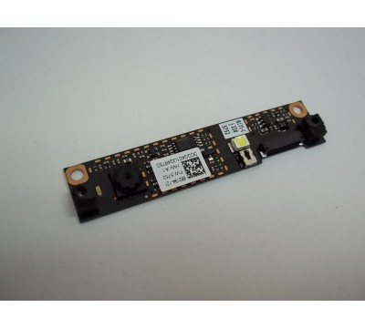

INFO: Retrofitting webcam to non-webcam model
I was reviewing the 2570P Maintenance and Support Guide to figure out how to do this.
It looks like retrofitting a webcam can be done relatively easily:
1. Obtain correct display bezel OR drill a hole in the non-webcam one:
For use on computer models equipped with a webcam 685411-001
For use on computer models not equipped with a webcam 685412-001

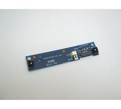

2. Webcam/microphone module 685413-001 (left) in place of the microphone module 694675-001 (right). You can see they are exactly the same size, have the same input cable it's just that one has the additional webcam on it.
3. Use existing webcam/microphone module cable 685417-001 to attach to the webcam.
If you go ahead in purchasing the webcam module 685413-001 and attempt a fit, then please advise if it's as easy as it seems.

Thanks! I'm still out and about so I haven't had time to take a good look. But the bezel has some sort of indent or cover where the webcam is supposed to be.
But if I'm looking at getting a new bezel along with it, perhaps it would be more sound to buy a decent webcam instead?
That's right. I noted in my previous reply that you'd need to drill a hole in your non-webcam bezel to give a view out for the retrofitted webcam module OR obtain the bezel designed for the webcam model. Both part numbers are listed in that reply.
If you wanted a webcam that's better than the 720P supplied in the 2570P, then could certain get one as an external USB device. Not as convenient.
Could a better internal webcam be fitted? The issue will be in getting a module with microphone and webcam with the right pinout and size to fit in the bezel. I found that ZBooks use a 720P webcam too so no chance of cross upgrading there. HP probably figure 720p is enough for skype. Interesting to note that the three generations older Elitebook 2530P had a 2MP webcam but the module is way different. A HP CQ42 has a 1.3MP webcam module and it looks more like a 2570P one.

About the 1.3MP webcam part, I'll look into that a bit more with the connectors, unless it's a standard plug and play. Will make my order by the weekend and get back to you if it turns out successful or otherwise.

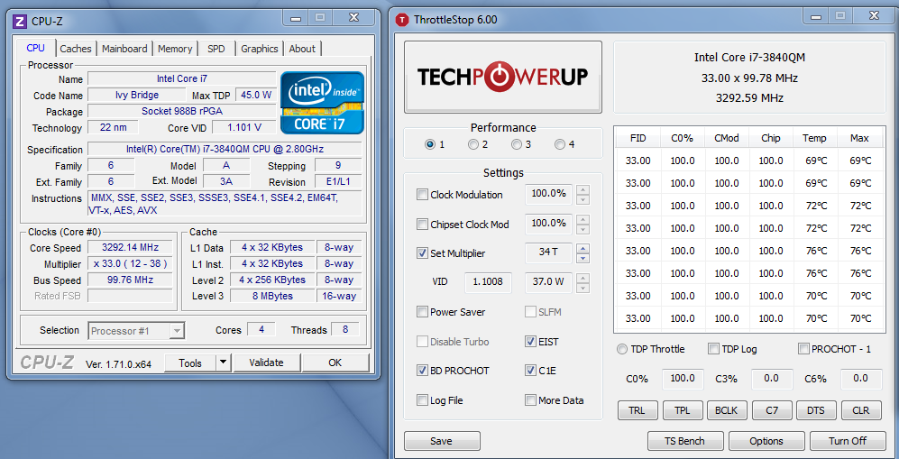

Pretty much stuck at how to access those variables to be able to make some TDP adjustments. Maybe the the author of the Universal IFR extractor can have a look at the above bin file and lend a hand? donovan6000's Blog: Universal IFR Extractor
It's pretty common for bios manufacturers to use a generic string package that's made to cover a large range of bios settings. This makes it so they don't have to spend time rewriting a new string package for every bios they release, and this results in a lot of unused strings. The same thing happened in my bios where I saw some strings related to overclocking, however no options exists in the IFR for them. There could still be variables in the nvram that correspond to the non-existing options, but we can't accuratley manipulate them since we don't know their offsets in the nvram or the values that relate to the different states of the option.
Oh well, so we are stuck for good. Thanks @donovan6000 for the kind reply :)
