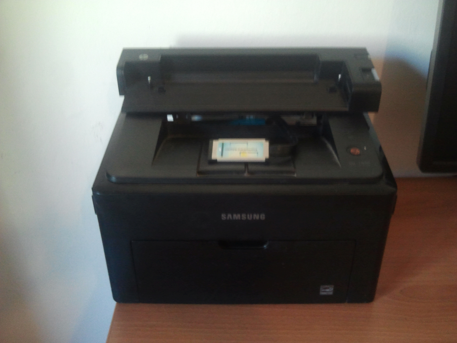

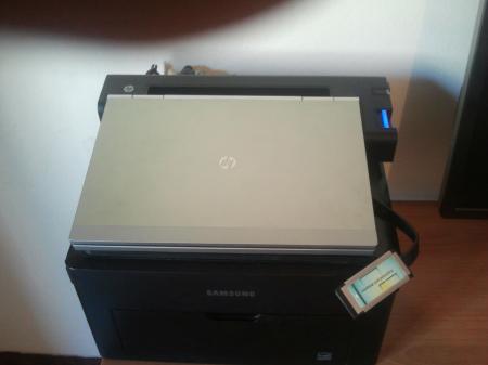

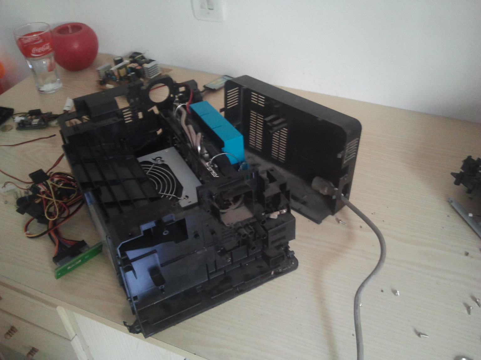

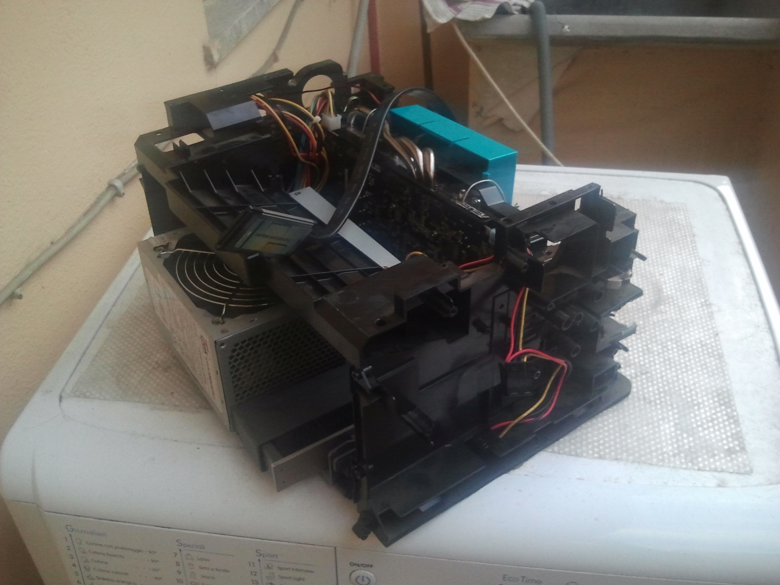

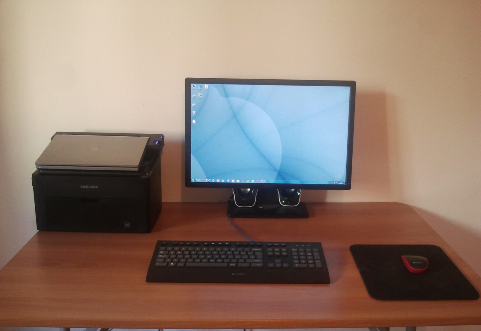

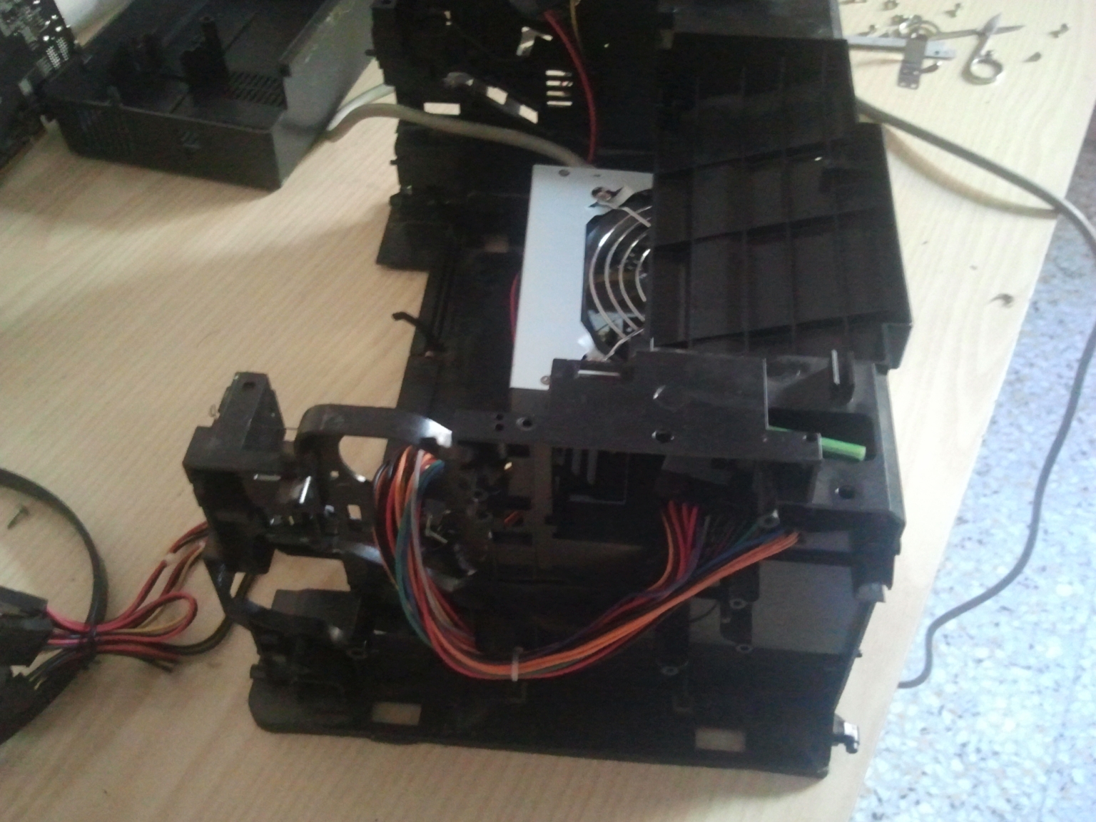

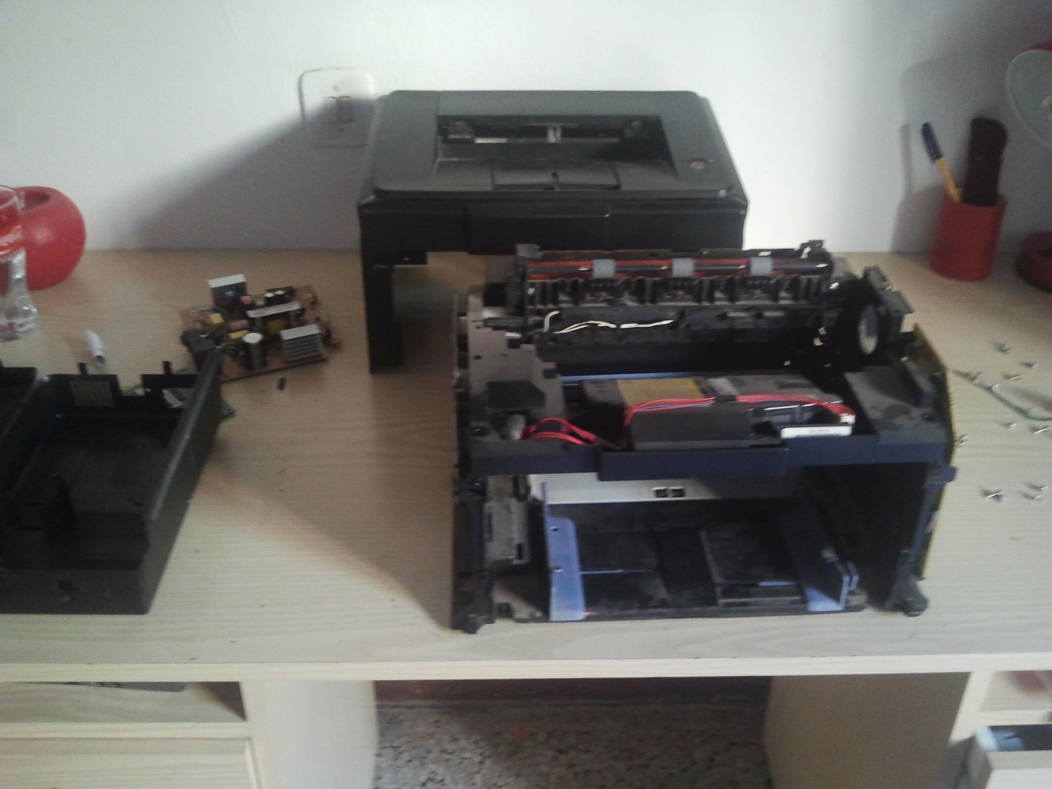

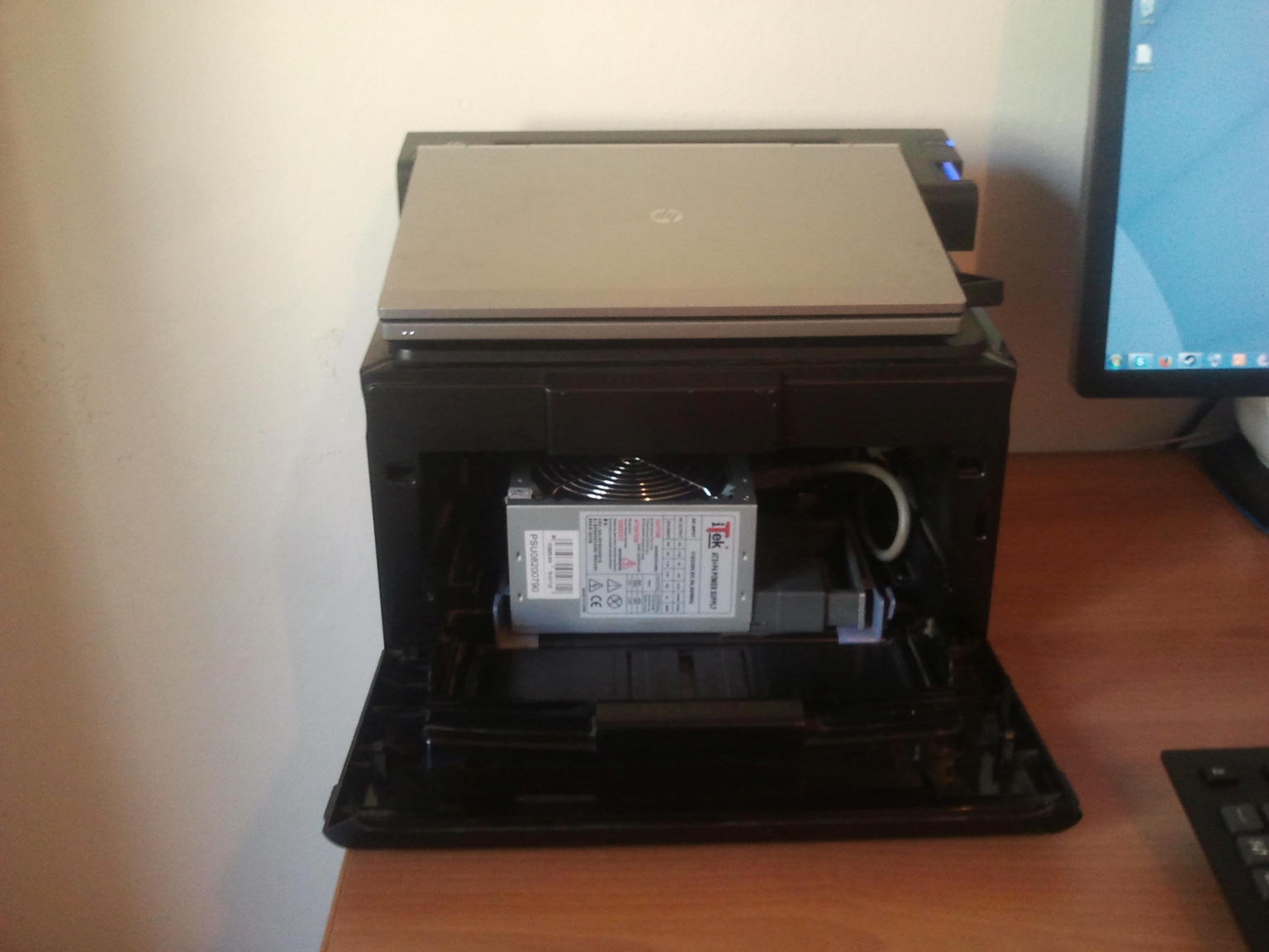

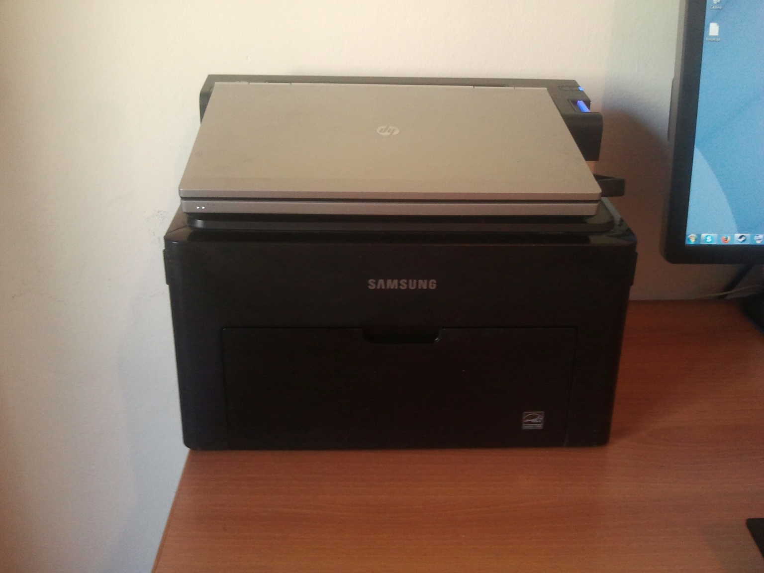

Here is my little creative DIY case project: http://forum.techinferno.com/diy-e-gpu-projects/2109-diy-egpu-experiences-%5Bversion-2-0%5D-post104801.html#post104801
So here my final setup:
Laptop Mode (for mobile):
Hp 2570p with:
- OS Win 7 Pro x64 (Win 8.1 Pro x64 in future)
- CPU i5-3320m 2.6Ghz (i7-3820qm 2.7Ghz in future)
- HD1 128GB+128GB RAID0 Samsung 830 Pro SSDs
- RAM 16GB DDR3 1600 CL9
Desktop Mode (for working):
HP 2570p Dock Station with:
- POWER 90W Adapter
- DISPLAYPORT Dell U2412m IPS 1920x1200px
- USB-HD2 Western digital 1TB
- USB Keyboard Logitech Comfort K290
- USB Wireless Mouse Logitech T400
- USB Tv Digital Receiver\Recorder Cinergy
- AUDIO Speakers (Usb powered)
Power Mode (for gaming):
DIY eGpu Clousure with:
- GPU PE4L 2.1b Geforce GTX660 (with fans disabled)
- DVI Dell U2412m IPS 1920x1200px
- FAN Silent big Fan to graphic card
- PSU 500W Silent (fanless in future)
- USB on PE4L (nothing for now... maybe an SD card reader embedded in the case?)

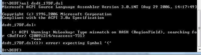

folowing this when compiling i end up with error down here. I'm using older iasl compiler downloaded from some other dsdt editing guide.
If I download newest, "iasl -g" command gives me error " -g is deprecated, use acpidump instead", any idea?

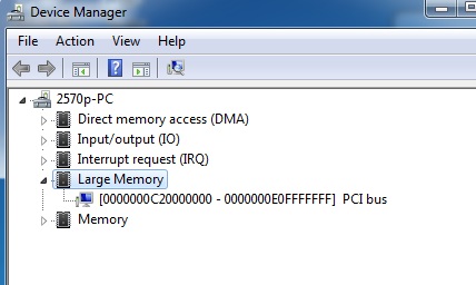

EDIT2: After using different files from different guides i finaly managed to get "Large memory" in device manager
EDIT3: Code 43 on AMD 7770M in device manager. Am i missing something here?

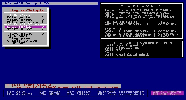

So what i do is: enter menu based setup, plug in egpu, hit f5, set endpoint to 56.25gb, do compaction on "egpu igpu", force 32bit "none" and then go to chainload !test run and boot into windows. Am i doing something wrong?
Looks like you've done the DSDT override correctly and allocated the eGPU to 56.25GB space correctly. One other note, if you have the expresscard set to Gen2 in the bios then there is no need for the 'call iport gen2 2' call in your startup.bat
Now AMD cards are a bit fussy. I recall seeing the error 43 as well. Two things to try:
1. Instead of hotplugging, enable the PCI Reset Delay on your eGPU adapter. If you have an EXP GDC V6 it's a tiny switch on the left that you flick into the left position. If have other adapters (PE4C or PE4L) the look at the board for details of what the switch is. Once enabled, you turn on the eGPU just before the notebook. If the delay works, then you'll be able to boot the system to Setup 1.30, and either see the eGPU already or hit F5 and wait for it to appear. Then do a startup.bat>Test run followed by Chainloader->Test run. If it doesn't work, then the system will hang upon seeing the eGPU during BIOS initialization and so recheck your PCI reset delay switch settings.
2. If (1) gives no relief then try this. I've seen some eGPUs that either require I/O enabled or some that don't like it. So in your startup.bat, after the 'call pci' line and before the 'call chainload' line, add one of the follow three sections, one at a time and test then using startup.bat->Test run followed by Chainloader->Test Run.

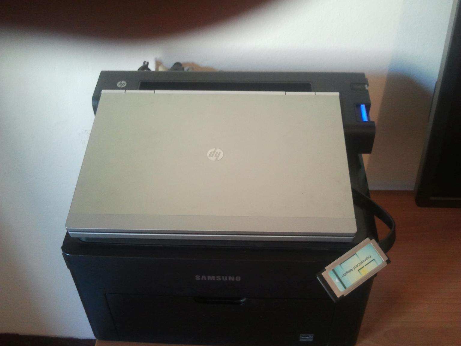

Only microswitching was needed. Pics will come later one, together with 3d mark 06/v/11/heaven scores - i also remembered i didint test my i5 with throttlestop bench. So fire away any tests you want me to do.
Here is photo gallery of my first eGPU setup. - some extra pictures to compare sizes between 12.5" and 17.3" behemoth. On pictures difference is not that big, but once you pick em up its massive.
Here are topics i started on pcekspert.com and bug.hr - two Croatian forums where i'm active. I started two topics since this is an incredible way to "breathe in" new life into old notebooks or have portability and good 3d performance while at home while on a budget. My next steps will be to try and get eGPU working on my gf-s Elitebook 8530p and old HP 6720s.
So what was used to run 2570p + AMD 7770
Hardware:
2570p + EXP GDC v6 EC + Dell da2 d220p + MSI AMD 7770 @ pcie x1 gen2
Software:
DSDT Override
DIY eGPU Setup 1.3 for: PCI compaction - 56.25gb endpoint + compaction on iGPU eGPU
Once DSDT Override was done all left to do was plug in eGPU setup - flip the damn switch since i lost around 6-7 hours tryin to make hotplug work - do compaction with Setup 1.x - boot to windows, install drivers and profit!
EDIT: Special thanks to Tech Inferno Fan!
EDIT2: gpuz + device manager ss added - where it shows it works at x1 gen2
