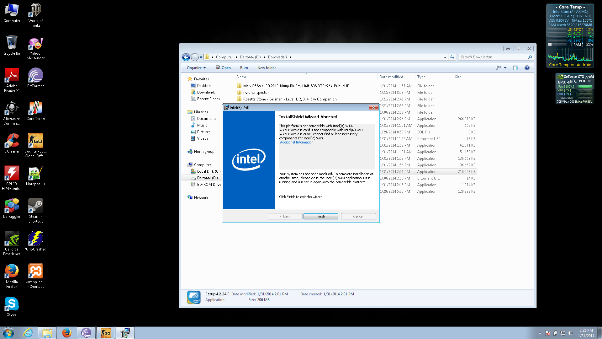

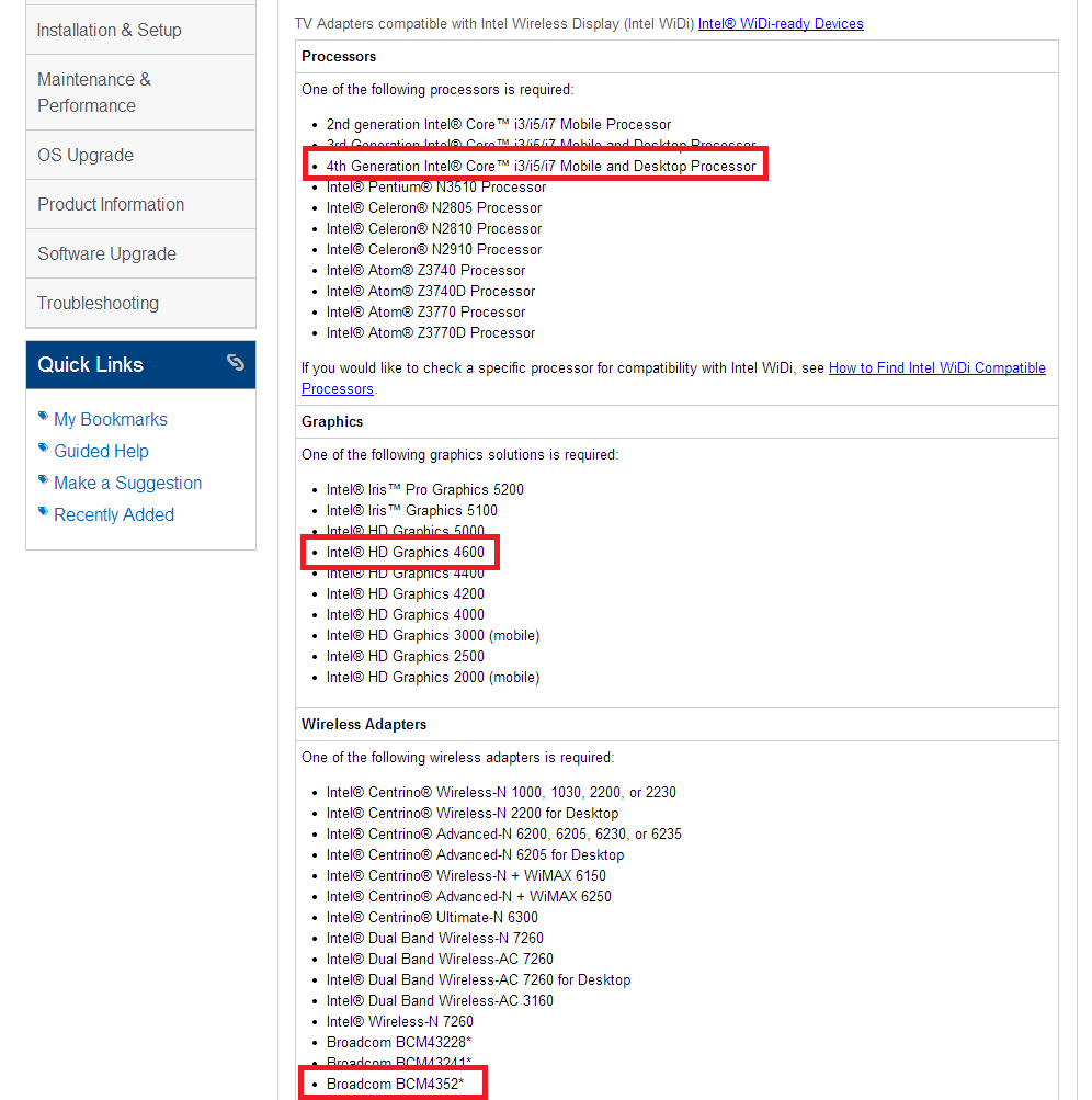

@Tech Inferno Fan, according to the official Intel website, the BCM4352 should be a compatible WiDi adapter even though it is not made by Intel.
Others have posted screenshots complaining of the same problem.
After much speculation, I have come across the WiDi solution. WiDi apparently needs Windows 8.1 Broadcom drivers to work.
Can someone with Windows 8.1 and a BCM4352 confirm if WiDi drivers install? Or can I simply install the Windows 8.1 WiFi drivers over Windows 7 and install WiDi from there?
UPDATE: Can't get WiFi W8.1 adapters to install on W7

Good find with the BCM4352 WIDI support. Please keep us posted of your findings.
