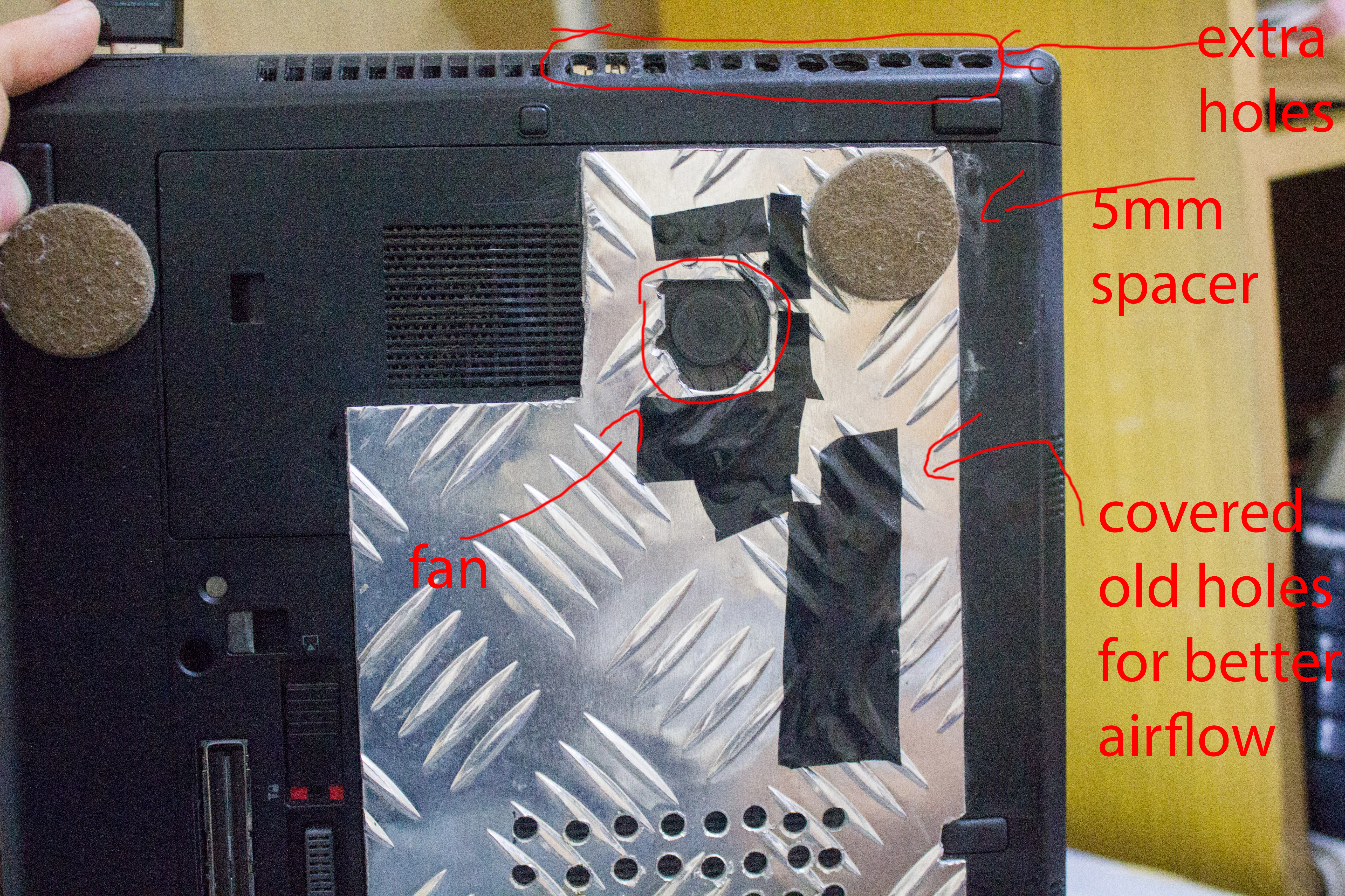

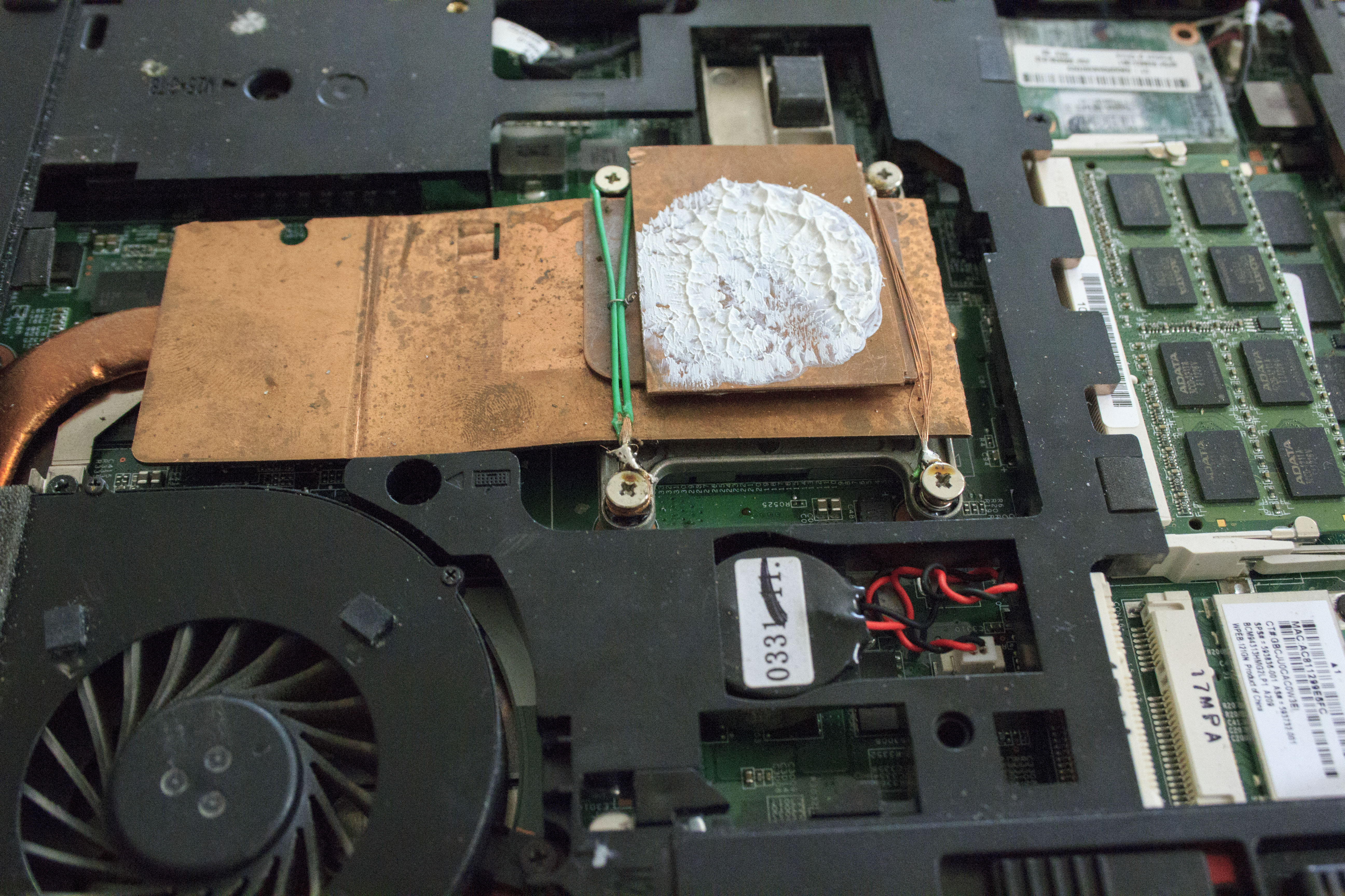

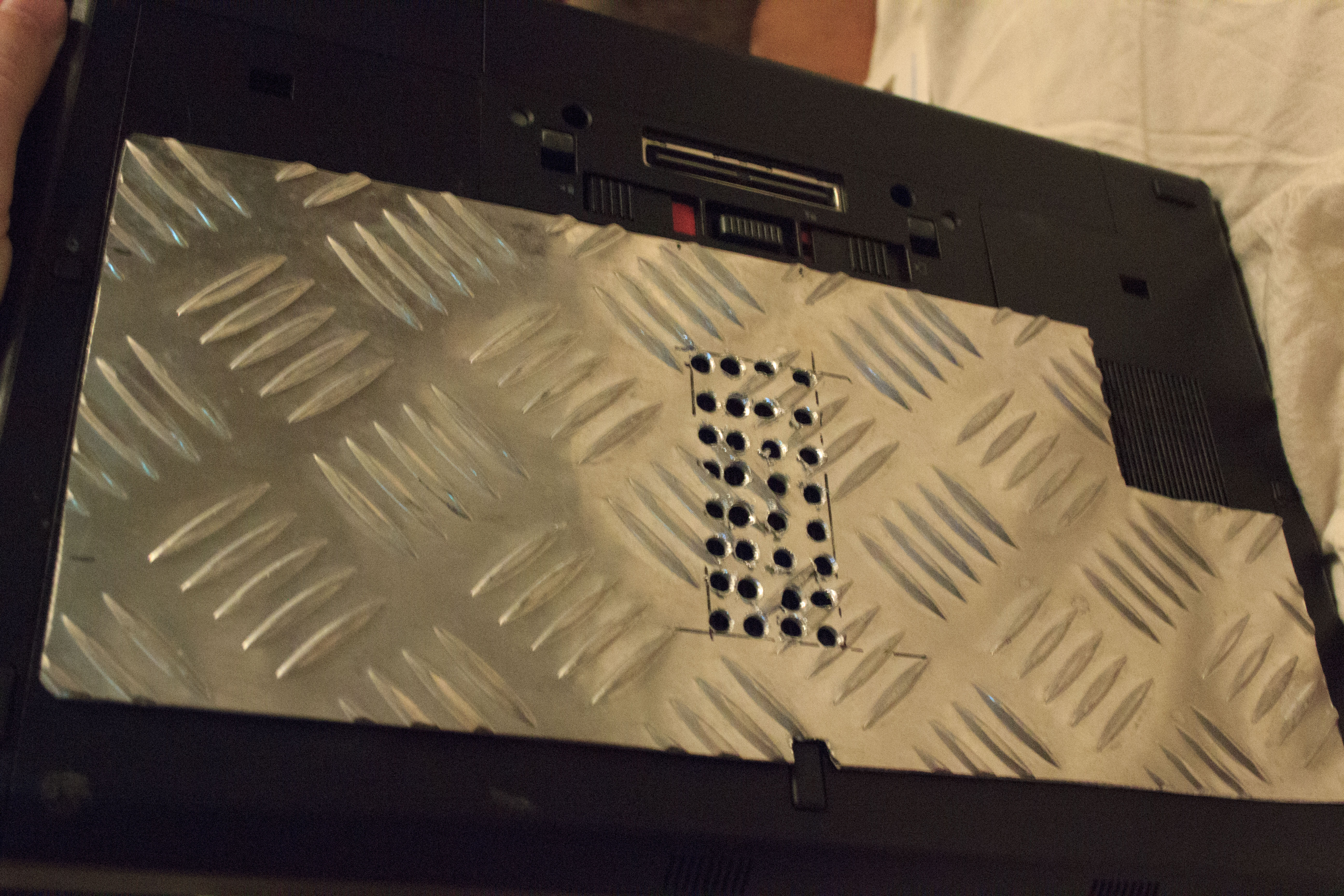

Hi, I would like to ask some advices, I do not have a 2570p, but a 8570p, in a former Probook 6560b chassis. As I like to tweak it, too, I did not find any other thread regarding it, so I will post here, as I think they are very similar in some ways. Please excuse me if this is not a good place to post, and do let me know.
Now, about it. First it was a Probook 6560b, with i5 dual core. I upgraded to 2720QM, to find very big temps, over 90 degrees till 100 in prime, at 3,4GHz, no throttling at all. After discussion to HP support ( I believe by now you have an idea of their kind of way regarding these issues) I began to search for better cooling, mainly adding copper plates over heatsink, cutting a hole in the back cover and adding a big aluminum plate at the bottom. I will show the photos from it's original state.
Now, only the chasis remained from original computer, the mainboard is a Elitebook 8570p, ODD, eGPU expresscard, 3632qm with added holes in the case and an extra 6 cm thick cooler powered by 5V from the regular fan, and the processor limited to 2,6GHz with Thottlestop, because of the fan noise. I saw somebody did a tweak on the fan, by adding some diodes; is this for the noise, or did I misunderstood, and if so, could you explain more details to me?
Also, now I have a Elitebook 8570w backlit keyboard, that fits as size, and as the connectors position to the mainboard. For the illumination I saw hot to power it from 3,5V with an on off swich; however, the contact of the keyboard do not match, and therefore, the keys are wrong, only few work when pressed, and are not what they sould be, and shift or control seems to be always pressed; can anyone help me with this, is there a way, if I could change the order of some pins, to make it work? If so, how can it be done, how to know the correct layout?
I am attaching the old cooling mod pictures, and please again excuse me if I posted on a wrong place
Thank you

2720QM = 45W Sandy Bridge 2nd generation
3632qm = 35W Ivy Bridge 3rd generation
Your cooling mods are not necessary to run the 3632QM. You can see the significant TDP difference between the two at http://forum.techinferno.com/throttlestop-realtemp-discussion/6958-haswell-step-backwards-ivy-bridge-i-have-some-shocking-tdp-results.html#post95181 . If you decided to run a 45W Ivy Bridge CPU you would probably see TDP throttling before temperature throttling. The 8570P/6560B hybrid you have has a decent heatpipe on it to be able to remove heat.
2570P fan diode mod was to decrease cut-in RPMs and so quieten the fan.
Thank you for reply. It was actually 2760QM, I mistook it. The reason why I bought the new one was just this, the 32W TDP. To be more specific, I added 2 pictures, both taken now. One shows the current state of the cooling system, the other the temps after one hour of prime95. They get as far as 90 degrees, with Package Power Limits set to 26W, and multiplier set to 26T, therefore clocking to maximum 2,4GHz, from it's possible 2,9. I would add I took the temps with an external thermometer directly to the heatpipe and it was showing 55 degrees Celsius, while internal sensor was showing about 80. And one more thing: neither the probook mb, this one, and neither one of the two processors ever throttled, even with stock cooling and prime on. Someone suggested the internal reading could be wrong, but I had 2 different processors and mainboards, and all showed similar results. I would like of course, to use it for prolongued at full 2,9 speed, but these temps at only 2,4 kind of worries me, that is why I ask your opinion about it, why do you think the temps are shown so high.
And the second question would be about the new backlit keyboard, if anyone can help me adapt it.
